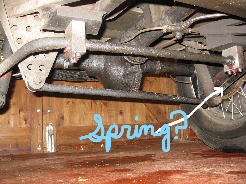

    My avatar car has leaf springs all round and has Panhard bars on the front and rear. I fitted these over over 30 years ago. They really sharpened up the cornering. Here's the one on the rear.
    I'm more about driving it than polishing it as you can see from all the cr*p on the underside of my car:rolleyes:

  21. Ebbsspeed
    Joined: Nov 11, 2005
    Posts: 6,257
    Ebbsspeed
    Quarter-elliptical springs? I only see one thing that looks like a spring. Is this one of them?
    HOTRODPRIMER likes this.

    Most parallel leaf systems are semi-elliptical (the shape of the spring). Are you sure you have semi-elliptical on your 34? Or did you mean transverse?

  29. Bandit Billy
    Joined: Sep 16, 2014
    Posts: 12,373
    Bandit Billy
    Sorry B4U, wrong term, typed that on my way out the door for a dentist appt.
    Meant quarter elliptical. And of course the afore mentioned panhard rod
