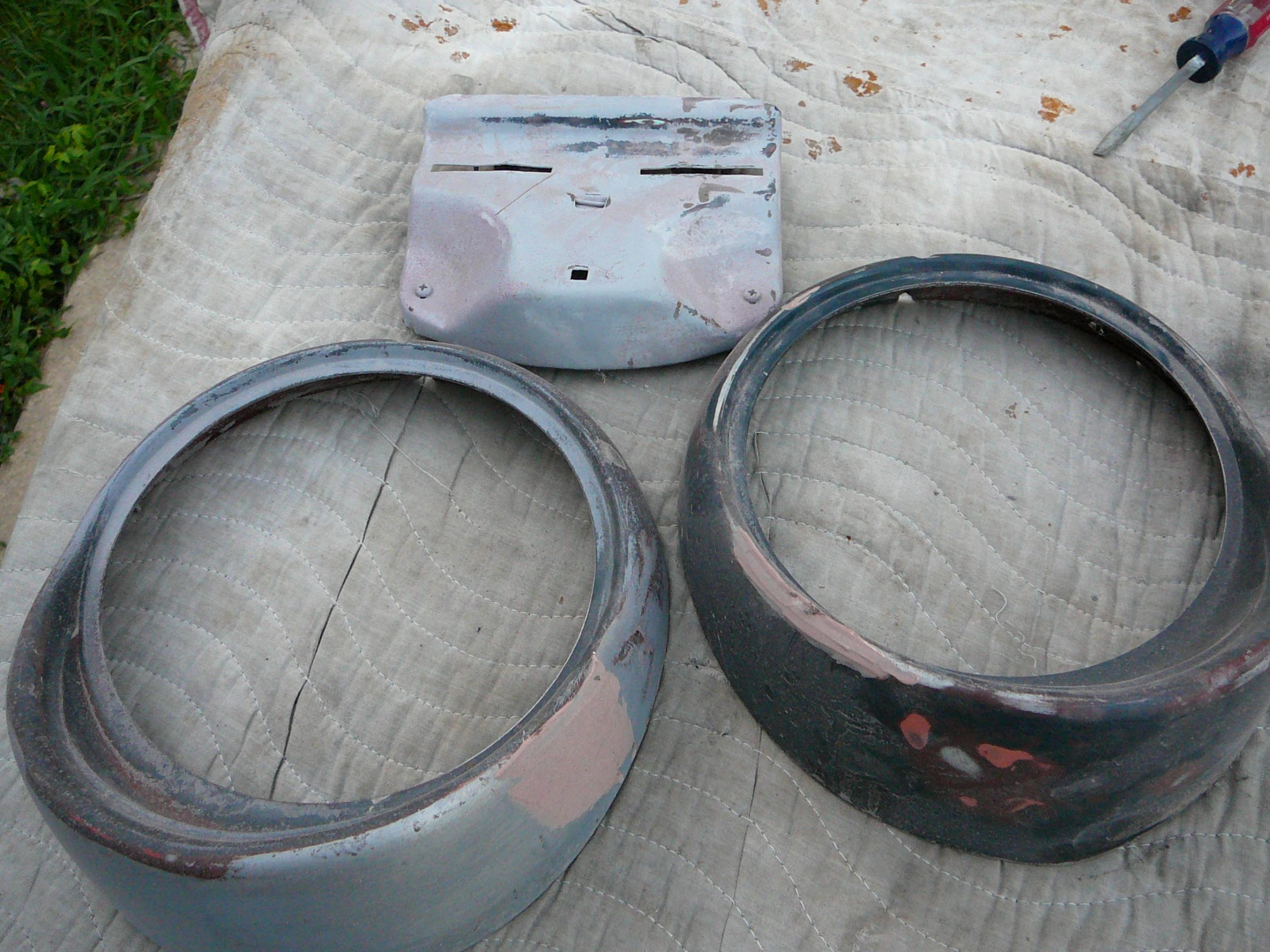

    1) They forgot to paint my headlight rings and gas tank door. he took them off the car, so he had them 6 months. I reminded him many, many times, before and after the paintjob, but he still didnt do it. I left them with him for 3 weeks after I picked the car up because each week he promised to paint them, and didnt. For a week he insisted they were in primer and ready to go. I gave him a week after stating that and I finally went by unannounced and picked them up. They werent even sanded, let alone primered. 1 of many lies caught. Good luck for me to match them to the car now because he has NO paint cans left over so I can be sure of code/paint brand used.

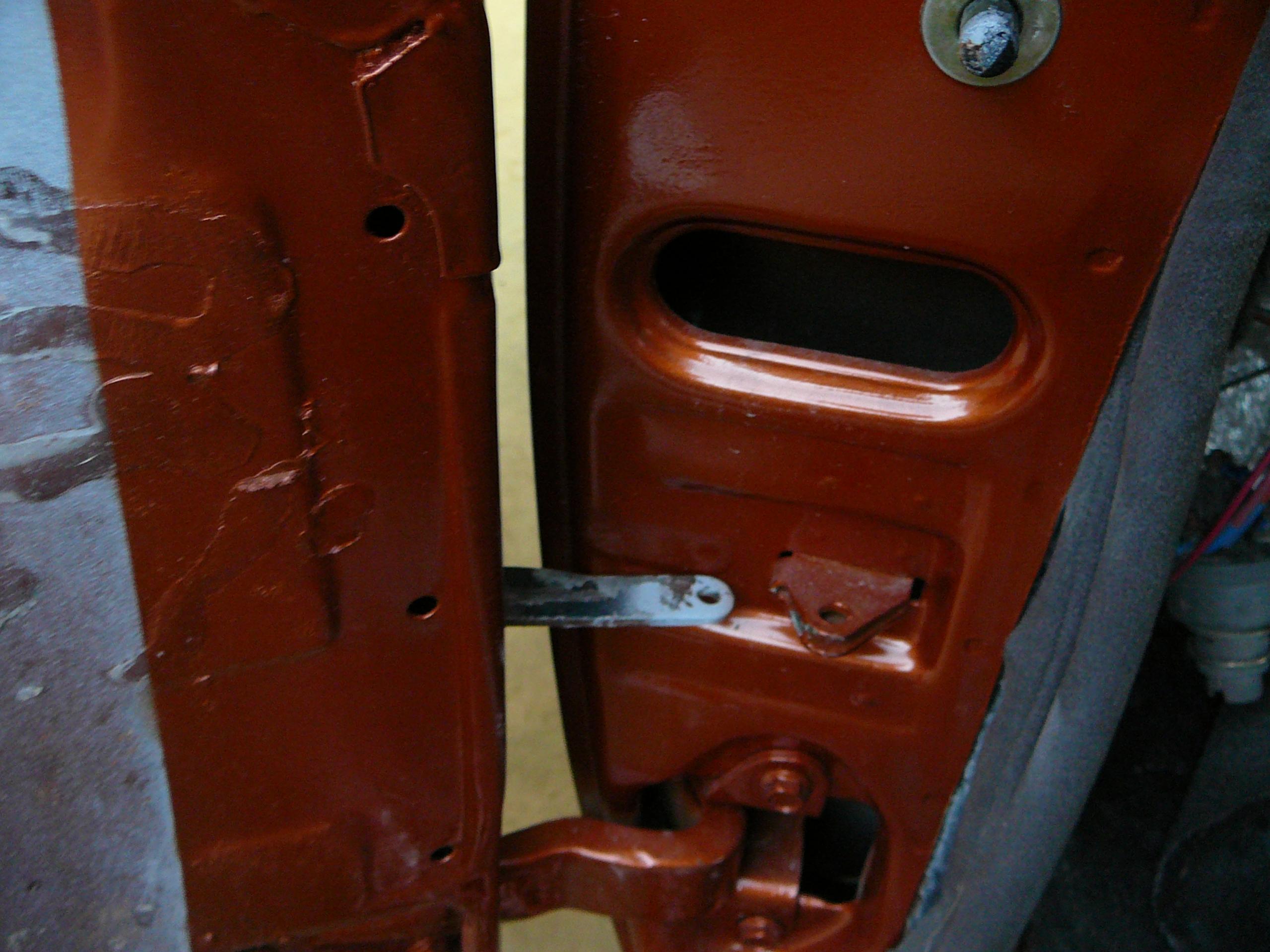

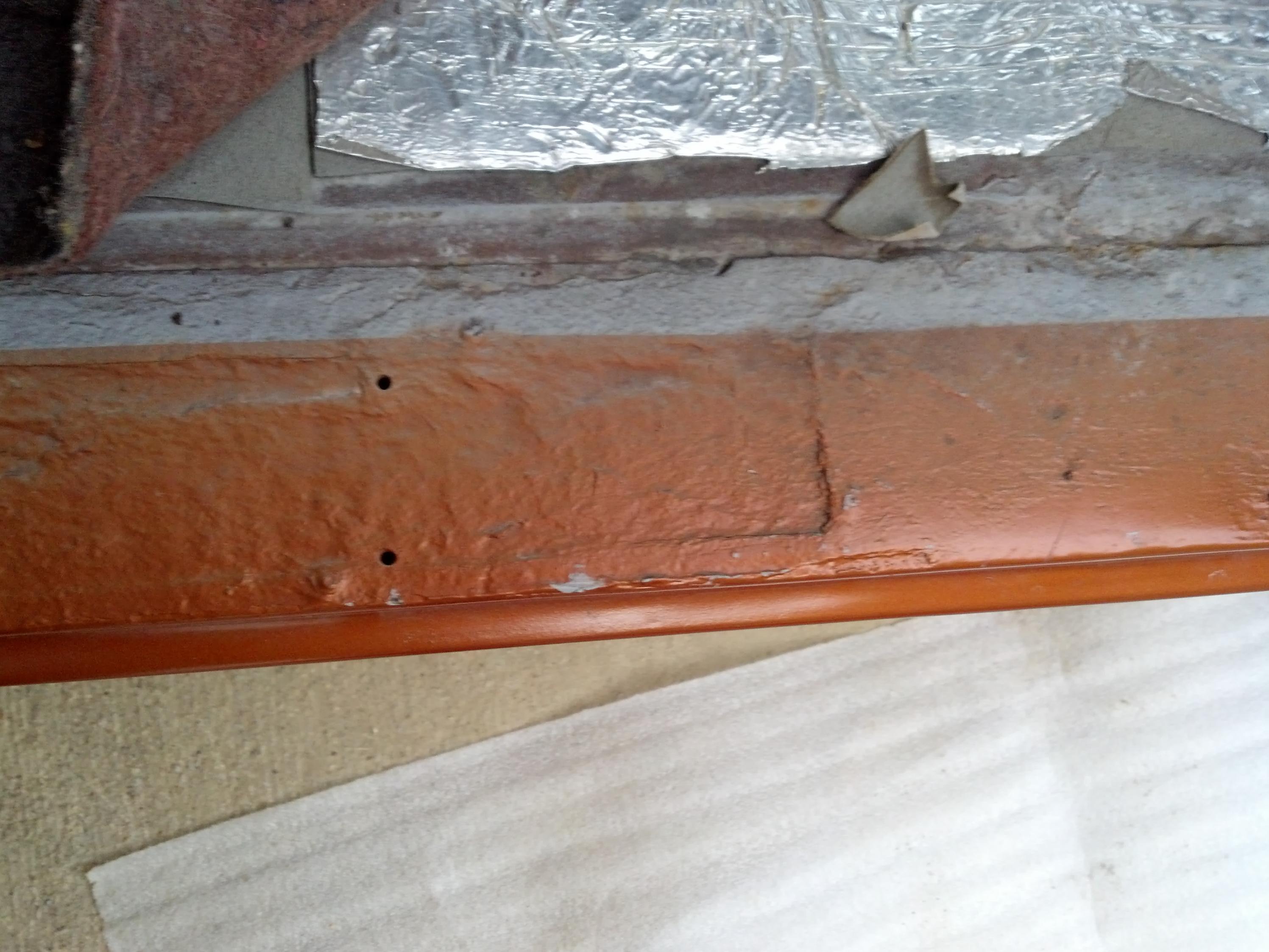

    3) (In contract) - Rust treat and repair inside of doors and be sure of drain holes, etc.. Pics speak for themselves. Passenger door had 1/4" water staning in the bottom of door 3 days after they washed it I finally noticed it. WTF?

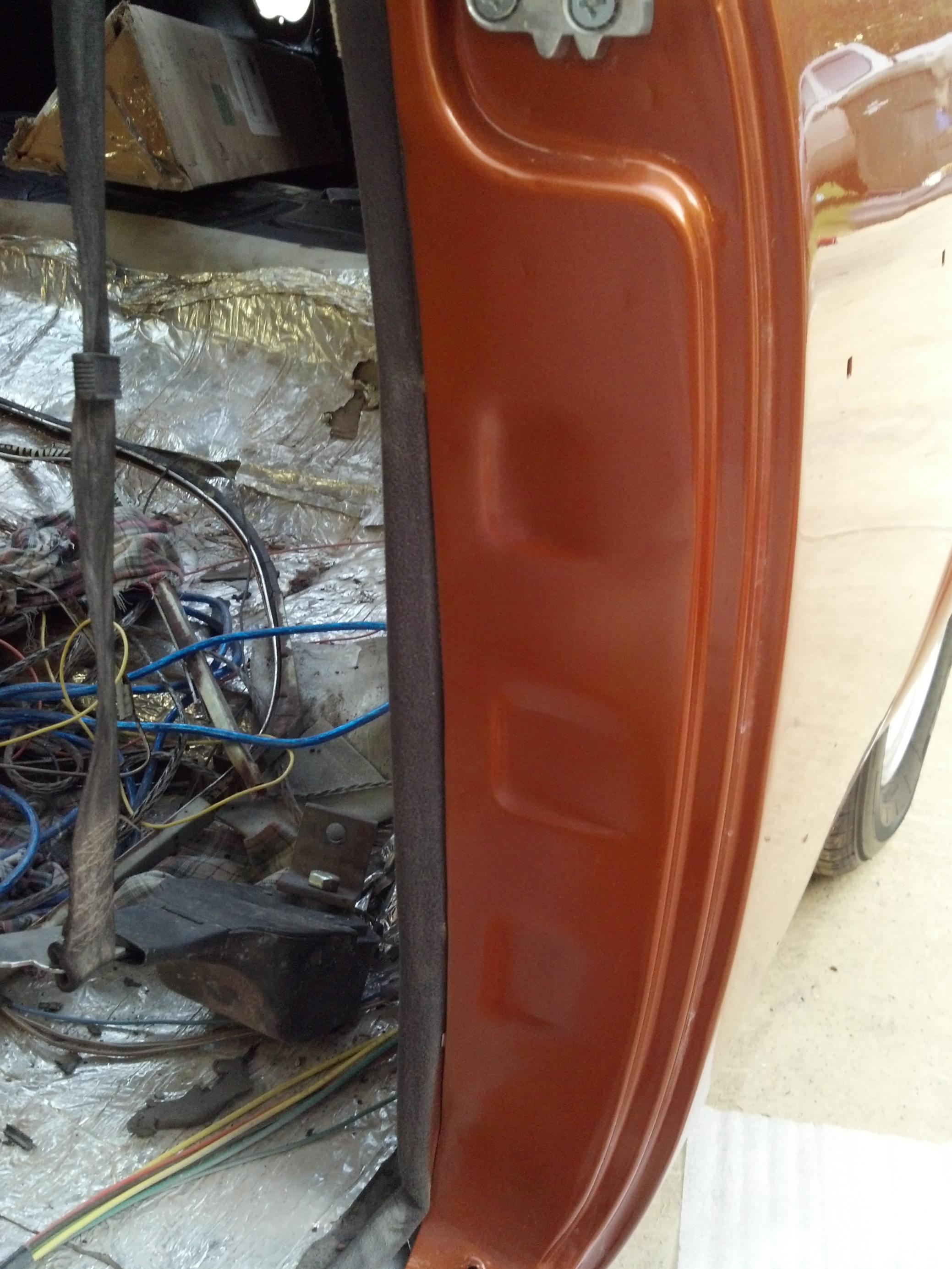

    There is a large area on the rear that is full of white pinholes is the best I can describe it. The paint is loaded with trash, and I assume this was once trash that was buffed out, I dont know. hard to tell but very noticeable.
    Most of the jambs are not cleared
    Here are the unpainted parts that will probably never match now
    Door flippers/poppers (if thats what its called was not painted, because it was tucked inside the door when brought home. They pained the jambs on the car and undid them and tucked them in the door when they painted it, and obviously forgot about them
