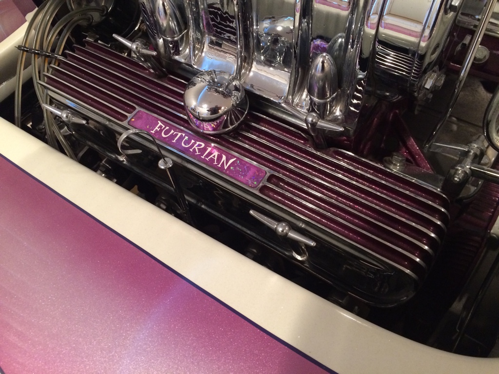

  12. Moriarity
    Joined: Apr 11, 2001
    Posts: 31,159
    Moriarity
    SUPER MODERATOR
    I masked mine on the Futurian with 1/8” masking tape. With all the different coats, base , flake, candy and clear. Would have been tough to wipe clean with a rag. Worked great for me[​IMG]
