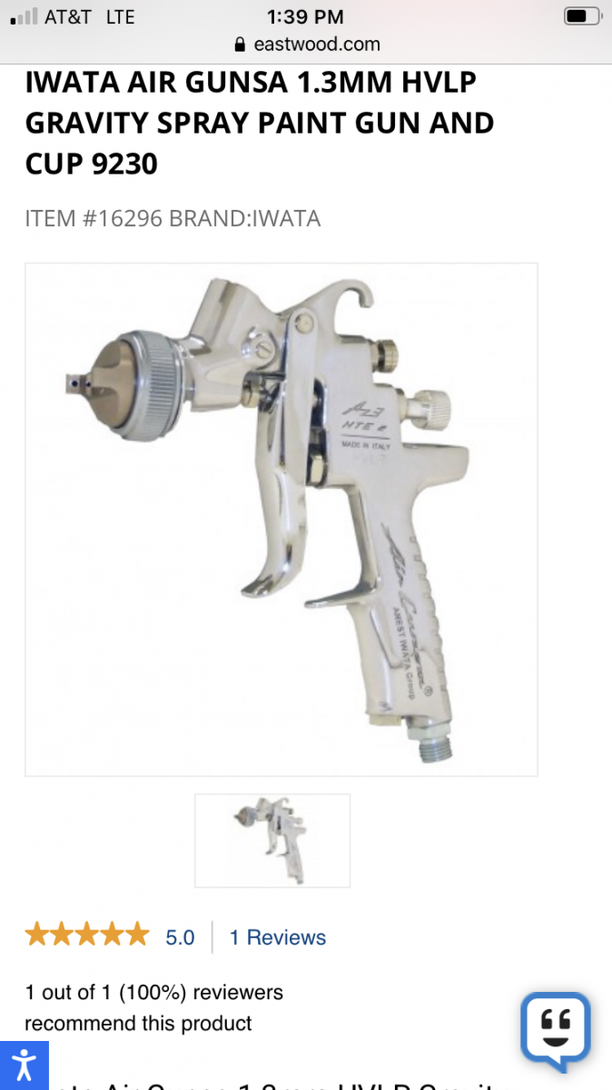

  16. Paint is 99% operator/preparation/and following a process.
    The tools used don’t make a painter however a quality tool helps make the job easier.
    I have used the HF cheapo, CH from Walmart, the cheap paint store combo kits, to the expensive Sata, Iwata...... there is a difference but the person squeezing the trigger makes the biggest difference.
    The best “low cost” gun I have used is this
    cost in the $130-$160 range. I like these better than the finish line guns. The spray pattern is much better in my opinion.
    the material being sprayed is important. Tip size need to match the material.
    also don’t use your paint gun as a primer gun. A cheap 1.5 or largerfor thinner primer. 1.7/8 for heavier primers 2.0+ for poly or primer fillers.
    1.2-1.5 is the normal range for clears and single stages. Depends on how fast ya want to move and material viscosity
    1.3-1.4 is normal for base coats.(some use 1.2 on thinner bases)
    The ole Binks #7 is still a favorite of guys here.
    You guys can have em. We did a side by side comparison at school, the #7 waisted about as much paint as it sprayed on the parts. So if you like wasting money and lots of unneeded overspray, and mottled metallics, then the siphon gun is the best choice.
    A 1.4 usually fits well with most base/clears and single stages.
    There are guns available that have multiple tip sizes.

  17. Yeah they are HVLP, gravity feed guns. I have 5 of them that I use, depending on the product I'm spraying. I do have 2 old siphon guns, a devilbiss and a binks. But what K13 said holds true, every painter has their own preference. I am comfortable with mine, and if it isn't broke, don't try to fix it :D
