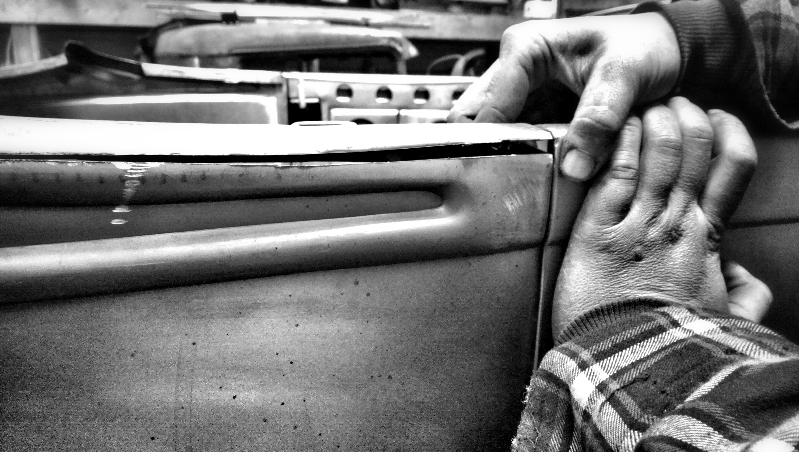

    We got the passenger side together and discovered the body line is a 1/4" smaller on the quarter than the door. Cut and add is the fix....

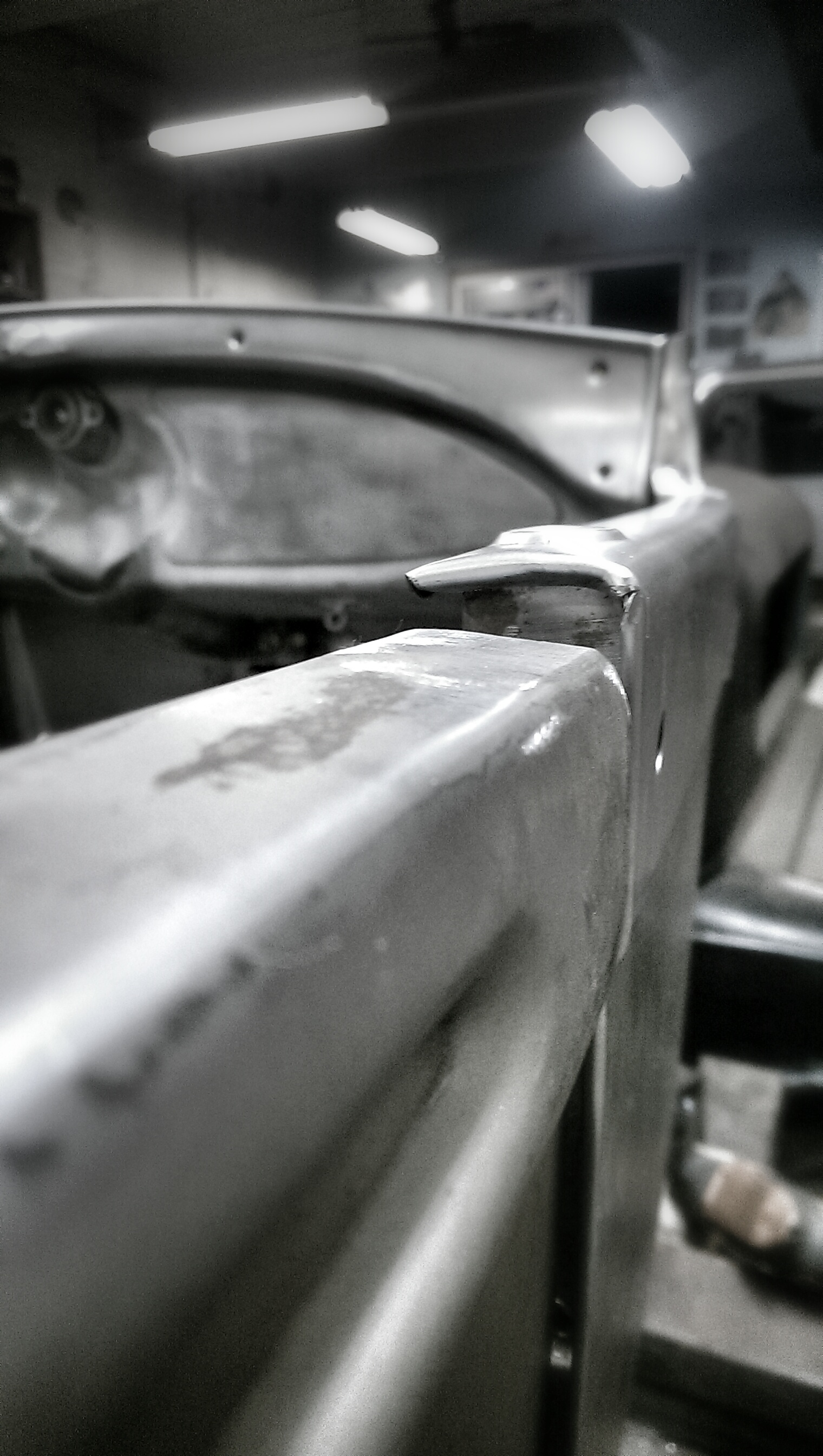

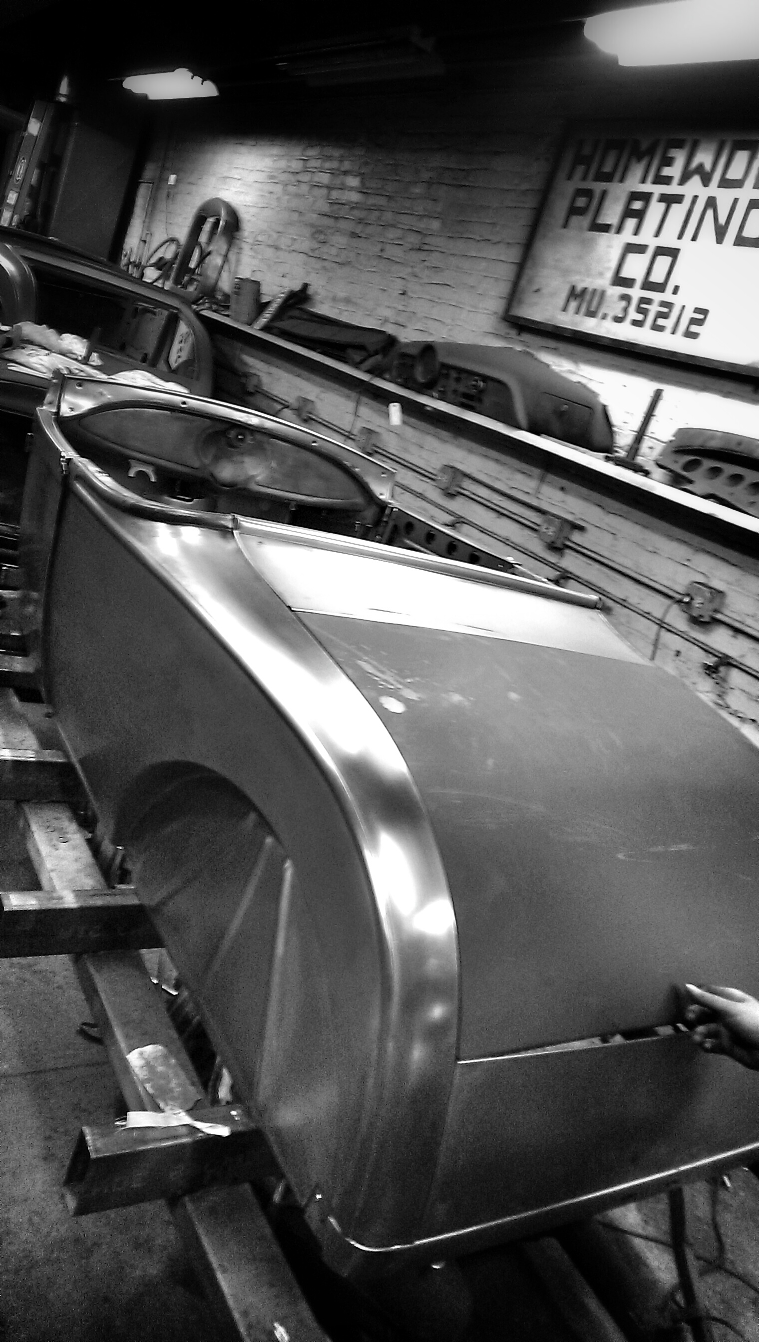

    t strips dont fit when ya get em from brookville
    after some love
    back panel fit
    looks like somethin
    kiwijeff, volvobrynk and Olson like this.
