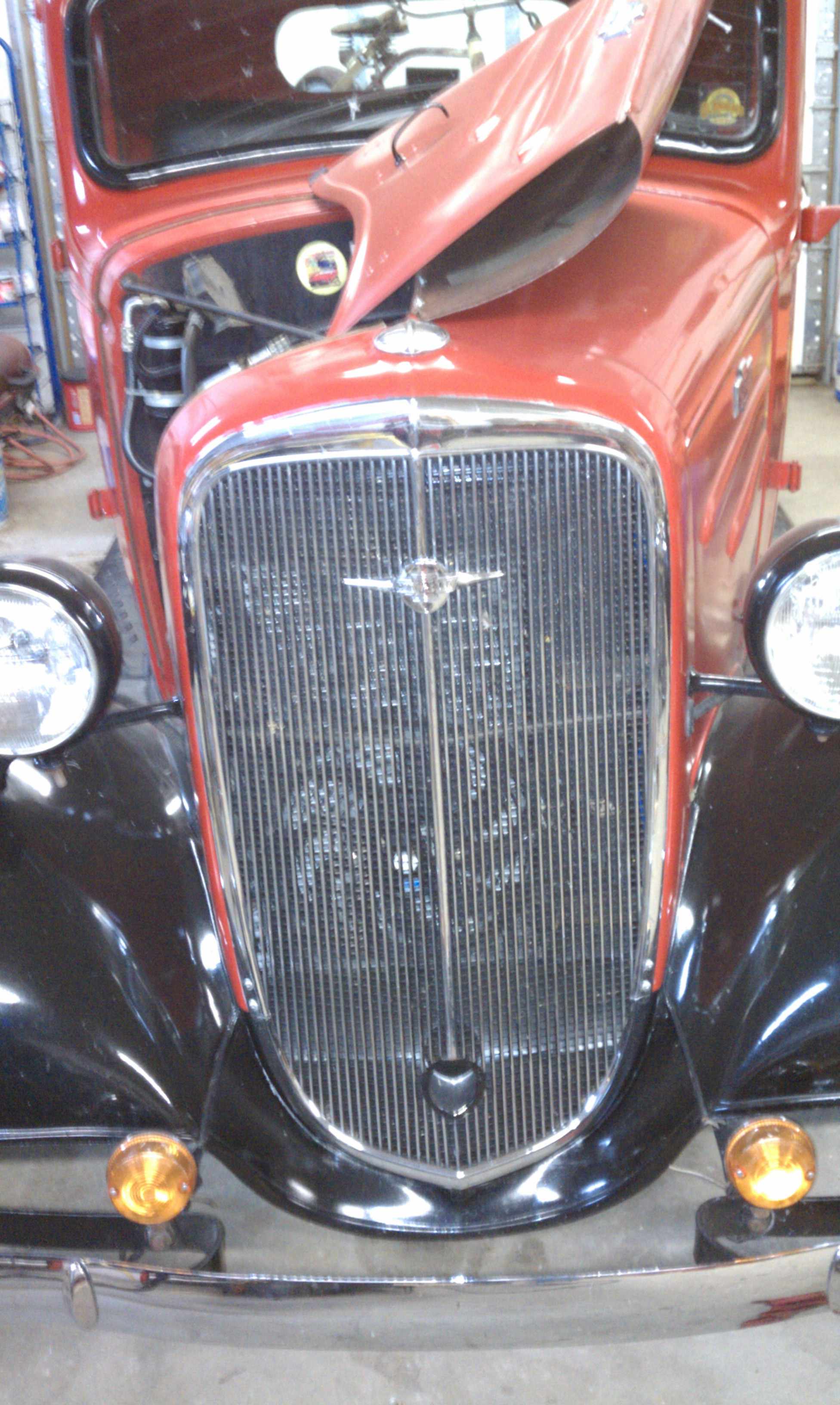

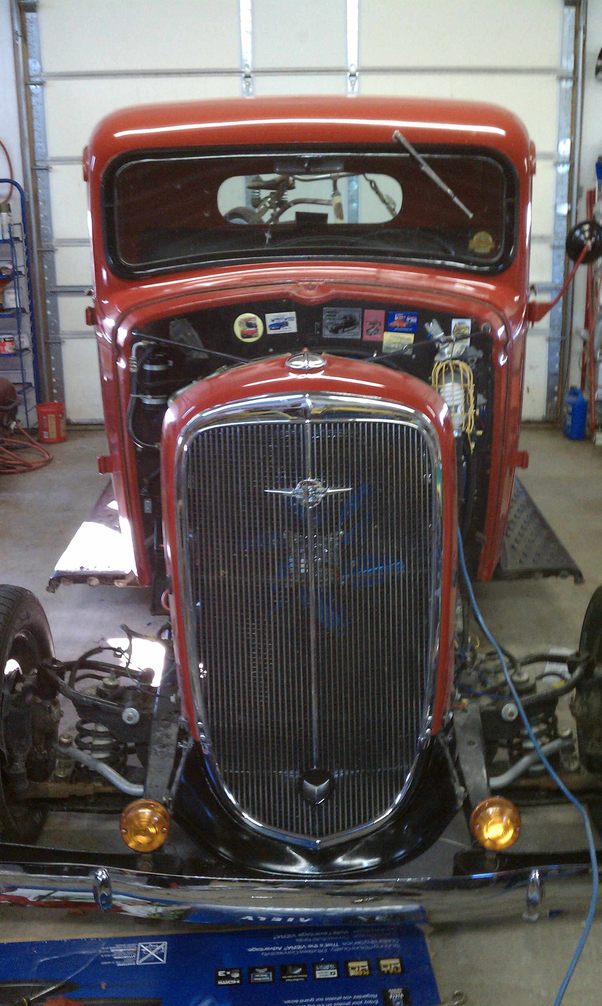

    I'll take a picture after I get it apart. The fan and condenser is behind the grill shell and they are all painted black. Its hard to see but here is a picture.

    Pic of grill

    Looks like a somewhat small fan mounted down low.
    It should be a bigger one mounted up higher where the radiator is hotter, or twin fans stacked.
    Fan blade dynamics? Too close, may/or may not cool as well
    but it sure looks like the fan does not cover nearly enough. I would not remove the condenser yet. Yes it will run cooler, but if you want the AC, try other things first.

    Its kind of hard to tell but the fan is the same width as the condenser. I'll see if there is room to mount another fan above the current one after I get it apart.

    Just from the pictures of the frontend,your problem is fan location and size. Mostly location. Its not cooling but one part and at a stop in traffic you have no airflow at all to most of the radiator.

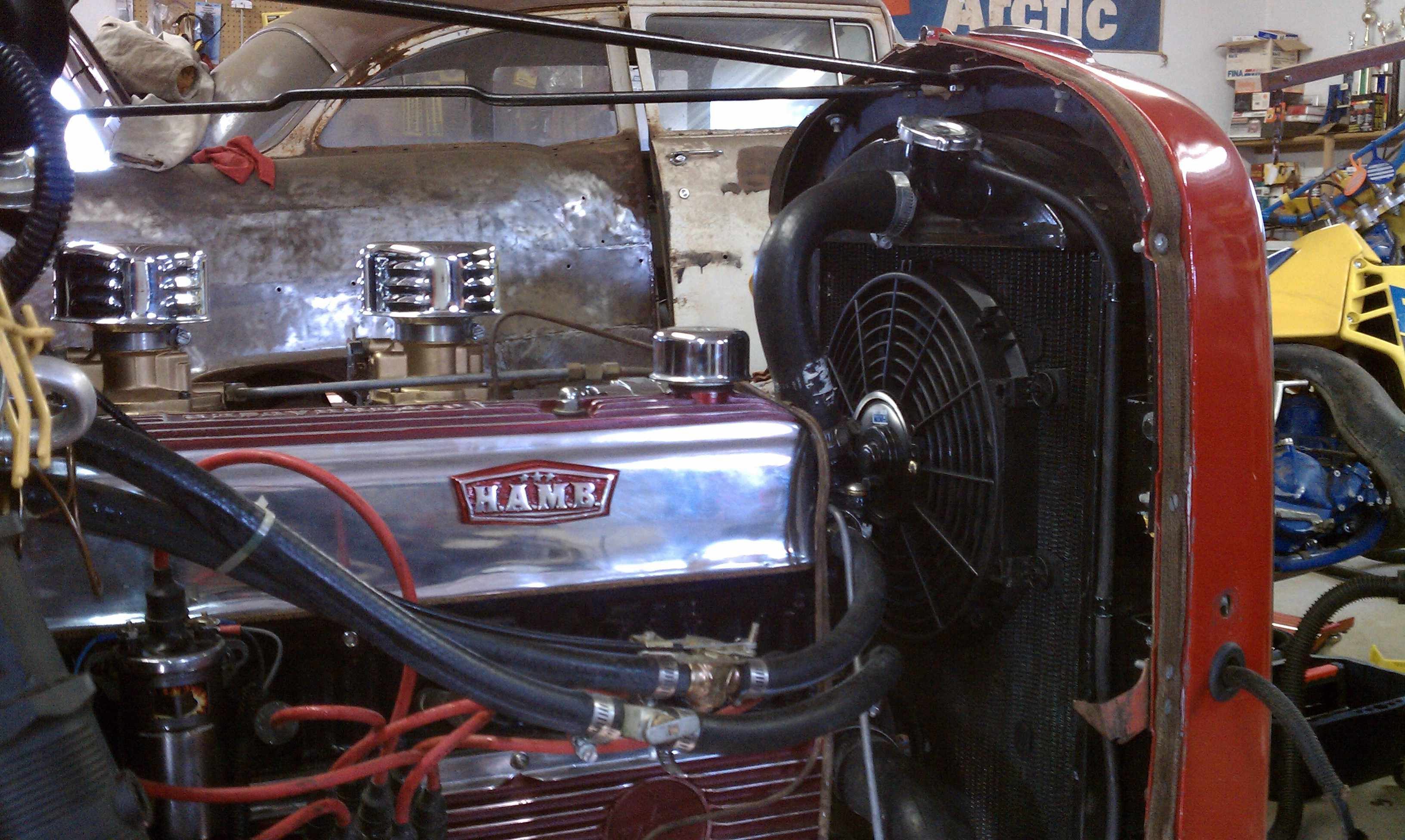

    I pulled the grill off and removed the condenser. I installed a 16" fan in front as a pusher and a 12" fan on the back as a puller. Not enought room in front to go with a larger fan or to put two.
    It seems like it may cool a little bit better but it still seems hotter than it should be.

    Should be a simple matter to now remove the front fan and try it with just the puller realizing that these two are possibly bucking each other.

    As suggested take the pusher fan off the front,its just cutting the air supply off to the puller fan. And be sure your puller fan is turning the right way to pull not push.
