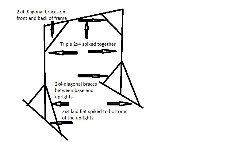

    D25342B1-8B13-4E95-B580-1979D121915C.jpeg Until you get your overhead build, you might build a ground lift like mine.
    Contact me for plans!
    Bones

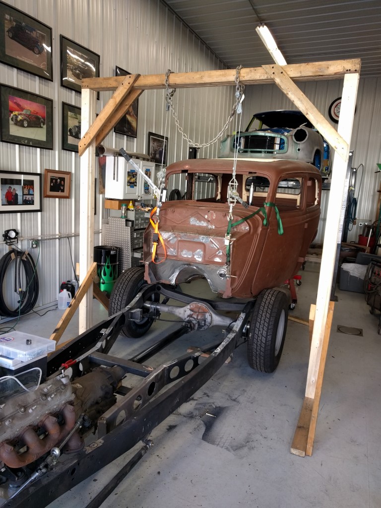

    Just like this…

    I like that and thanks for including the plans. I suppose I could put locking swivel casters on the base 2”x4” at the ends and the centres and also use brackets to hold the base to the uprights so I could un-bolt everything and have easily stackable sections. Comments?
    I wonder if I could hang those sections from my trusses? LOL

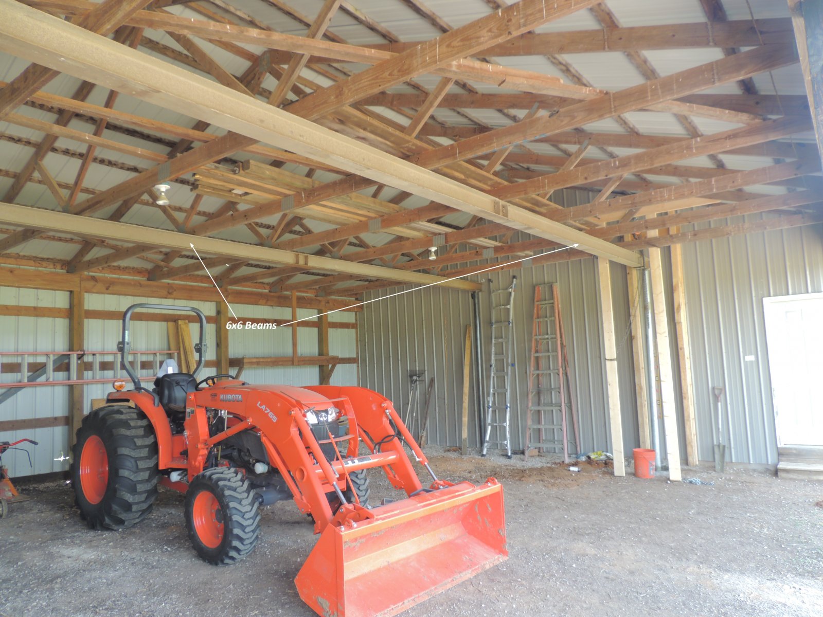

    Well I’m rethinking the placement of the hoist. I suppose the tread title should change to “...on third thought.” I originally wanted it to be inline to the garage door whereby I could lift a body and then roll the chassis outside. But I haven’t checked out how my trusses could be modified but will do, I still owe pics to one of the posters.
    However I do have two beams of four, not three, 2”x12”x14’ running down the centre of my garage where the addition is attached to. These are supported by 6”x6” posts. Looking up what a 2”x12” Douglas Fir could hold online numerous sites state 180 lbs per linear foot. So my calculations: 180x14x4= 10,080 lbs which should be more than adequate to lift a car body...
    Now I’ll have to get my calculations confirmed of course.
    The only hiccup is that the beams run perpendicular to the drive through door, in other words 90* to what I really want. But I think I can handle that and use dollies to pull out the chassis and then rotate it. And if I choose to have two hoists operating at the same time to lift a body, fore and aft, RICH B’s suggestion should do the trick.
    So if there are any more comments or suggestions please post and to all who have responded I really appreciate your lessons in “Structural Engineering 101”....

    I think you need to recalibrate that load rating….as the beam gets longer the amount it will hold gets less. An eight foot beam will hold twice as much as 16 foot beam. That is a generalization, but I hope you get the drift!
    Be safe!

  15. So what is the span between the 6" x 12" beam and the wall? You might look at making a beam to go from it to the wall, placed at the location of one of the posts. Support the 'wall' end with a substantial post, and Bob's yer uncle. Use bolted connections with stout steel hangers, which may have to be fabricated.

    Basically what I have is a post and beam construction. Six 6x6 posts altogether, three on east wall with 6x12 beams connecting the posts. The outside walls are studded with 2x6 every 18”. So the beam I’m referring to has a span of around 14’.
    I’m not really understanding what you’re suggesting. A simple sketch might help me.

    Install a beam (made up of three 2 x 10s or 12s. Might be overkill, but we want you to be safe) between your outside wall (is it sheetrocked, or are studs exposed?) and the main beam that runs on top of the 6 x 6 posts. This means the new beam is running across the garage bay, parallel to the garage door. Be sure to adequately support (with a post) the end of the beam at the outside wall, as well as bracing to prevent movement (front-to-rear of your garage).
    This would be a single, permanent location fore and aft in your space, but with some careful measuring you should be able to place it in such a manner to allow decent working clearances.
    I hope this clears it up.

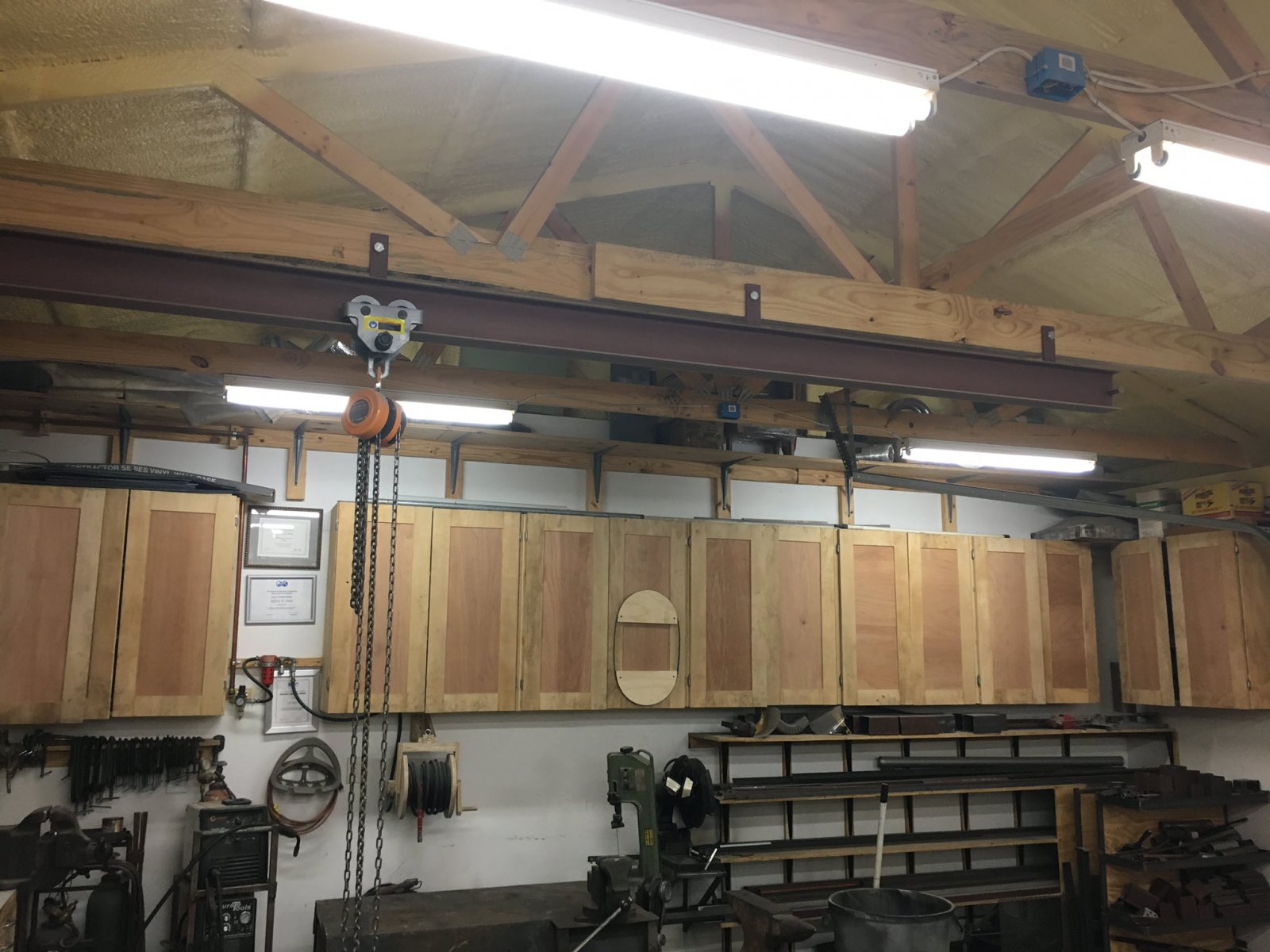

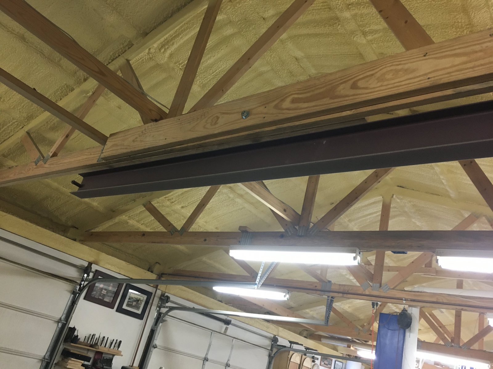

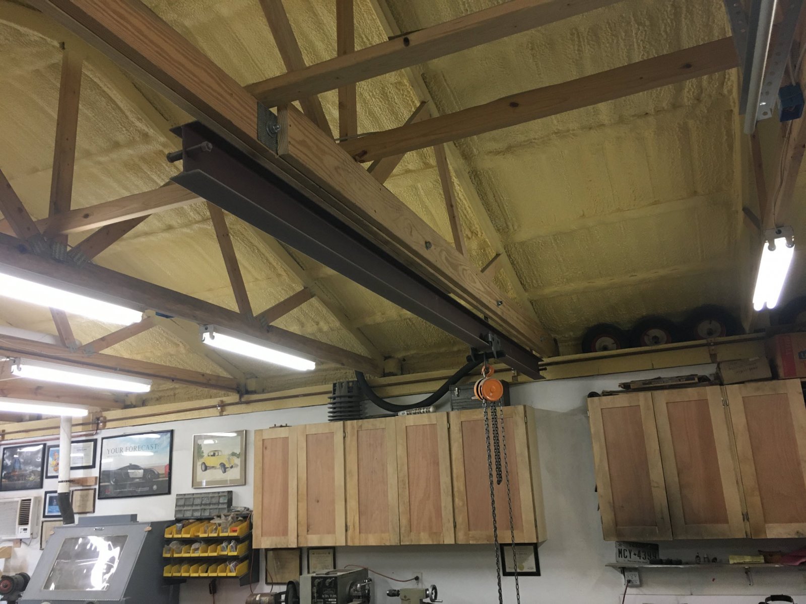

  22. I use a 2" x 4" I-beam with 1/2" x 2" mounting tabs welded on top. Use a manual Harbor Freignt chain hoist. I scabbed 2" x 8" beams to the 2" x 6" bottom rail on my joists. Joist mounting bolts are 1/2" through bolts. I used two 16' boards on the 24' span. they sit on top of 6" x 6" posts in the walls and overlap in the middle. It is a 'pole barn' - steel siding and roof on 6" x 6" buried post walls.
    This lifts any engine/tranny combo or car body with ease.
    impala4speed and ekimneirbo like this.

    Your steel beam is only benefitting from 1/2 of the wood beams strength

  26. A bit more than that. You are discounting the shear strength of the wood plus I used a lot of nails too so it is very stout. No worries.

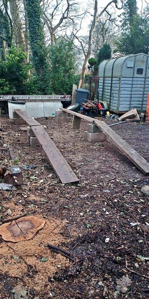

    The Willys36 is a good example of what I was saying about scabing 2x6s onto a truss. I would have scabbed both sides all the way to the wall though........but I try to always overbuild as much as I can. Another consideration is the beam being used. Sometimes you use whats available and cheap. If you have a beam thats supported every few feet like Willys36 did, you can use a 4" beam instead of a 6" and that will lighten the load on the truss even more. One last thing I would do is run a steel beam/box tube or even a couple 2x6s across the trusses perpendicular to the crane. Then you have some support from two other trusses IF something should start to deflect too much. With me its all about doing everything I can think of even if its never needed.
    Here is another crane we are building in another building at my sons place. We put this up before we pour the concrete floor. The beams are about 30 feet long. When we get back to working on it, we plan to attach some supports to the trusses just to give a little support in the center as the beam might deflect too much with a heavy load in the center. I figure if we attach the beam to the trusses with brackets similar to what Willys36 used, it might not deflect at all. The brackets will also serve to keep the thing from falling sideways.........plus there will be some bars welded between the two end supports to get the spacing correct. Then two cross trolleys will be put on them.
    We are also considering a movable post that can slide on the beam and then be screwed down to give support when/if needed. Something like those beam supports like they use in basements and has a little plate thats adjustable. Don't know right now if we will need it or not, but thats the current thinking.
    The thing about a steel beam is that you get trolley movement that you don't get with a wooden beam, and you give up no floor space. Nice Job Willys36 :)

    Willy 36 , depends on where the wood decides to split , straps over the top of the wood beam to support the load would ensure the support of the whole beam , not just from the through bolts down . When you support a hay rail , the support bracketry goes over the top of the ridge pole .
