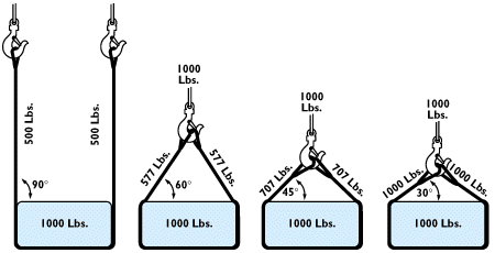

    I think there have been enough warnings about what to do and not to do with hanging stuff from trusses, so I'll steer in a different direction. This direction is in regards to the angle of the chains or straps when you are lifting things, and the multiplication factor that an angle has on the ACTUAL loading of the straps or chains. I "borrowed" the photo above from earlier in this thread to show what appears to be about a 30º angle, which translates into each side of the two straps "seeing" the total weight of the body being lifted, per the image below.
    Make sure your chains/straps are rated for the load that will actually be put on them, not just for the weight of load you're lifting. The angle makes a big difference.

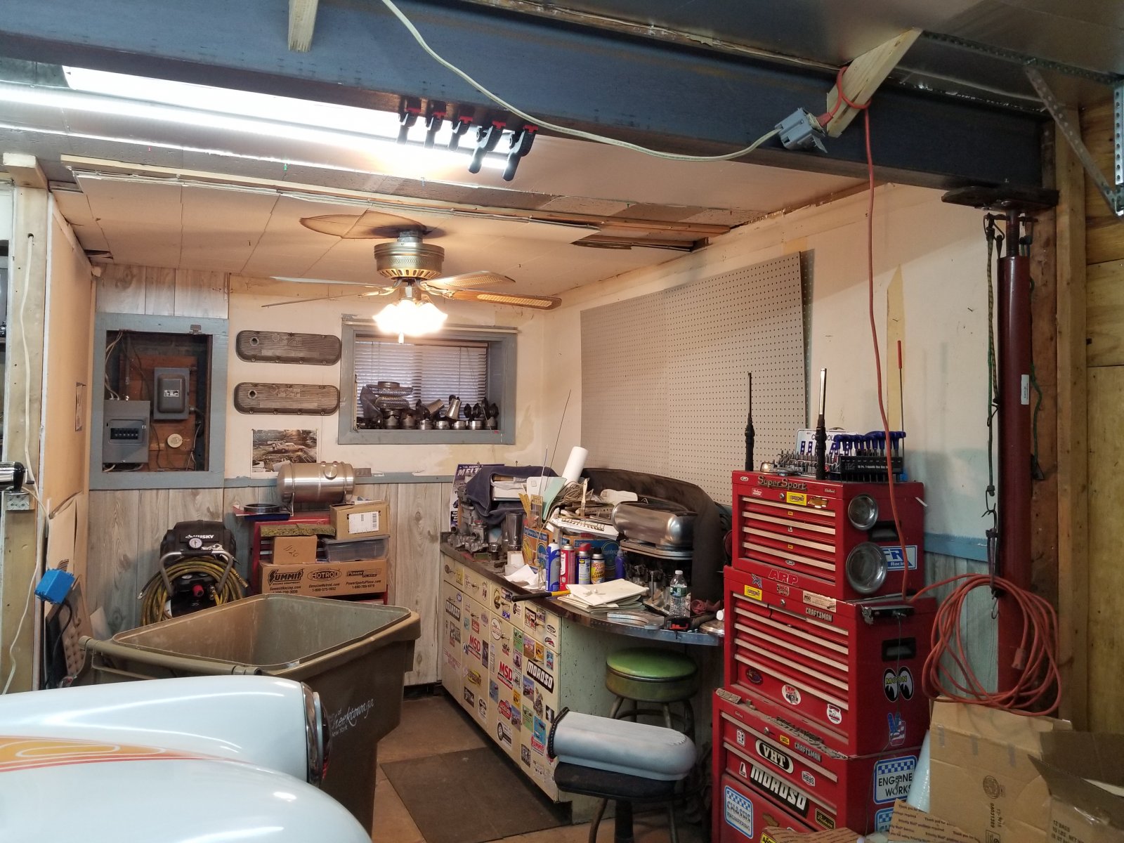

  6. I guess I live on the sketchy side of doing things too, I have 2 of these chain fall setups hanging from 15 ft high I-beams, one about 10 ft in from the main door and another about 25 ft in. I already have a back injury and certainly don't need it any worse than it is so I use them all the time and have lifted the front of my 41 right off the ground with them.
    In the back half of the garage there used to be a one bedroom apartment, I ripped down the majority of the walls, double stacked 2x4's the full width of that span then slipped this I-beam through the door and under them.
    Once up in place it has the standard triple king post on ends that the beam rests on and then I put basement jacks next to the triple kings, I have no doubt it would hold an engine but since I have those others I don't use it for that.
    That beam wasn't that expensive from my local steel supplier and takes up less head room vs the same load capacity LVL.

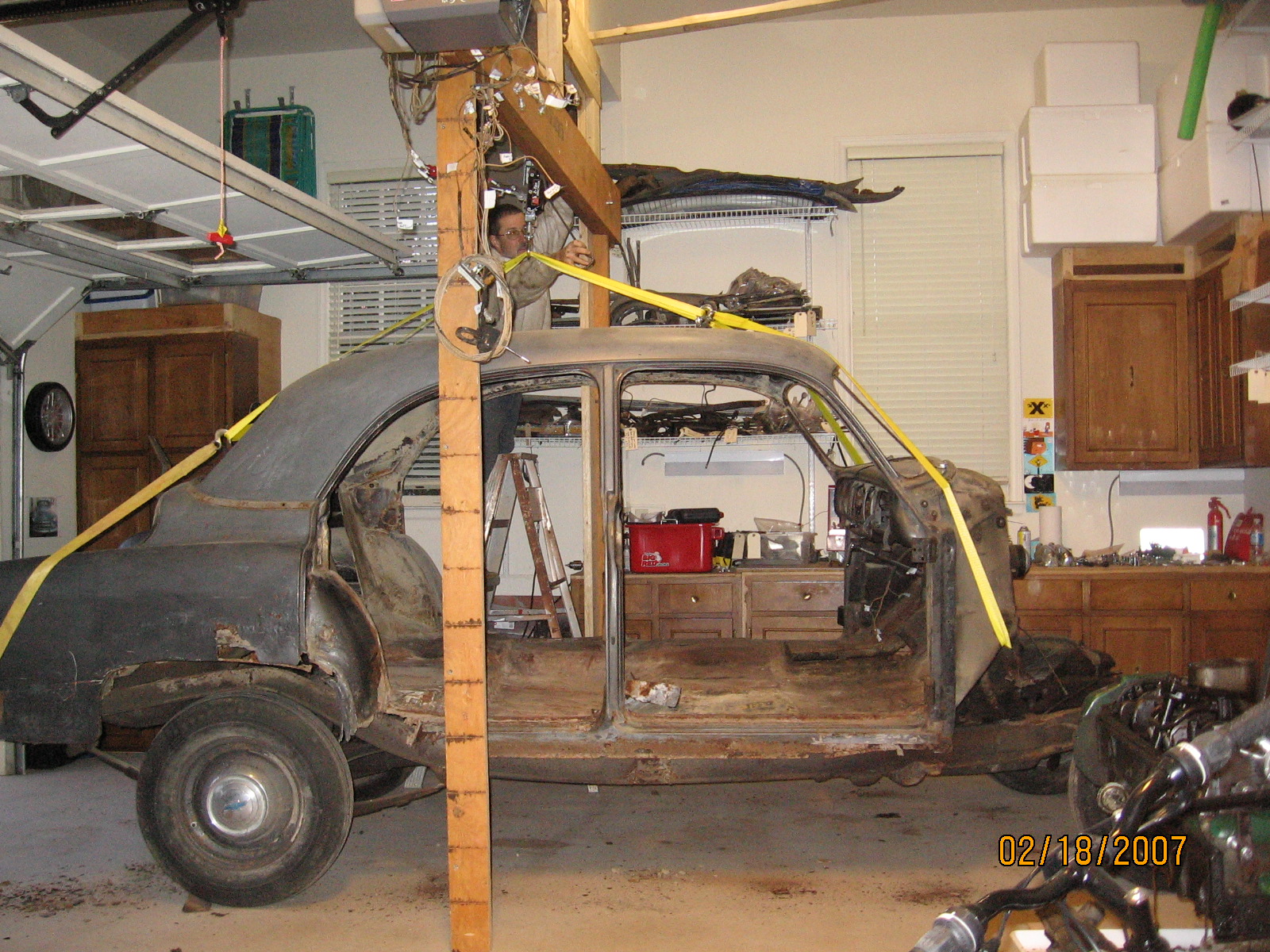

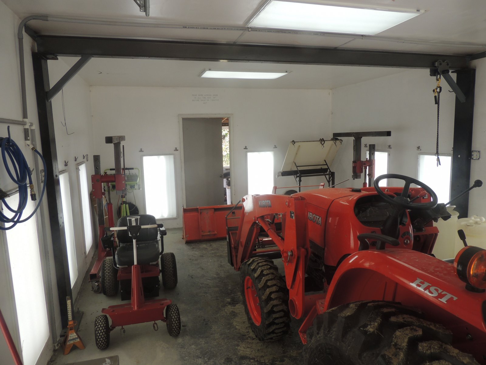

  7. When I hung an I beam on a couple Glue laminated beams in my new garage for running a rolling hoist, i did a deflection calculation to see how much weight would cause a 1/4" deflection where the I beam would be hung. based on the weight allowed for a 1/4" drop, minus the beam weight I gave my setup a nominal weight limit at the ends and overhang of the beam, and stenciled it on the beam. The building inspector had no problems with the approach. Intuitively, a 1/4" deflection would not be approaching the allowable load that the beam could safely handle.
    a bit of the beam and hoist can be seen.
    The full beam with stenciled limits barely visible is shown, with hoist at far end of beam.
    Okie Pete, alanp561 and rusty valley like this.

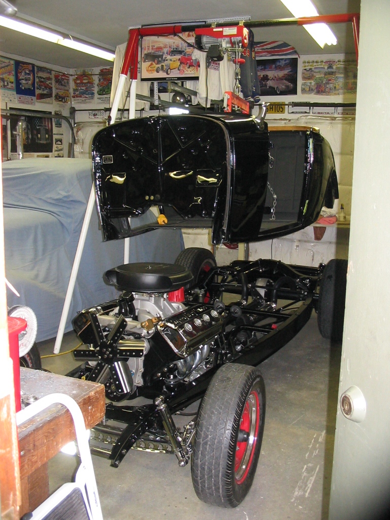

  10. I built this A frame that breaks down for storage, and have lifted my Hemi Engine and transmission combo as well a my roadster body. A6D4FAF6-9FC8-46F3-8005-E17F7F1C6E42_1_105_c.jpeg
    Okie Pete, PoTaToTrUcK and alanp561 like this.

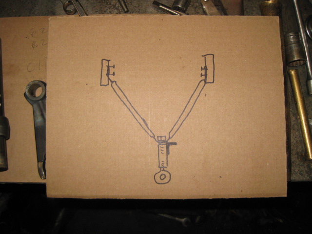

    My buddy had a slick set up (was in my eyes anyways) he had a pipe with a flange welded on the bottom and bolted to the concrete floor, he then had another plate welded on top bolted to the bottom of a truss. I don’t know what he used for bearings, but at he top a 6 inch I-beam came straight out about 8-10 foot and had a brace maybe 3 foot into the I beam and back to the pipe for support.
    His hoist was on a trolley. He had it set back maybe 3 feet from the shop door. He could back up to the shop, open the door and “swing” this arm outside, used his hoist to lift the load, swing it back in to the shop.
    He was always on the look out for a motor driven trolley, to drive it back and forth on the I beam.
    It was a two person operation to drop an engine into a car with his set up, one would steady the engine and one had to use a 2x4 he had to coax the trolley into position. That’s why he was wanting a motorized trolley.
    Last I recall he was hunting down a garage door opener and was going to set it up to have a Jack shaft drive a cable attached to the trolley.

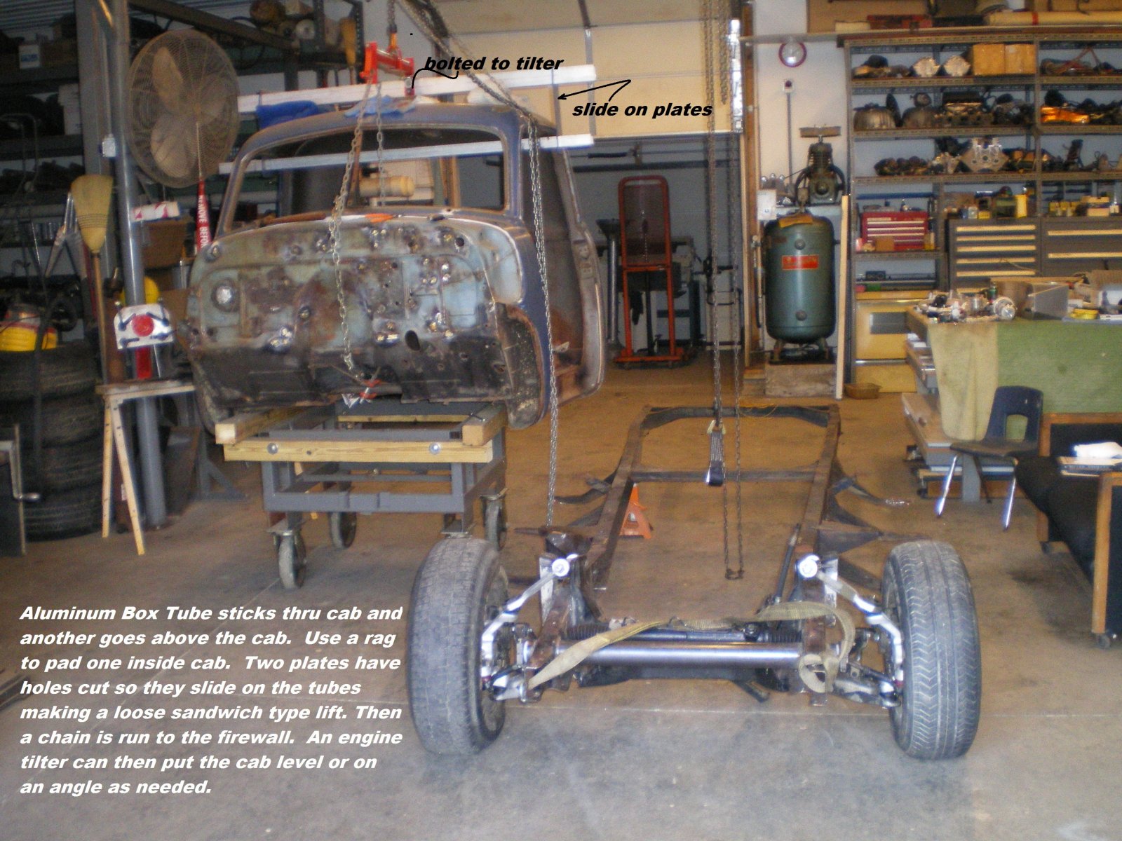

    The thing about trusses is that more recent designs (last 40 years) tend to use 2x4s and place them on 2 foot centers. Earlier on and still in some instances, 2x6 trusses were used and spaced farther apart. When I built my 40x60 pole barn, I used 2x6 trusses spaced on 6 foot centers which was a lot less expensive than 2x4s on 2 ft centers. A lot of the time, the 2 foot centers are used because people want to drywall their ceilings and the drywall won't make the longer span without sagging. I used metal siding for the ceiling and it worked well. The money that would be spent to finish drywall went toward spray foam in the attic and then a bunch of blown in insulation over that.
    The point is that its hard to say what your trusses are capable of holding because different sizes are used.
    If you just want a single point to lift from, or two single points.......I would consider scabing 2x6s to the side of several existing trusses so you can spread the load over several beefed up trusses. I would try to find some boards that will span in one length and thru bolt them to the truss on each side. Might look for a sawmill to get them long enough. If you can't get them in one length, then get some that you can stagger the break on each side of your truss.Get an 8' and a 12' on the other side of the truss....a 12' and an 8'. Put wood glue on them and clamp them to the truss and then thrubolt them in place.
    The best way would be to keep looking for Facebook, craigslist,local scrapyard,industrial auction.......and find a 6" I-beam that you can span it with. What would be really nice is to find two beams so you can have two lifting points. Then buy a manual trolley for the second one. Being able to move the lifting points is a BIG help.

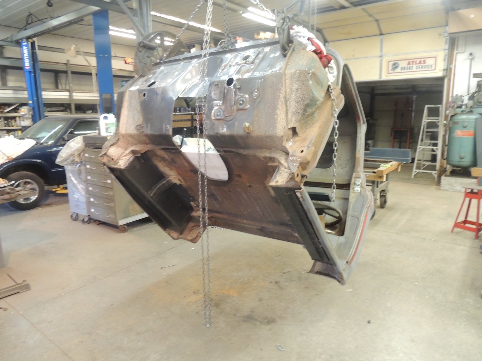

    If you only have one lifting point, it will help to incorporate an engine tilter into some sort of lifting bracket. Trying to balance a body while lifting can be problematic. It depends on the type of body. Truck body isn't as bad as a car body. Also, just running straps under the roof and lifting can bend the sheetmetal....ask me how I know.:eek:
    There are different ways to lift, but you do have to protect the sheetmetal both at the lift point and whereever the straps or chains press against the body.
    IMGP0425.JPG In the picture above, I bent the metal lifting like this
    This is a HF engine tilter bolted to an aluminum cross beam. Another beam runs under the roof. Then a plate is slipped on each side to make a sandwich. The chain to the opposite end of the tilter and down to the firewall allows you to level the cab as needed.
    Next is the advantage of TWO lifting points.
    I am working on repairing the firewall and the lower hinge pocket boxes. I can get it high or low enough to make access much easier.
    When the back of the cab is lowered to get the angle, the chain presses hard against the sheetmetal. I had an old roll bar pad I slipped over the chain and some rags around the hook.
    The next picture is the hinge pocket I need to repair. Its at shoulder height and easy to get to. Much better than crawling aroud and getting up and down over and over.
