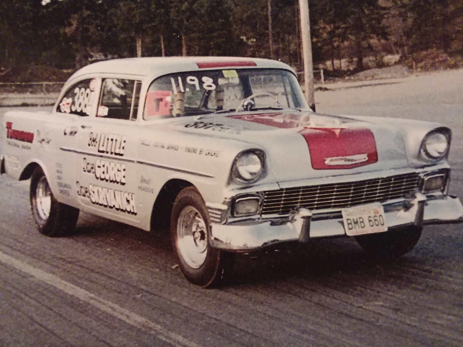

  22. Thank all of you for the input and knowledge.
    To clear up the vague, I am rebuilding a 56 Chevy than ran in Modified Production C class in the late 60s. There’s not much left, so it’s a rebuild versus a resto.
    I want to replicate the car as ran so I’m copying the drivetrain with a few exceptions.
    It had an Pontiac rear.
    Muncie with straight cut gears.
    327 with tunnel ram, Isky gear drive and a magneto. All per the 60s heyday driver and pictures I have received.
    So, I’m not points/class racing it but I will run it. I’d like to see how close I can get to their ETs. Minus the Isky gear drive, (which I don’t have anyway) and no magneto, it’ll be locally driven so I’d like to charge the battery with an alternator.
    It’s history.
    It took runner up in its class in Pomona 68, and class winner Pomona 69. Winternats.
    These guys had a helluva car.
    Sold in 70 or 71 and became a bracket car or street car and resold up to the 90s. Then sold to a guy for his son, and that’s when the rest of the good stuff was sold off and replaced with stock stuff and either abused or left out in the rain.
    But, I had to have it. I finally do. It’s a mess.
    What I’ve collected so far.
    A ready to go Olds/Pontiac 488 rear.
    A dofornow muncie.
    I’ve got the right tunnel ram. Core 64 461 heads. I’ve got a line on a 327 block. Actually I’m getting ready to tackle the body but I do want to get the right stuff to put a 327 together I can run and it will live.
    For the crank, so far, I do know I’d need a bolt on balancer.
    New rods seem money well spent.
    Forged pistons too.
    The short block I can get, I have not tore into it to see what there is to use.
    Without adding several pages of pictures, here’s a few of the better ones.
    The car looks nothing like this today but the lettering is allegedly under the Maaco paint. We will find out this fall.
    Again, thanks all!
    Dave

    Neat car! Nothing wrong with a GM crankshaft properly prepared.

    Beautiful. Happy crusade.
