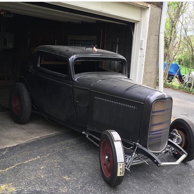

    Getting ready to mount up my hood on my glass 32 3 window project, i'm using a steel 25 louver hood and steel grill shell, and was getting ready to mock up my hold downs and was thinking Id like to see some traditions methods vs. custom methods.. Also any advice lacing, rubber vs. original? Thanks in advance..

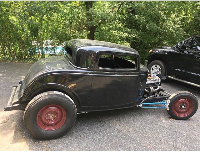

    Here is where I’m at at the moment.

  3. DDDenny
    Posts: 19,258

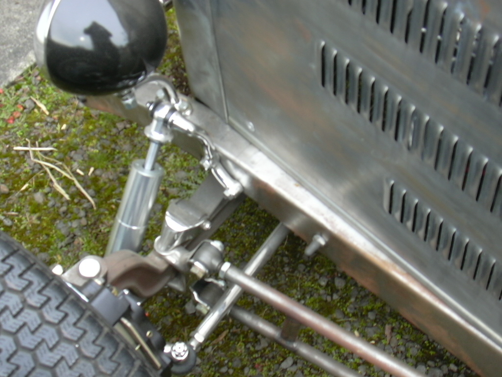

    I used Dzus buttons.
    I welded the receiver tabs to my frame but they can be made to bolt on also.
    shortypu likes this.

  5. Is it a original 25 louver hood? HRP
  6. lrs30
    Joined: Jan 30, 2007
    Posts: 2,214
    lrs30
    from Kentucky
    no its a repop with original style hold down brackets embossed into it

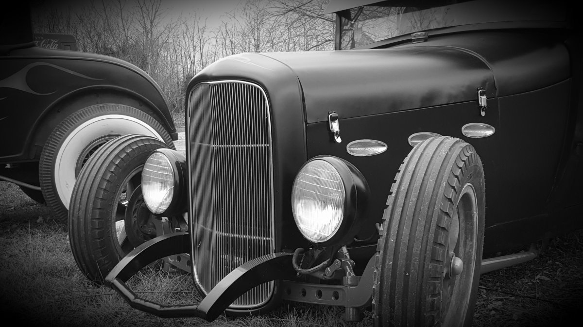

  11. 129.jpg I just used suitcase latches on my old jalopy. I'm sure your look'en for something a little more refined.

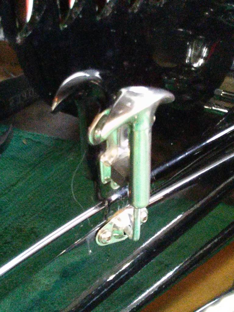

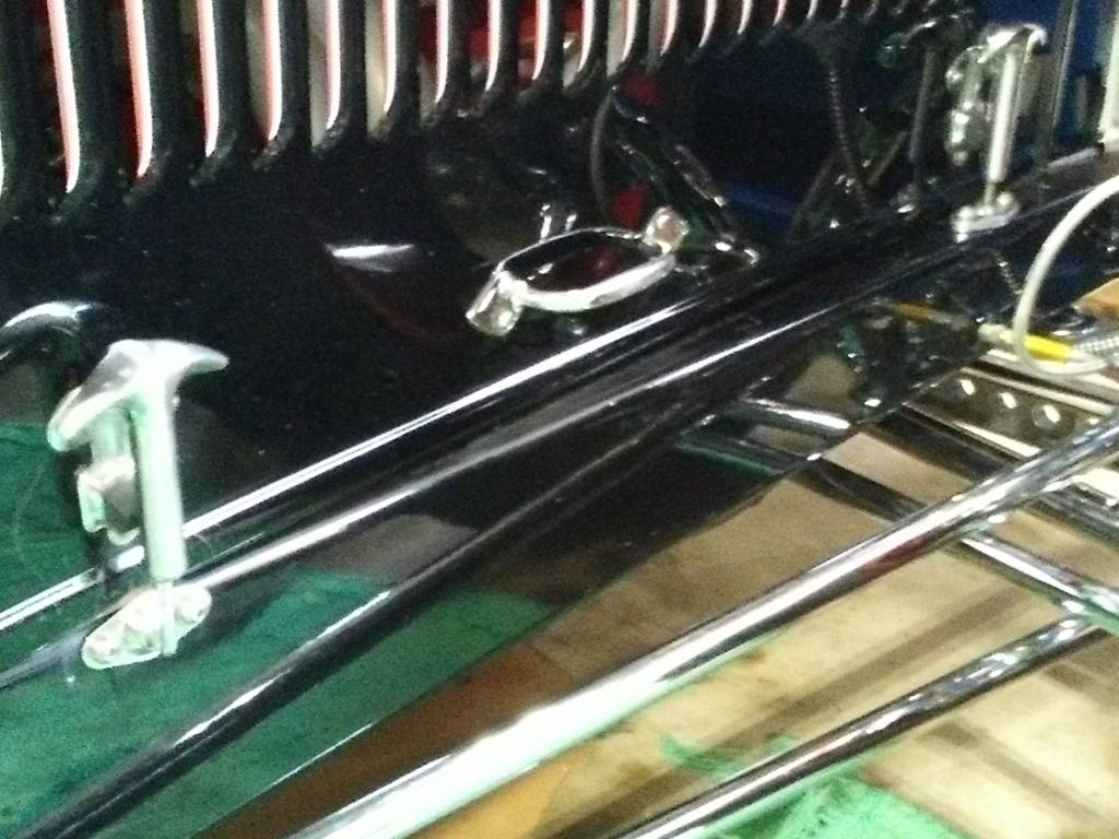

  13. My rear latches had a right angle bracket screwed to frame with stock latch screwed to bracket.
    I didn't like it so I cut off the rod from jeep windshield hold downs and welded them to the stock 32 hood latches. 1116181421.jpeg 1116181420_Burst01.jpeg

    Besides looking kewl, hot rods are supposed to handle better than the average car on the road.
    You are not helping matters by mounting the shocks body down.

  18. Yes, you can use a stock rear latch. You need to make a right angle bracket to screw to the frame rail and latch will sit on top of the bracket. This is how most highboys latch the hood.
    Phil
