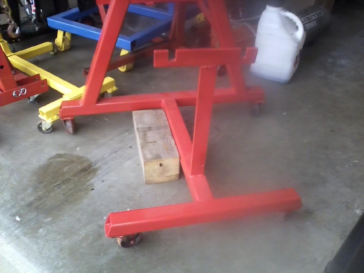

  17. I built my own, not finished yet. I did add casters.
    [​IMG][​IMG][​IMG][​IMG]

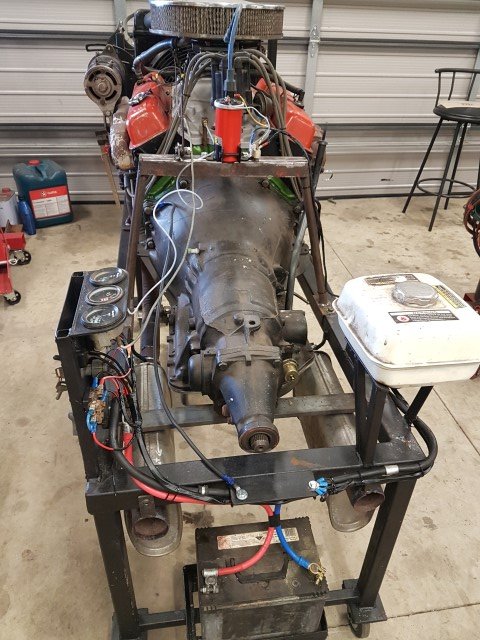

    I built one to make life easier for running in and changing things. Will need to build a bigger fuel tank one day but it works fine at the moment.

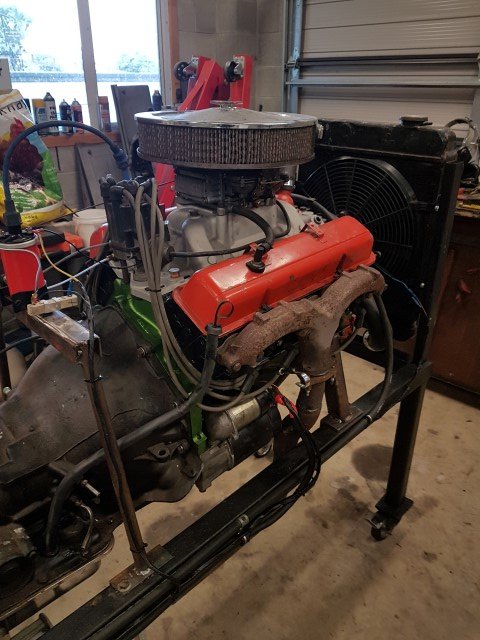

    Getting mine ready to try out as well. Nothing fancy and less than $30 invested. (casters) The engine stand could get the engine mounts cut off it and become a base for a welding table too however, after the engine is in the car. :rolleyes:
    My 235 has been built a little over a year....it was well lubed when assembled, but it is just time to prime it up with a drill and get it running. Might light a fire under my ass to get the car drivable! IMG_7081.JPG IMG_7082.JPG IMG_7083.JPG IMG_7084.JPG
    GlassThamesDoug and alanp561 like this.
