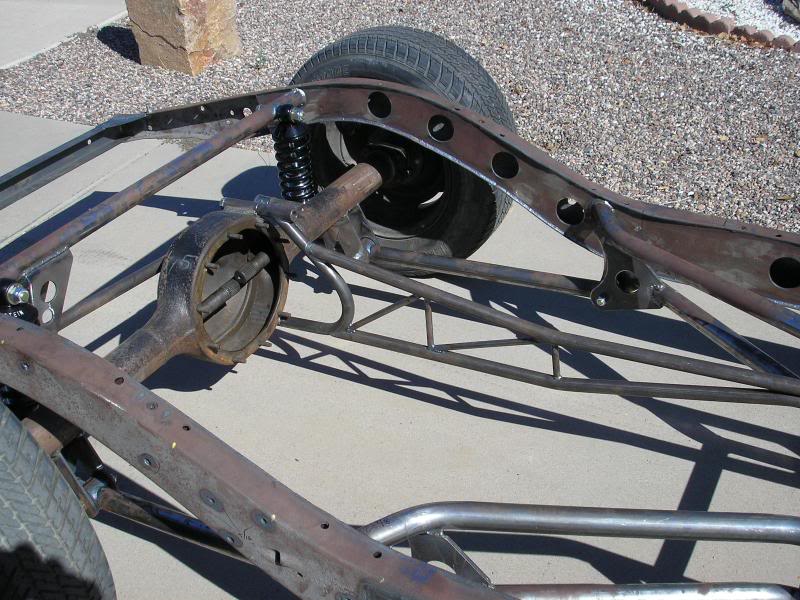

    Her's one example from the HAMB I think. There are lots of different ways .

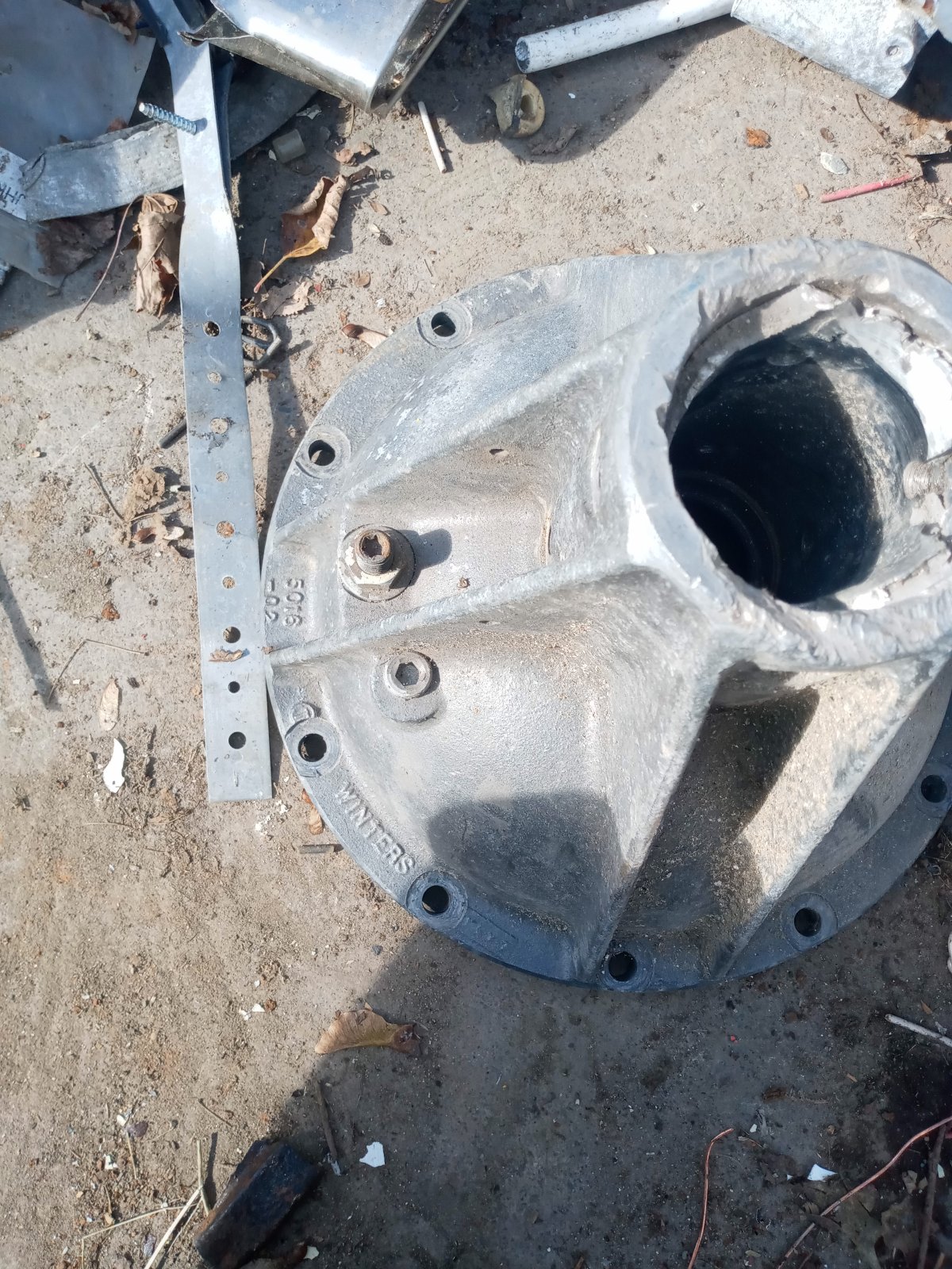

    @hardtimesainit I'm pretty sure by rider bolt he means having a bolt that goes into the rear against the ring gear opposite the pinion to counteract deflection. Often referred to as a load bolt.

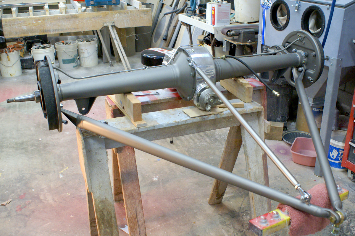

    here's a few of mine on my 40, rear bones split. Theres a load of pics on here iof different setuos.

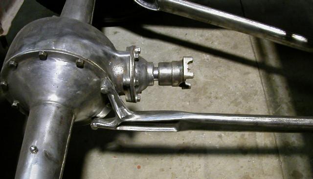

    A bunch of others from here that I saved for reference

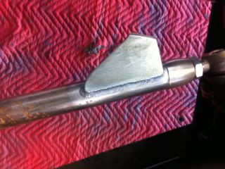

    I did this on my single seater. Its the front portion of the radius rod I heated and bent. keeps the rear end from rotating and adds to the look of an early sprint car.(edit) forgot to say that I cut the cast part off the front of the wishbone where the two bones meet the torque tube and welded it to the rear where it bolts to the top flange bolt F985FF8C-5B9E-424C-8EAC-A2D5C6FBA616.jpeg 6650459C-79F7-4E61-B447-F0F7E12F0C5E.jpeg

    Studebakerjoe is absolutely correct. The sidebolt, usually brass, helps keep the pinion from running up over the ring gear. This is an old dirt track trick that is also commonly found on over the road big trucks as well.

    What a great simple idea for bracing AND repurposing a rear radius rod !! Thanks!!

    @hardtimesainit I may have a tech article somewhere but cant recall where. I took these pics today at work thinking they might help. Both sides of a load bolt on a quickchange bell. 20211018_141332.jpg 20211018_141310.jpg

    Yeah, those pics are helpful ! I suppose that same info for use with iron stock rear ?
    If you locate that article, would be great !! Someone mentioned bronze bolt use. Guess that helps with wear, eh ? What a great idea overall, to strengthen Banjo. Any other great tips to strengthen rear ?
