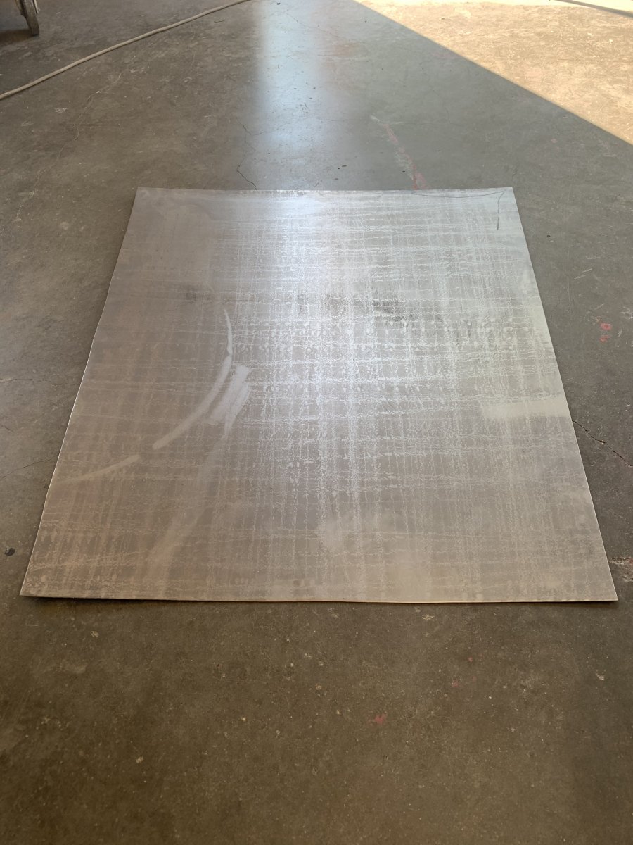

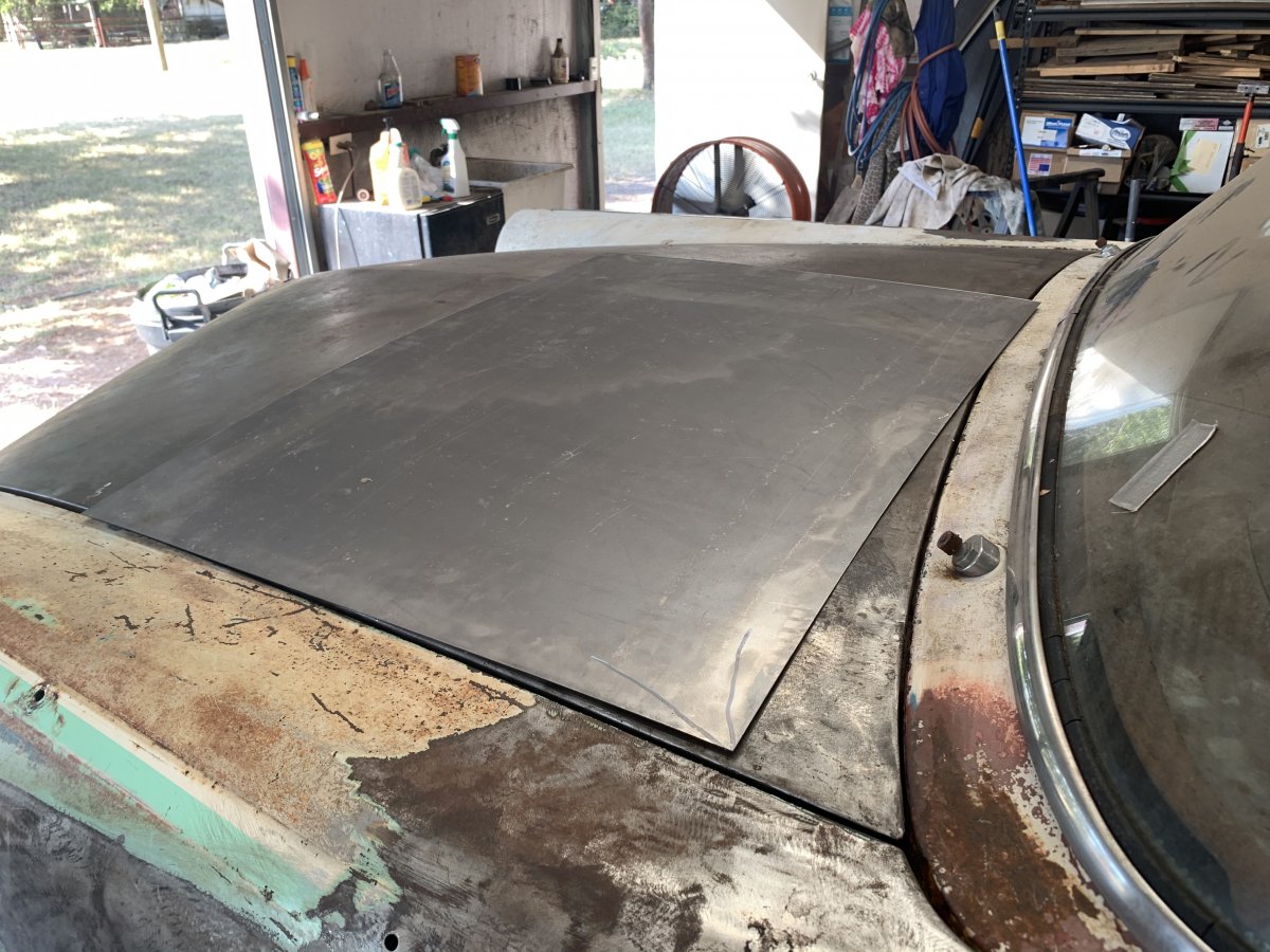

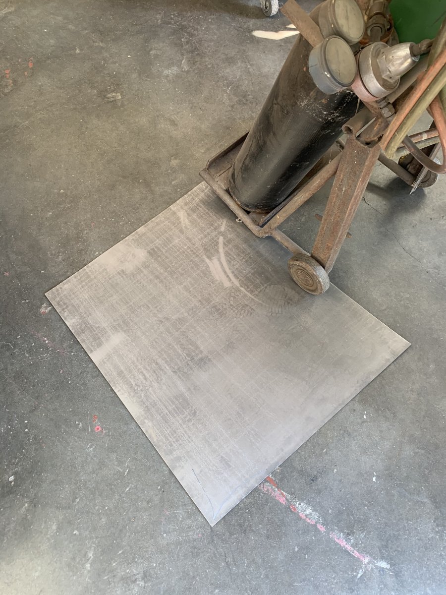

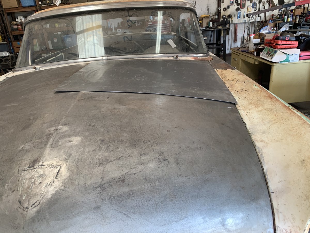

    At the risk of humiliation I am posting my country boy ways of making sheet metal take a shape to match my hood that I’m trying to save. About 5 passes one way and 3 90 degrees the other way. If you look closely at the pic on the floor you can see the edges curling up. DAAA111E-D598-49D6-8EC6-9B75BEAAFC5E.jpeg 741EF3F2-D1C0-4514-9F94-3B9806436C40.jpeg 930AF7EC-B56D-4899-86A5-88E49BA1445E.jpeg 97B3061E-0C39-435F-9E0F-FBB0F4AFD91C.jpeg

    Find something thin mat/rubber, place underneath panel... It'll speed up the process

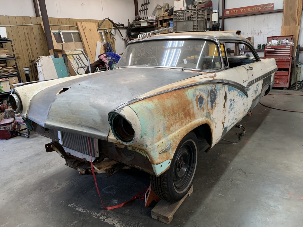

    Put a thin sheet of rubber under it to get it working quicker

    BTW, that gorgeous '56 Vic is worth it! Nice job 'crowning'.

  24. You don't even need rubber- put a layer or two of paper on the floor!
