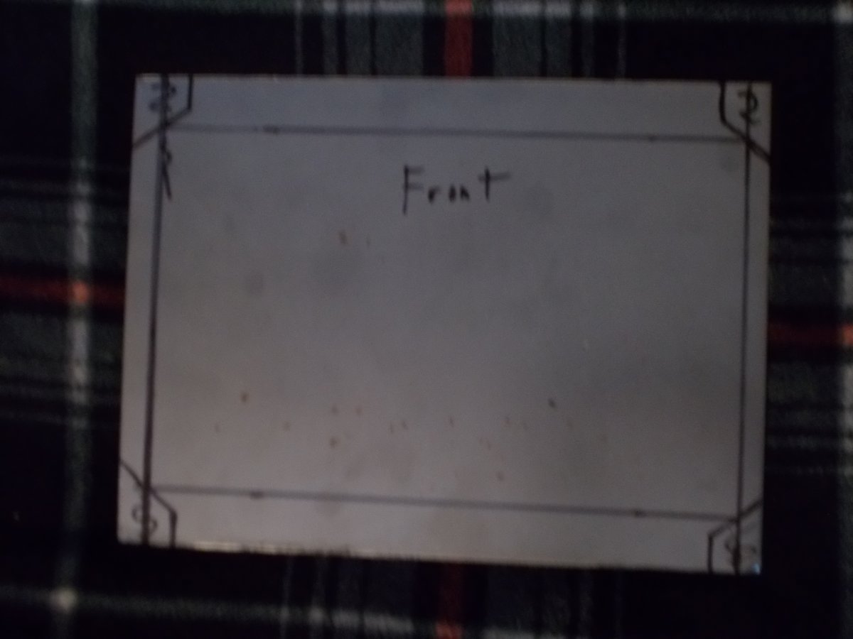

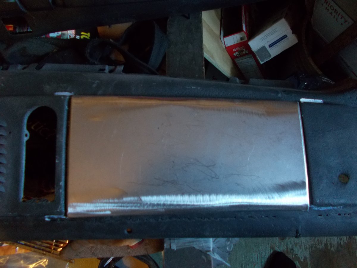

    Got [3] '40 dashes, [1] glovebox door... had some scrap 14" x 12" pieces of sheetmetal,
    measured and cut the corners to fold behind the "skin"... I left the hem at 1", thought I would need it to weld hinges to... NOPE...
    KEEP THE HEM TO 3/8" OR LESS , it will CREASE THE SKIN when you run it through the slip roller...
    marked ;
    cut;
    rolled;

    @sloppy jalopies...looks great...you made it look easy. A couple of things.
    Perhaps for those that are new to this,
    - how did you cut it
    - how did you fold it
    - just a profiling observation the bottom of the door looks to overhang the bottom profile of the dash. Does the door possibly require one more bend to match the dash profile?
    I am sure your going to continue your great tech article but a couple of suggestions which you may be already considering.
    - show hinge fabrication and attachment
    - show lock and or finger pull addition
    Lastly show a side by side with the original as it helps the understanding of how close this is to Henry's version.
    Great stuff and thanks for sharing Sloppy.

    cut with a shear at a buddy's workplace.
    hems were folded on a buddy's 4' brake.
    skin was rolled through a buddy's slip roller.
    Its just a plug to fill the hole... note the lower right dash has been cut and welded, the door bottom may still need tweeking... this was a "wonder if I can" thing... and a new one is just $50.00 ...
    I have 3 dashes, this door will get wired to the back of one and then hung from a nail... might even make another one...
    Also if I were to modify a '40 dash to sell, the buyer's 1st impression often sells the thing...
    having the hole filled really helps.
    When he tries to explain the purchase to the wife the more complete looking the dash the better.

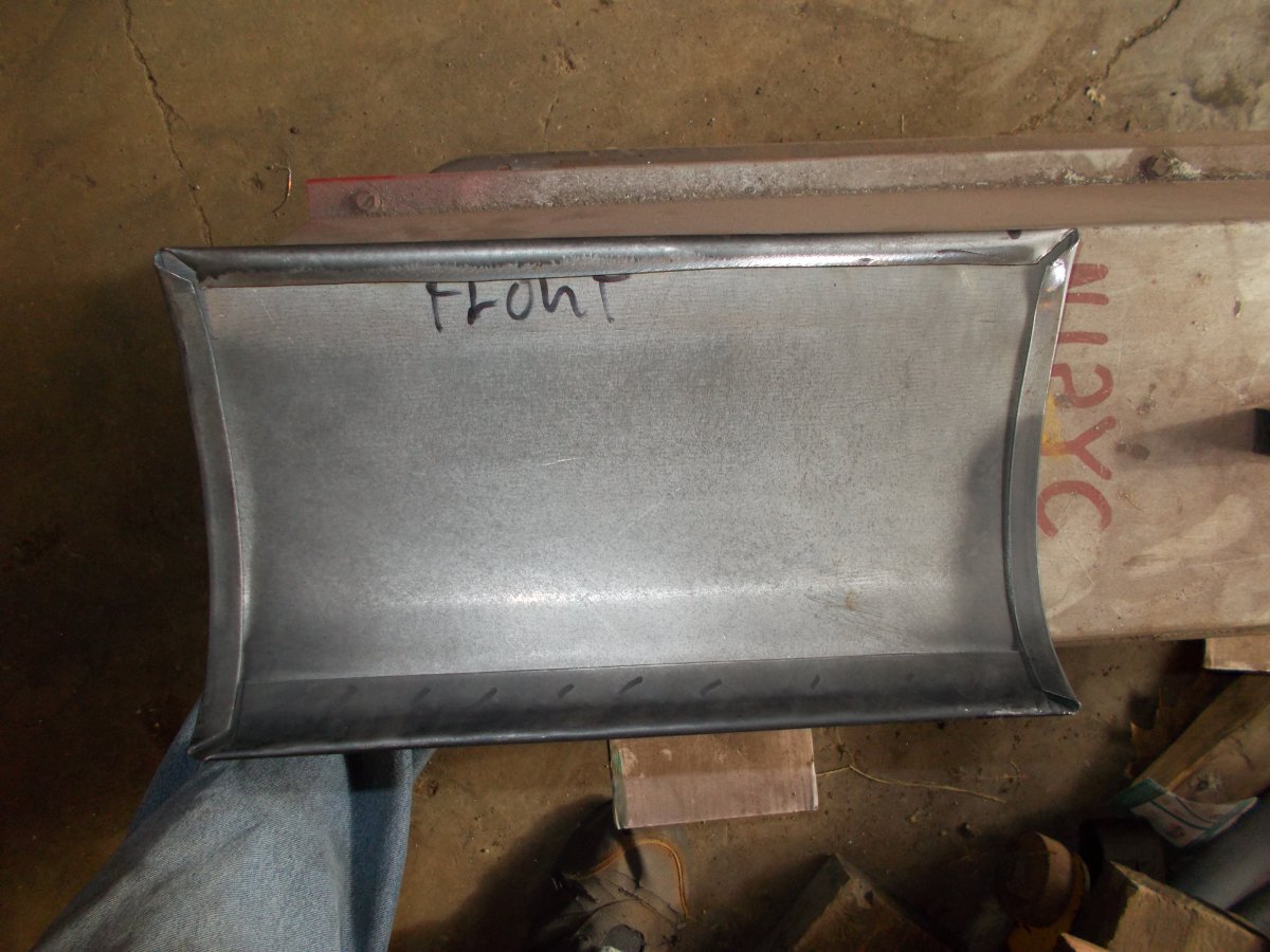

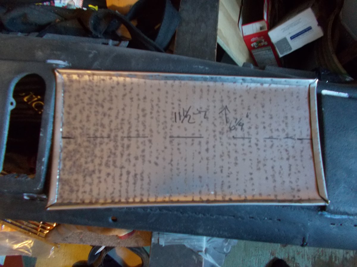

    Cut another [fill the hole] blank, sanded all the edges that will be folded over to help stop them from creasing when rolled....
    also made the hems narrower this time... headed to a buddy's to slip roll them...
    .gonna try and bend a '38-'39 standard glovebox door "skin" only... DSCN2306.JPG DSCN2305.JPG

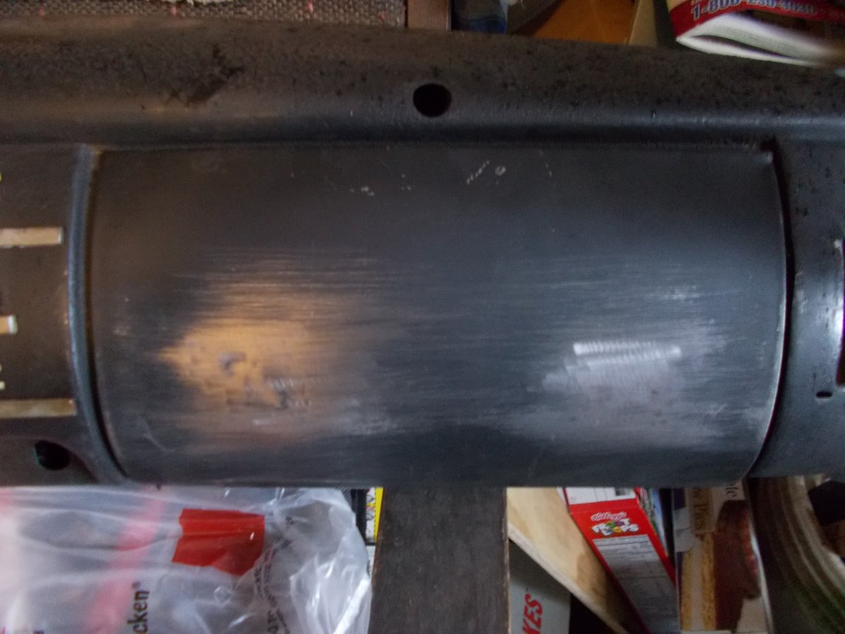

    got them rolled.
    the new '40 ; note the shorter hems, it bent easier. DSCN2310.JPG DSCN2309.JPG
    .the '38-'39 was tougher to roll, relatively flat except for the upper and lower edges... ; DSCN2308.JPG
    Used a 1/4"-20 x 2" screw, screwed 3 nuts onto it, the last one a flanged or navy nut, flange toward the skin, sat it against the edge of a stock g/b door, the 3 nuts are the same hight to the hinge contact surface, welded the 3 of them together, screwed them to the hinge with the navy nut's flange against the door's skin...carefully duct taped the door right where it needs to be, welded the navy nuts to the skin, removed the tape, bingo, and cheap... wish I had an easy fix / swap for the hinge but '40 to '48 cars is the best I can do... DSCN2443.JPG DSCN2441.JPG DSCN2441.JPG DSCN2428.JPG

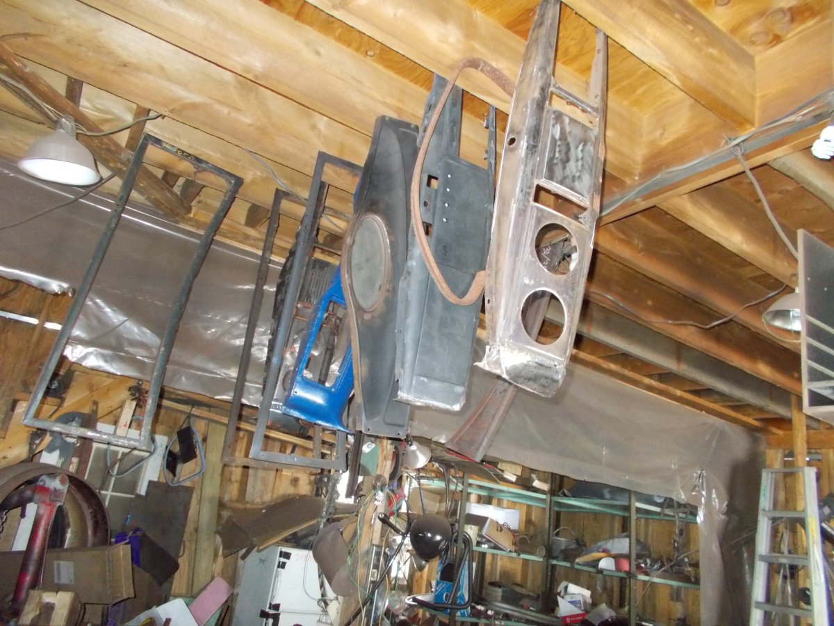

    Feb's sun has started to throw a little more heat our way, time for me to get back to working on my coupe...
    the coupester's parts will go back upstairs till after I get the '30 on the road... see you then...

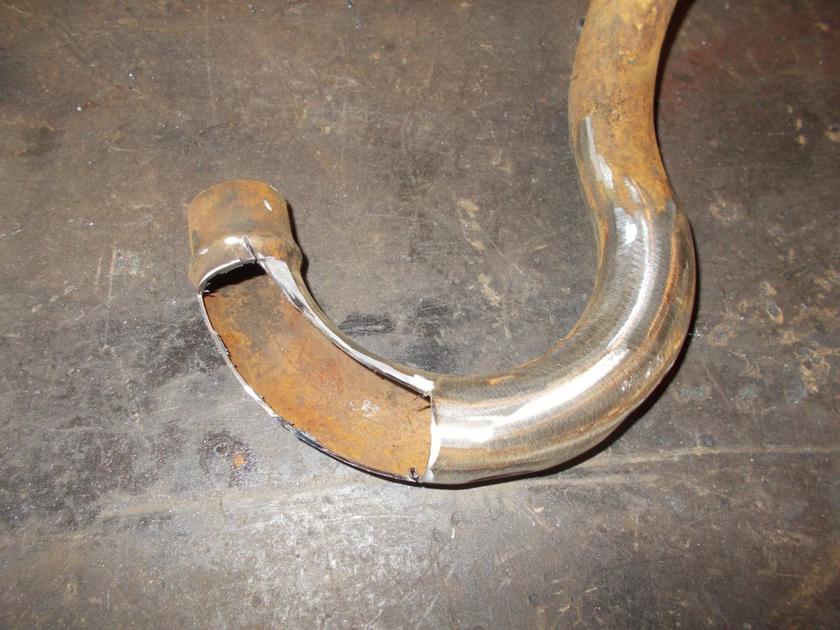

    I liked the '51-'52 truck dash to cowl treatment...
    so I looked for the right size steel tube with a real tight 90*...
    found a flattie road draft tube hanging on a nail...
    welded in...
    in an A cowl...

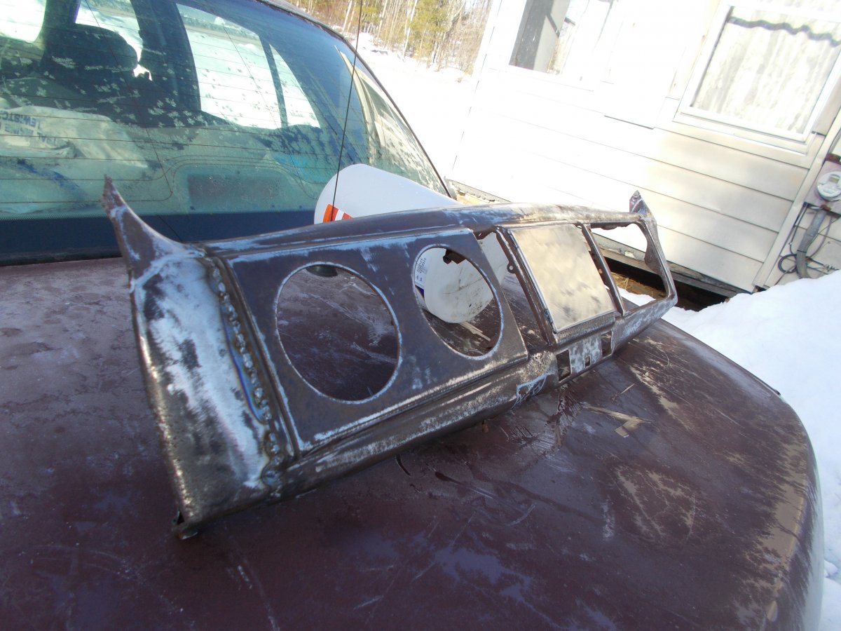

    Decided to run the gauge panel, maybe slide a tach into the left 4.5" hole..
    welded it in, added the curled sides to sort of hide the gauge sides / wires... DSCN2840.JPG DSCN2841.JPG
    tried to keep the little reveal around the edge but the last couple inches got hot... 4 holes for '41 super deluxe grill script.

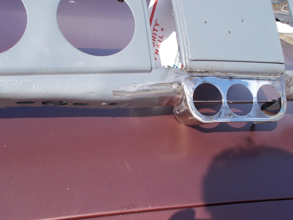

    sloppy jalopies

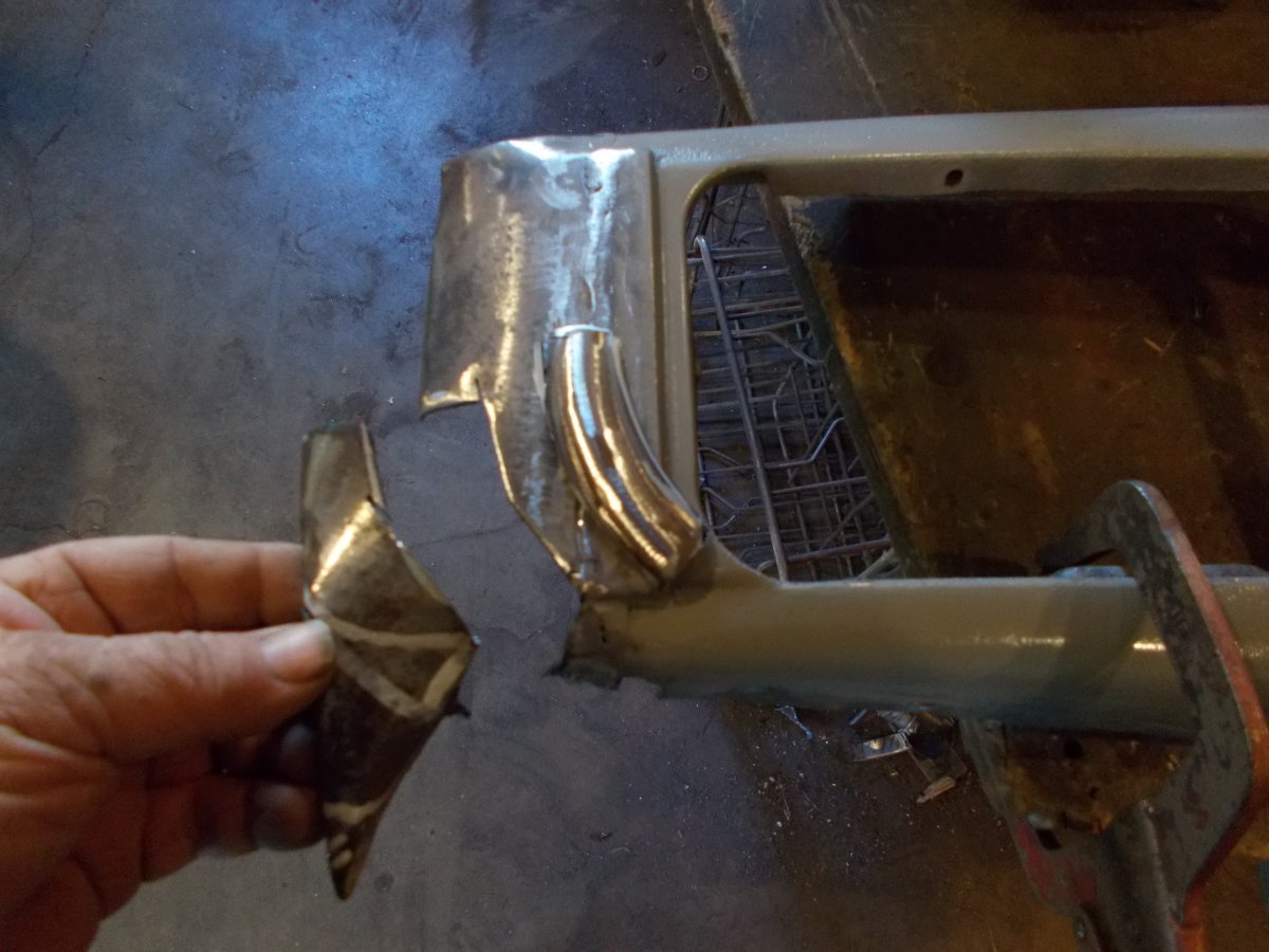

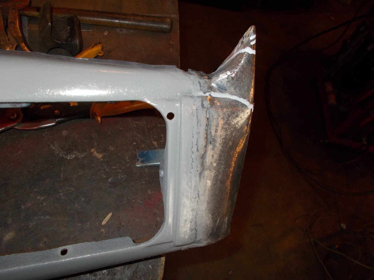

    Can't leave 'em alone... '38 convertible or woodie dash... bottom rotted off... twisted...
    the leftovers [armrests] were welded to the lower edge as it rolls under and out of site...
    .welded and has the upper corners flattened to better match the A's dashbar... DSCN2865.JPG
