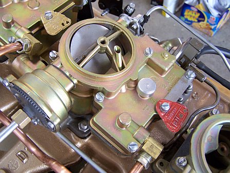

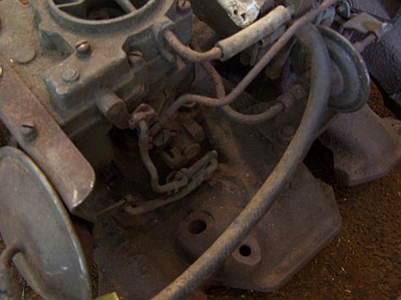

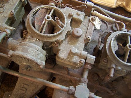

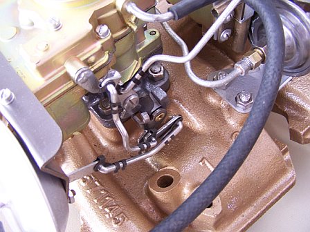

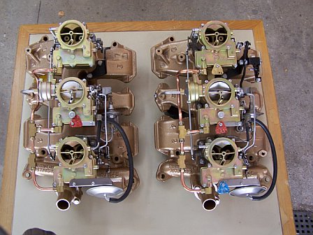

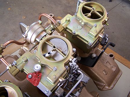

    I just finished up another 1957 Olds J-2 set up.
    Here are spoem before and after pictures.
    Just when you think it's too rusty and too far gone, stay one her, she will come around.

    J2 setups with the factory vac secondaries, vac switch and all the weird linkages are near impossible to find in a barn condition.
    Most of them seem to now have non-tripower carbs and mech linkages.
    Since you know J2; .. The "export" solid lifter J2 with dimpled rocker covers.. why was it named export, and how was it available? off the shelf in pieces, or factory installed?

    Hello: From what I hear the "J-2 Export" version was for racing use in drags and NASCAR, Oldsmobile offered the "export" package for the J-2, consisting of an Isky E-4 cam, solid lifters, adjustable rockers and forged pistons. When they use the term export, I expect they are saying really not use for street use...but whatever?
    The J-2 Export equipment was over-the-counter with factory part numbers. Cars did not come from the factory like this.
    Such engines had dimpled valve covers to clear the adjustable rockers. Isky obtained a pile of these covers, when I say a pile, I mean thousands. They had them chromed and sold them to hot rodders, so finding these covers on an engine today is no guarantee the rest of the goodies are inside.
