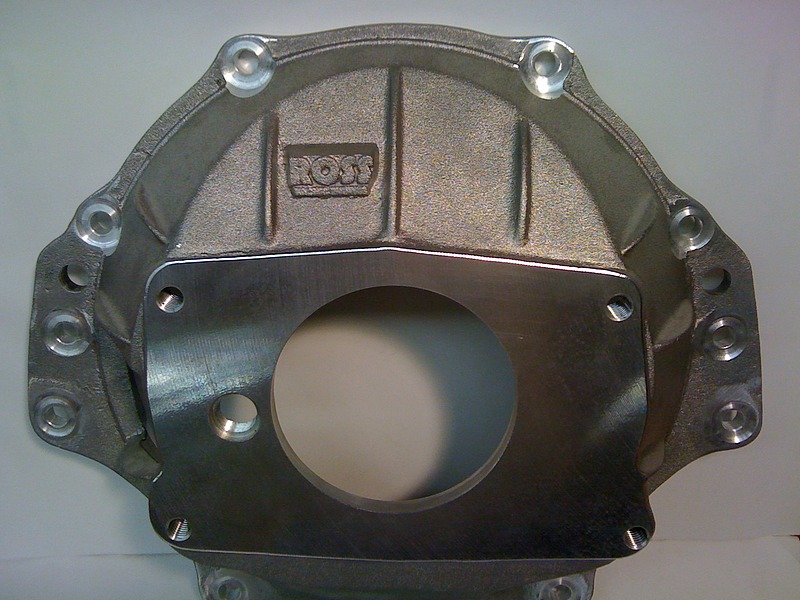

    Check with Ross Racing for a bell and some info.

    I drill all the cranks for pilot bushing when building an engine(if they are not done to begin with)
    Ive got bellhousings/flywheels ect....trans opitions are easy...how much power..how heavy is car 4/5 or 6 speed?

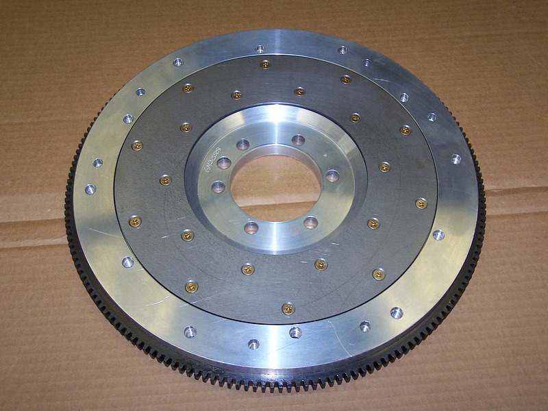

    Do you have a steel flywheel for an early Olds / Cadillac V8? I'm looking for one for my 331 Caddy with a 176 tooth ring gear.

    I have to look...I know ive got a couple steel 145 T.....and I also have high torque starters for the caddy's for either 145 or 176 tooth.

    My 331 is a 54 extended-bell block and it had a 176 tooth flywheel with it's Hydro trans, so it should clear OK. I'm mainly looking for a brand new steel flywheel, not a used one. My trans adapter is a Bendtsen's, for a Muncie 4 speed, but they only sell new aluminum flywheels. A steel flywheel would work better for my 34 Chevy hot rod build.

    Yes you should be good as far as 176 tooth then....we also manufactor new billet alum wheels with replacable steel inserts.....ours are are also drilled for multiple clutch cover patterns. FYI we also do the bellhousings for those engines.

    I'm doing 50 olds with a J2 and a Tremec TKO600 to handle the torque. Be careful with the Bendtsen and maybe the Ross adapters as the Bendtsen unit does not have a provision for the stock rear motor mount. On the olds it is on the Bellhousing. I bought the Bent $1200+ kit and only used the flywheel and clutch parts and tossed the bellhousing. Instead I made a 1" aluminum plate with the muncie pattern on one side and the olds hydro pattern on the other and bolted the whole thing to the hydro bell from the J2. Email me at bspaulding@pacbell.net for photos if you like.
