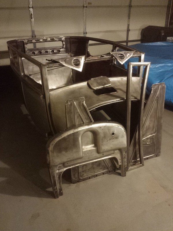

    Well, I should have a lot to report real soon. I've been full steam ahead as I've blown the car apart again and am working on finishing all the small odds and ends I've set up for myself over the entire build. (i.e. finishing small welding areas, making/ redoing patch panels, cleaning up a lot of odds and ends....)
    The frame is currently at the powder-coater and I should have that back as well as a few other goodies next week. I had my axle sent off to Okie Joe for a little TLC with a set of recently acquired round back spindles to have the arms dropped on, which should be ready next week as well.
    In the mean time I've been painting and finishing just about everything I can while I'm waiting on the frame and axle. This weekend I'm thrashing on the doors to wrap them up while everything is out of the garage.

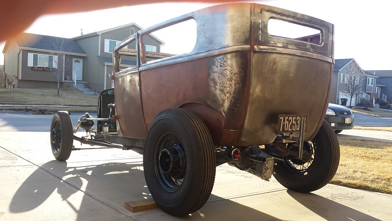

    The plan this year was to get the car on the road in bare metal and tear it all apart next year. Well I've decided against that last week and am now working on trying to come up with a color. A good, economical paint is what I'm looking for something in the early Ford maroon category (monsoon, or garnett; think navarro roadster color as an example. I'm open to suggestions, I just want to try and maintain some sort of "traditional" looking finish.
    I'll be posting pictures of the fun stuff real soon. My apologies on the lack of posting lately I'm attempting to get the car on the road before fall, more specifically end of June, so more like the middle of summer. So I've been a little pre-occupied. However as soon as this hopefully gets a little closer I'm hoping to get back on the build thread.

    Here's the fabrication of the pushbar, or atleast an attempt at one. I used 1-5/8" solid stock and grafted on an original license plate bracket from a '38 Ford so it had the feel of something stock and I can run the old plates.
    The trans is currently under way, I just got the bearings swapped on the main shaft and this should be going together next week. I'm still getting used to these pieces clean and painted....
    Here's the final before tear down showing the fit of the pushbar/license bracket and tail light location. I ended up fabricating a new mount for the '37 brake lights. I thought I had a photo but I don't, I'll try and get one on here as well.
    Current status of the body as of last night. Like I said I'm making passes over the whole thing and fixing the little holes here and there where quit and moved onto the next thing. Its that time now to finish up what I had started.

    Just found (and read) this thread. Great job, especially on your firewall. Looks like a factory stamping with minimal relief rather than the large pile of work I'm sure it really was. Subscribed!

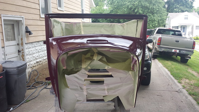

    So over the last few months I've gained a lot of traction and taken off with this whole finishing gig. Here's a bit of a catch up to where we are now....I put a pin in the body work so I could finish the chassis. The idea was I'd finish the chassis (painted, assembled, brakes, exhaust etc....) all installed painted and finished so I could focus on the body for about two weeks. The body was going to stay in bare metal for the first go-round until next year when ideally I would pull it apart post shake down and finish all of the body work and do it right. After being honest with myself and knowing I won't want to pull it apart again I decided to wait and paint it with something quick to at least preserve it until I can get back to it later on and do it all right. (Eventually)
    That's what the plan was until I got into prepping for a to be "quick" paint job. Like I mentioned I was researching how to do a quick rattle can rustoleum paint job as I haven’t had any experience finishing a car more or less a body that wasn't in the best shape; pitted/ stretched/ and wavy sheet metal as it is 80 years old. Then after talking with a few guys around Omaha I decided to take it a little further. Nick (Malcom) told me about the process he used on his roadster and Jason (JHO) offered his assistance to get it on the road. A few weeks later the body had primer/ filler on and was ready for block sanding. Then this last weekend we sanded the body one last time and Jason layed down a killer paint job especially with what he had to work with. I ended up stick with a custom mix of rustoleum paint to get the color and sheen. I'm really excited with the results, just what I needed to get back and get this thing on the road. Thanks again fellas.
    Here's the photos to back up the summary....
    Been wanting to get this shot for awhile.....
    Here's how it sat for a few weeks while I wrapped my head around what was left to get done....
    What follows is what I've been doing for the last few weeks/ nights/ and weekends. All well worth the end results though. If I've learned anything with this build, it's patience.
    This is how I was going to leave the body and use rattle cans to paint it...thankfully I had some nice intervention. It's amazing what a little high build primer/ filler can do. Amazing.
    And the final product. Still in disbelief at how well everything turned out. Painted while it was raining and everything...

    Man....thanks for the update!!! This just keeps getting better and better!!! I love the maroon too...my favorite!! I think you were right to do the body correctly and be done with it. Why do and re-do it again?? You are going to have it on the road I no time. I REALLY want to see this car in person....Keep up the good work, Bro!!
