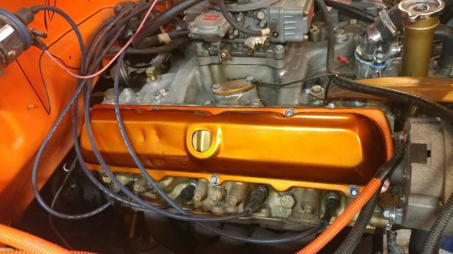

    Been hard pressed to find the correct 5-bolt hole gasket for the 70's Olds 350 in my kustom... have had to settle for more common multi-bolt hole gasket, eventually leaking.
    Anyone recognize the particular year/model of this? Was it just a unique 5-hole model they ran?

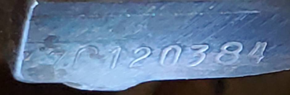

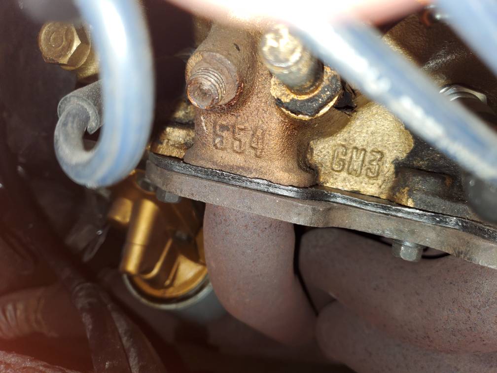

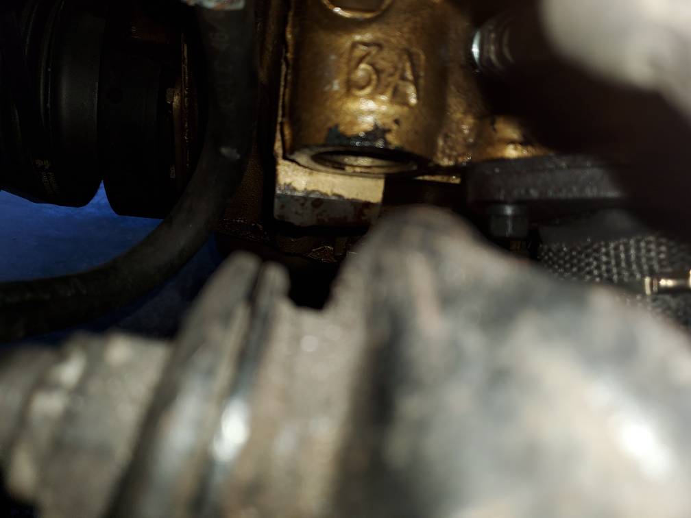

    Went back to the shop to recover stamped ID info... a source online had 3A stampings for 1979 heads, 3rd pic is the engine ID stamp on the flange near cylinder #1 at front left, I believe it's from 1977. Tried a combo of years n models through Summit & Rock Auto, no match for the 5-hole pattern in the heads. Will have to try again for a good seal.
    Oldsman's suggestion is interesting, is it to just screw/fasten gasket to flange/blank 'ear', when it's not over any head metal? 20200712_124855.jpeg 20200712_125248.jpeg 20200712_131051.jpeg

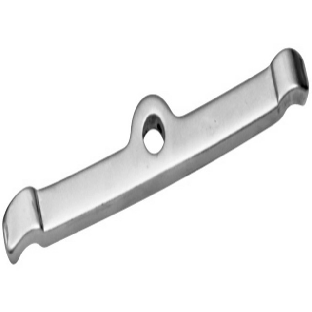

  10. CA383A23-A914-4095-B625-C5F66E4C7E3D.jpeg You may also consider using Corvair valve cover hold downs.

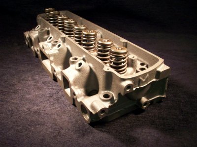

    I'm not really sure what you were looking for, but if you are looking for pictures of heads with 5 valve cover bolt holes, just go to google and search images for
    olds 307 head
    and you should find plenty...I did...
    If you were searching for gaskets with only 5 bolt holes, you probably won't find any.
    The "right stuff" suggestion above is probably where you'll end up. Sorry. Although I'd see about trying some Fel Pro cork 10 bolt gaskets, if you can get them. rockauto lists them, 5 bucks a pair, plus postage.

    Not only are there no bolt holes in the head, the bosses needed to drill and thread them are not there.

  16. squirrel
    Joined: Sep 23, 2004
    Posts: 47,841
    squirrel
    did you see that picture I posted above? late model junk heads....they quit putting the holes in them, and the bosses for the holes.
