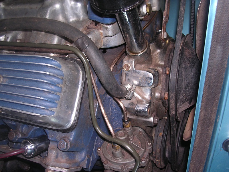

    Ok, here's my heater connection points. Bear with the dirty motor, I'm busy :)
    Anyways, I recall maybe two posts on hamb, about Big Block Chevys either needing some heater hose at rear of head or intake, or NOT to put one there? It was something to do with overheating on BBC
    There is a shut off T handle valve at the rear hose. I never ran it closed. The heater bleeds automatically, never needed to bleed the lines. I tested the heater during yesterdays tests, it certainly is not air bound.
    When I get to it, I will shut the valve off, in case this is some sort of weird issue. Just wanted an opinion. That is a 49 waterpump/timing housing, with a 55 324 pump. I know I looked at the impeller for decay, none. Are these parts any different for compatibility? I doubt it
    ^^^ Is that the right spot? I see an undrilled larger boss on this 49 housing.^^^
    Bummed out with 7 days left on temp plates, and I only got to drive it one mile before we switched drivers to get more weight off the right rear. Like winning the lotto, getting the check in your hand....then wake up from a dream and can't remember how good it felt.

    Heater hoses look right.
