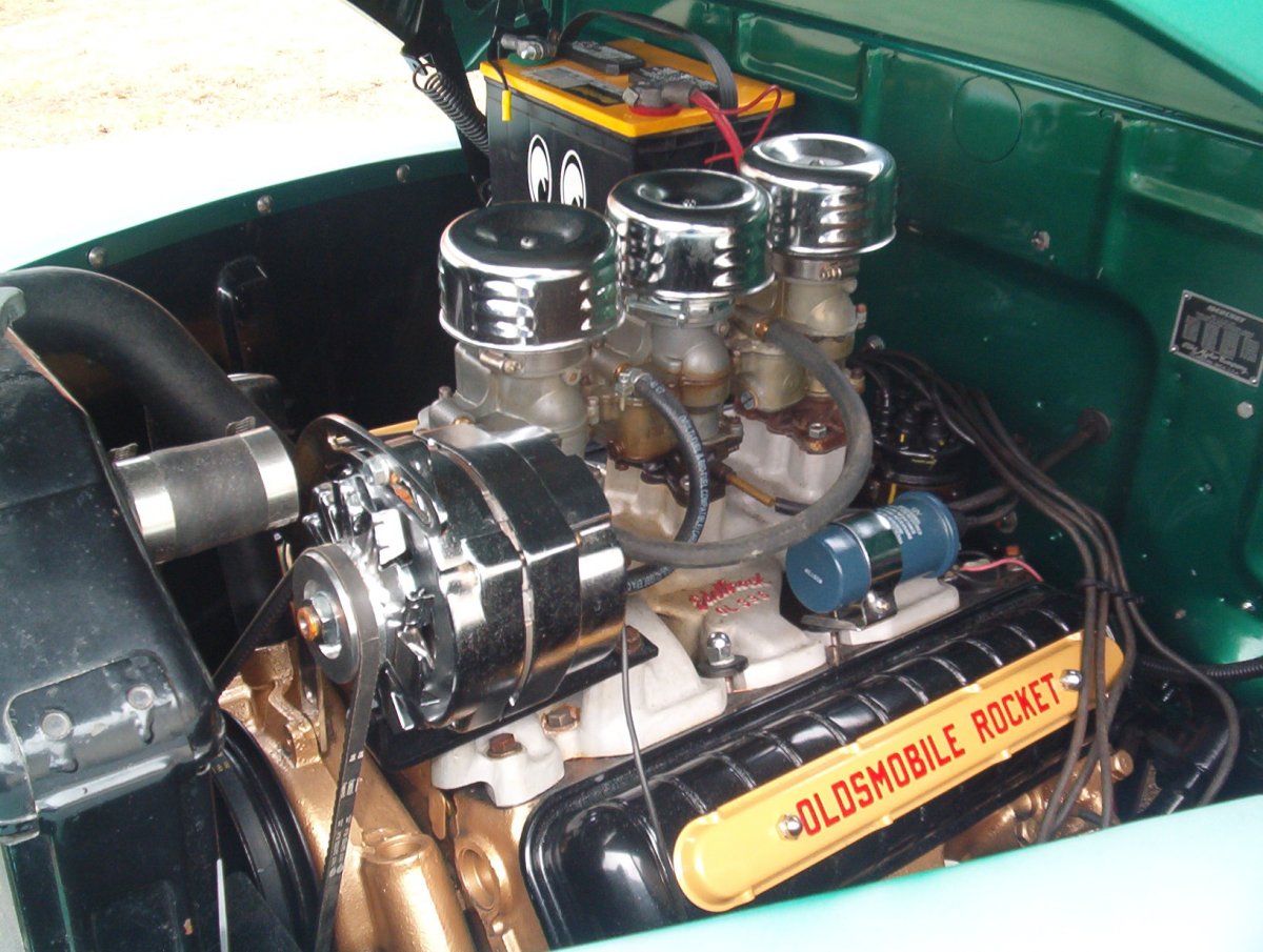

    We like old timey hot rods here... here’s my 40 with a 331 caddy [​IMG][​IMG]

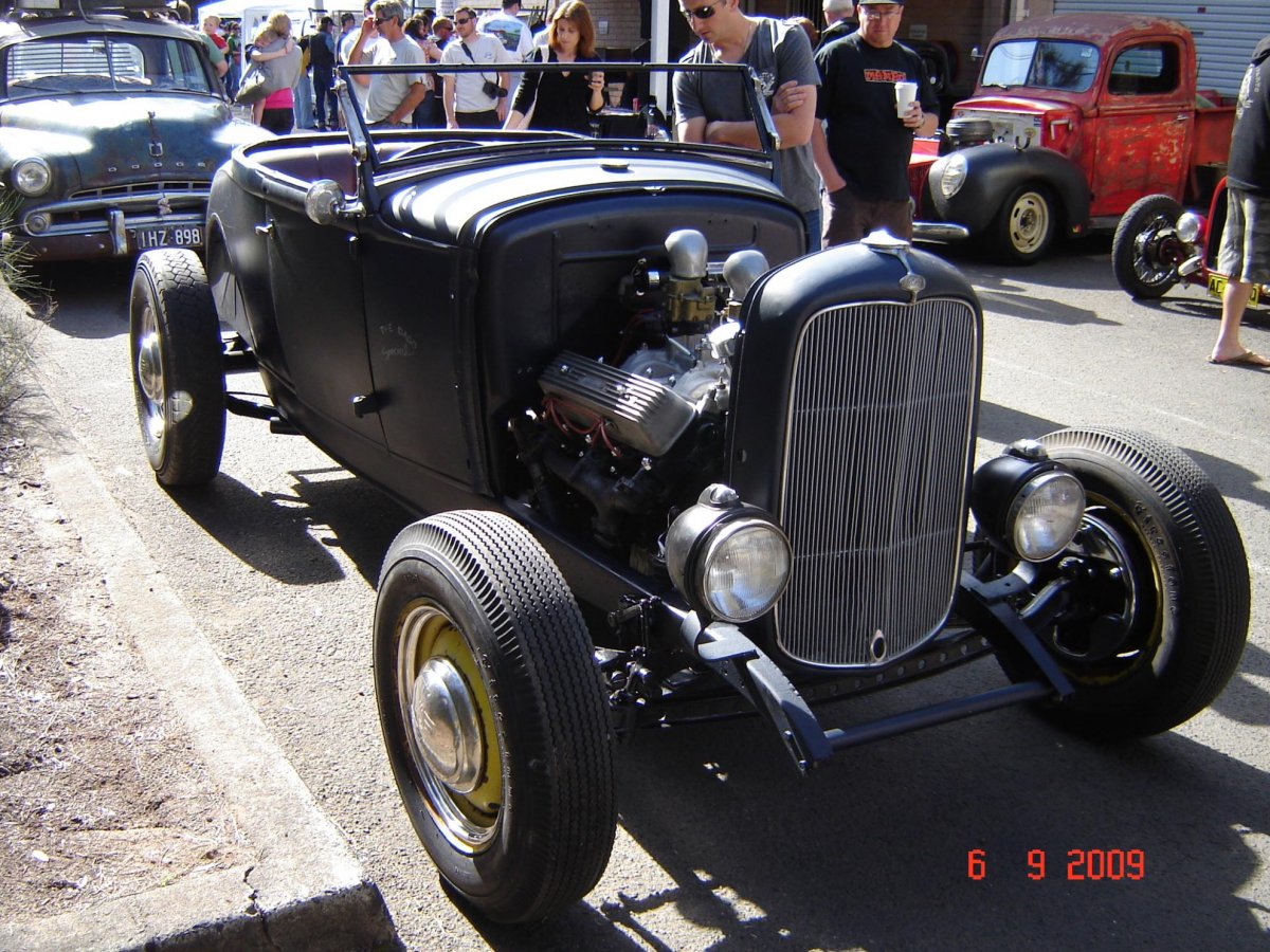

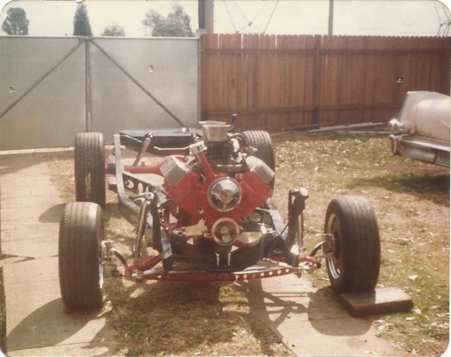

    303 & '48 open drive column shifted in my roadster . DSC05189.jpg DSC05189.jpg img0790eg.jpg
