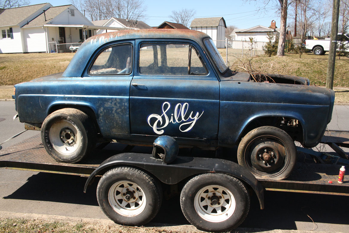

    its not gonna be a daily driver. it will see the strip some and some local cruise ins its a pretty cool ol car . im still in the undecided part i want to start soon tho plan on building it when i get my income tax back id like to have the mashine work done by then so all i hafta do it slap it together . im not gonna buy a crate motor i worked in the speed shop bussiness for quite a while the last one had a mashine shop so i know what went into them create engines. i like the olds motor because its differnt i just dont know if i can get more bang for the buck with the small block uggh decisions decisions . what ever it will have its gonna be a scary ride motor is moved back and it dont weigh much . ill proubly use the olds unless i find some missing pices for the small block cheap i like differnt ive see some of the cars around here but never one with a olds and it moved back like this one for anyone who hasnt seen the car heres a pic
  18. repoguy
    Joined: Jul 27, 2002
    Posts: 2,085
    repoguy
    wow....that thing is insane.
    very cool.
  19. oldspert
    Joined: Sep 10, 2006
    Posts: 1,256
    oldspert
    from Texas
    With that much engine setback, you must be driving from the back seat. The Olds might give a you a wheelstander, if you can get it to hook.

    LOL! that thing would be WILD! .....does it run as is? give it a shot with big olds...you will never get the grin off youre face.
    run the J heads...with a liitle work they can be as good as any other olds heads...
    hows the chassis set up on it?
