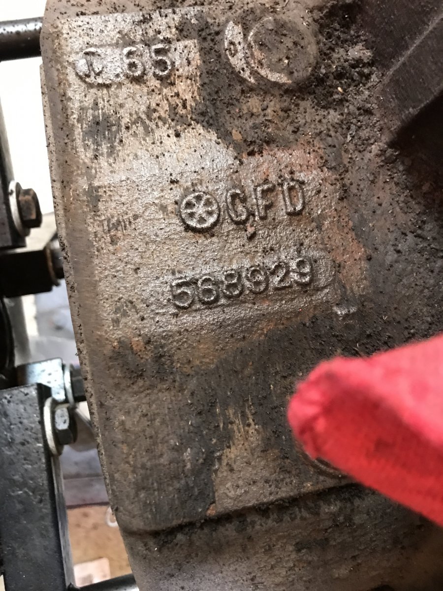

    8B69030E-FA22-48D4-8D15-D2A00B0787BD.jpeg I am cleaning up a olds 371 I have and want to run. It’s looking pretty decent and just want to run the numbers but didn’t seem to find any info on the block number.
    Block number: 578929
    I guess I’m just wondering if anyone knows anything about the numbers. It had a 4barrel on it and my J2 tri power intake will fit in it also. So I’m just assuming it’s a 371 I would just like to narrow down what exact year and if you can tell what model it came out of.
    Thanks HAMB guys

    look for the stamped number, I think it's near the top of the block, on one side below the head, might take some searching.
  3. might be on the DS at the center exhaust port under the head. Should be a tab there with the ID #. What is the head number cast in the head at the center exhaust area just below the valve cover?

    The 57s are all the same no matter how many carbs it has. 58s are same except the front main bearing.

    The engine number will identify it as well as casting numbers
