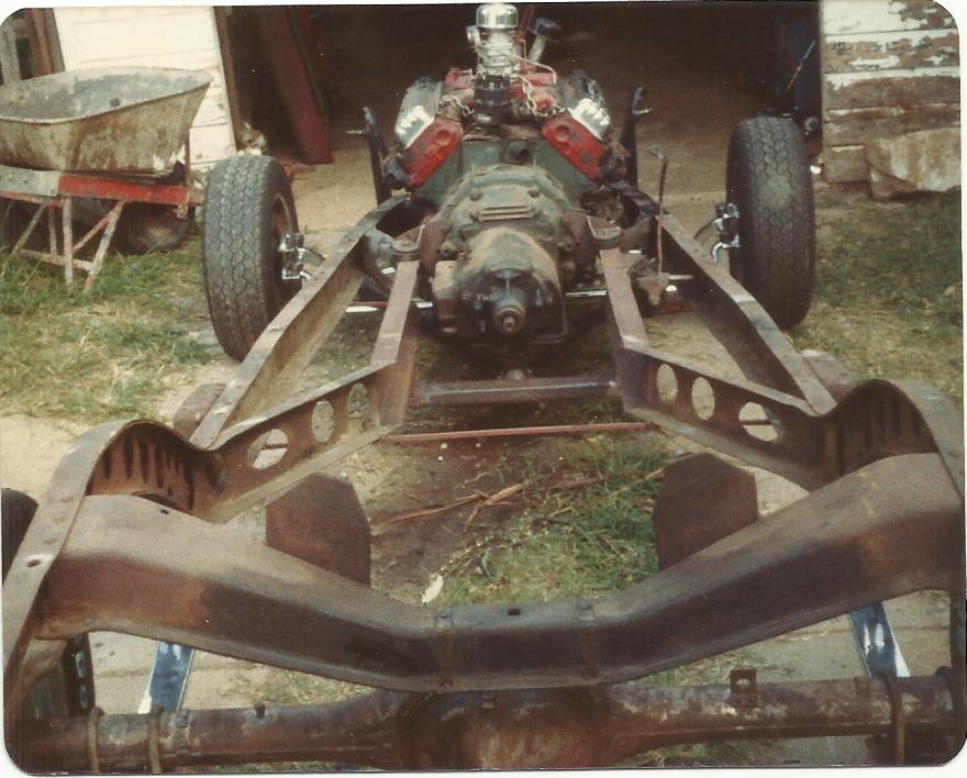

  3. Likely will be some significant modifications necessary to install the hydramatic. Is it an early 4 speed hydro? Probably worth the effort.
  4. My 34' coupe has a 371" and I ran a B&M Hydro the first several years I raced the car. The center of the X will have to come out. I boxed the rails and what I saved from the X and made a trans mount that attached to tail shaft housing bolts. I'll try to find the pic's I took back then.
    These pictures will give you an ides of how I re did the X and made a cross member for the trans mount. Also I "straightened" the cannel in the rear cross member and used a 40' rear spring.

    Thank you very much for the answers and pictures.
    F&J i have change to open drive with 35-6 bones, it was a bare frame when i found this project. And here in my part of world it can sometimes be difficult to find parts.
    550Coupe this helps me a lot. Where do you have the master cylinder? Is it on firewall ?

  7. Glad I could help. Since I only needed a brake pedal and no clutch pedal I used 40'-48' Ford pedal assembly with adapter (you can make your own ) and Ford pickup master cylinder (drum to drum, no disc brakes ). You can't see it but I made kind of a wedge mounting surface on the inside of the frame rail where I mounted the pedal assembly to get it square in the frame. I'll try to find more pictures and post them.

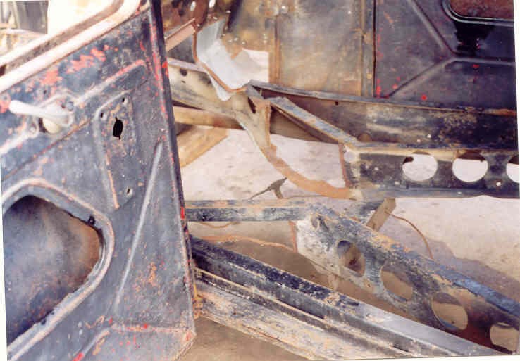

  11. Here's how NOT to modify the "X".in a 33-34....this was my 33 pickup when I bought it. 33bee4.jpg
