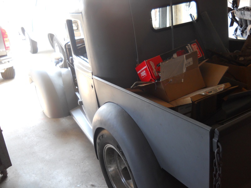

    Dove right into this project... Aside from lights and the key this thing is pretty much complete. Going through parts that need to be after 40 years of sitting.
    Brakes are starting to come apart, gas tank is out (looks pretty rusty inside). Thinking up adapting a new one.
    Came with three bumpers in the bed. I'm assuming the first two similar ones are stock Bantam pieces, but I'm not sure on the top one? Doesn't look like a stock Bugeye bumper either...
    Goal on this resurrection is to be on the road in a month (or at least running/driving decent), with a budget of $1k. We'll see

    That's a really neat find! The builder of this truck took a very interesting approach at doing so. He actually seems to have left the perimeter of the cowl which usually gets cut off when these get hotrodded. It also appears to have an original Bantam radiator for the 5.5 Quart cooling system. The middle bumper in the photos looks to be an original Bantam 4 hole piece which would have been used primarily as a front bumper from mid-38 onward.

    The builder definitely took his time, and put a lot of thought and ingenuity into this little pickup. I'm surprised how intact the body is. It seems to be the original Bantam honeycomb radiator. Not sure how well it will work with the Austin engine since it's for non-pressurized system?
    Thanks for identifying the bumper, now to figure out what the other two are? Hmm..
