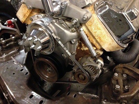

  2. if you're going to hide it why spend the cash for a powermaster? here's some pics of my set up. it a 354 in a 48 plymouth, it should be similar to what you've got. the alt is a nippon denso from an 87 suzuki samari. it came with the v belt pulley.

    Yes there are some very good examples of efficient and small alternators out there that with a bit of juggling will mount down low. I'm using a 90amp alternator that's off a Mazda v6 that's half the size of an original Mopar one on my 63 426 wedge engine and am doing a similar conversion to a 57 dodge 325 engine too.
    I used a small ford one on my 35 Desoto and had to make up a pulley to run a "b" section belt but other than rejigging the rear mount it was a great changeover. To me conversions like this are at the heart of Hot rodding - adapting in stuff to make the whole car work better
