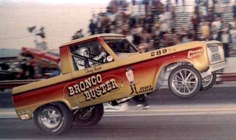

    Doug Nash's 'Bronco Buster'...A PU of sorts. Ran an injected 289

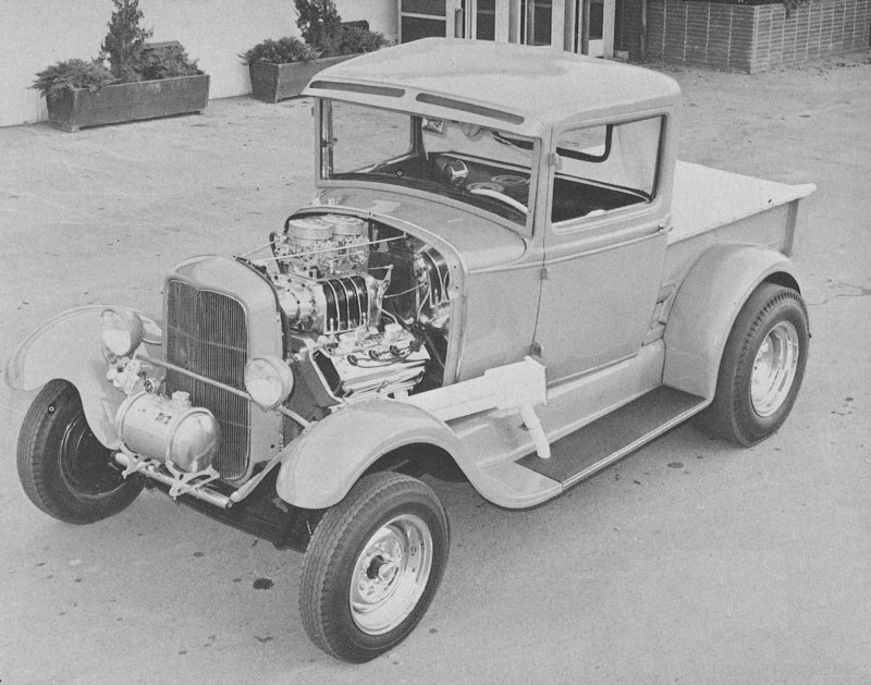

    Not 100% sure it was raced but it sure looks like it could have been! Love the look of this. :cool:

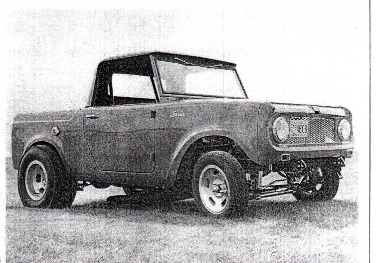

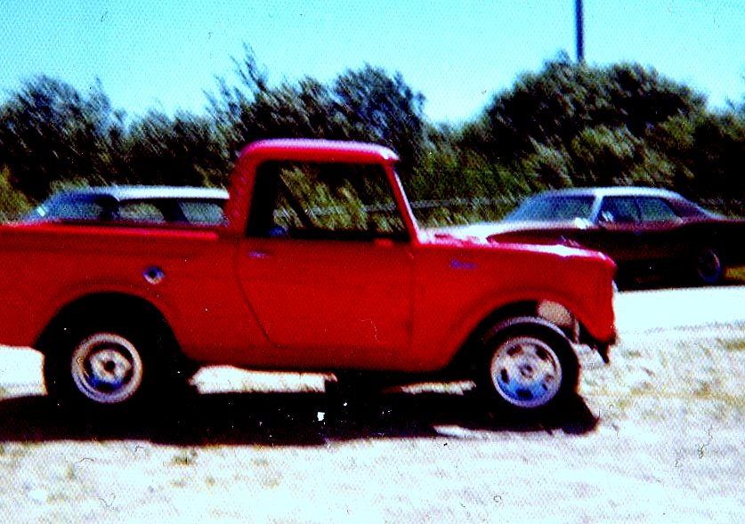

    My Scout back in 1973 and earlier.

    I love that scout man !

    That scout is bitchin.

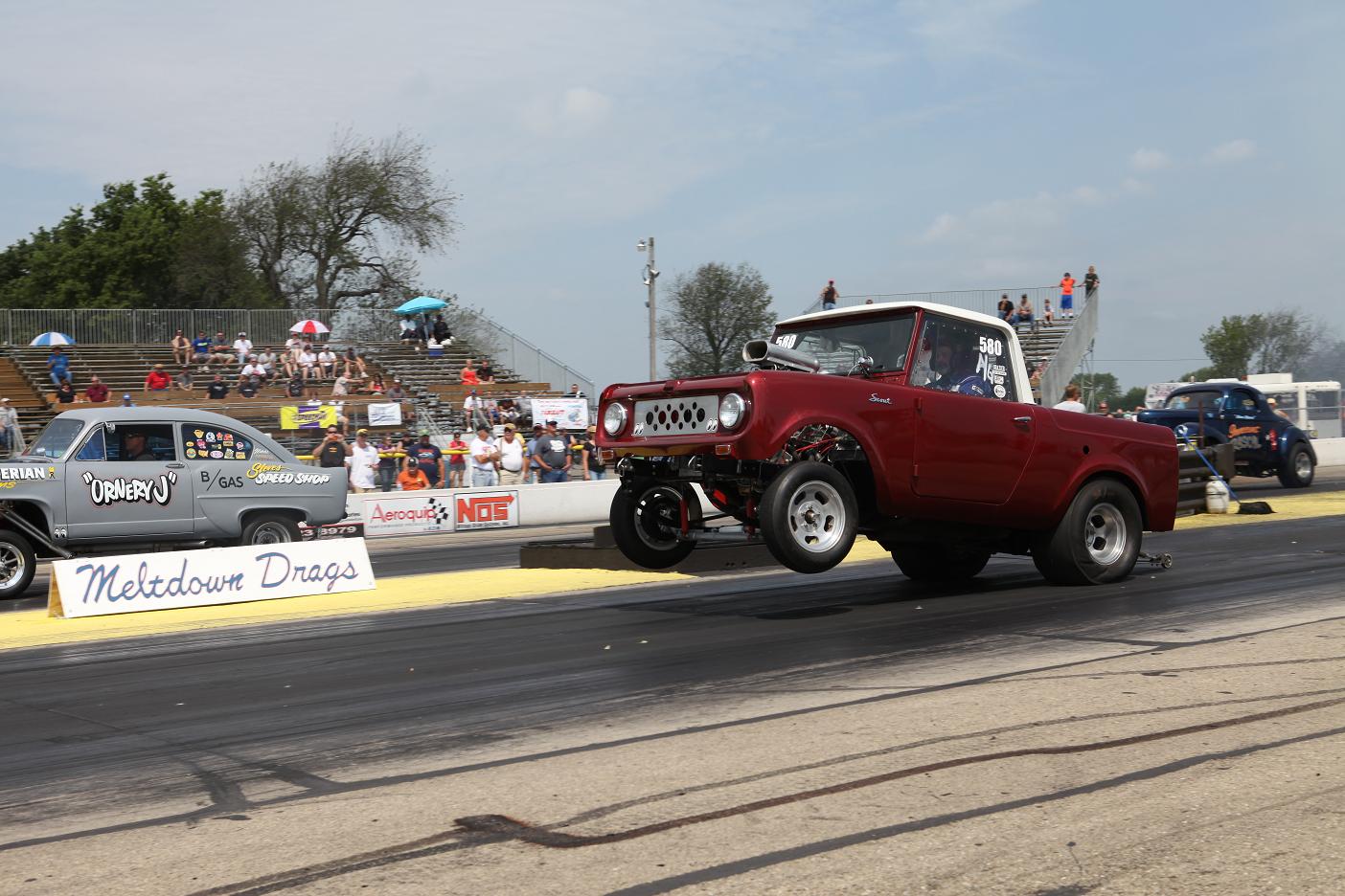

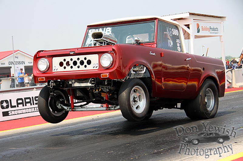

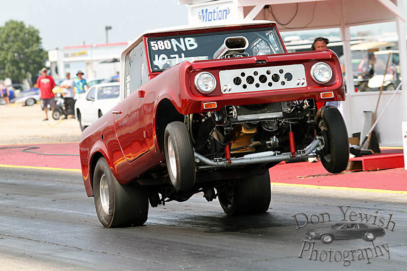

    This is how the Scout looks today

    I've heard a ton of stories from back in the day but 3 always seems to pop up on a consistent basis
    1) Fast as hell when it went straight - best times reported were mid 10's in the late 70's
    2) I saw it going 100+ mph on the (add road name here) with 3 guys hanging off the roll bar
    3) Me and 2 other guys were doing 100+ mph on (add road name here) hanging onto the roll bar
    My resurrection of the Elephant Hunter saw me replace the monster rear springs and Pontiac diff with a modern 4 link and Dana 60. The Scout launches hard and runs dead straight. The first sbc was pretty basic single carb / roller cam 377 but it went 10.69 / 121. Lots more in it as we found a convertor problem and some bad head work. Before we fixed all that I dropped a Dart block 406 with an old school 6-71 in it. The convertor problem still exists so our best to date is a 10.57 / 123 with a soft tune and 6lbs boost. Were hoping the new convertor will push that set up to low 10's and possibly a 9 sec pass . If that all works out we'll swap the pulleys and turn the boost up to about 12 lbs
