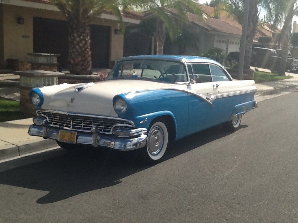

    image.jpeg I drive my 56 Ford Victoria 292 Fordomatic and 3.31 gears. It has radial wide whites. The speed limit in Ca. when it was new was 55 and higher in rural states. I drive it 60-65 on the freeway and usually "clean" it out every time I get a chance (love to hear those dual quads sing) and it saw 90 on the speedo last Sunday morning. I'm smart enough to know it is an old car I don't want to destroy it doing something stupid. The suspension and brakes are stock and perfect. I love to put in an overdrive and may someday. Just drive what you have and keep looking for that 50's cruiser.
