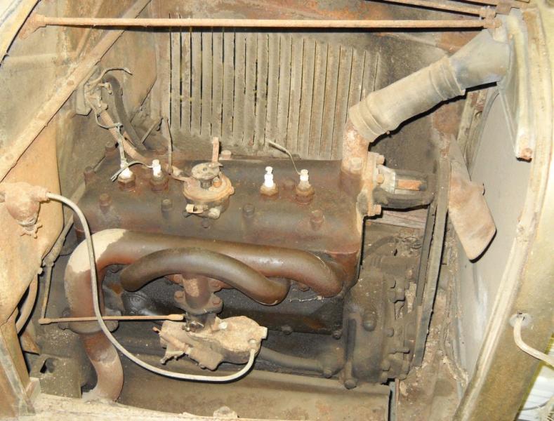

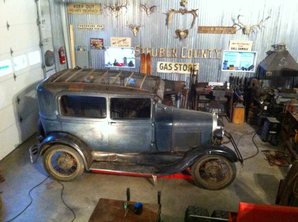

    Found this on the Ford Barn a couple of years ago. Plan is to chop,channel and add a 49 flathead. Rt side Frt A.jpg Eng A.jpg

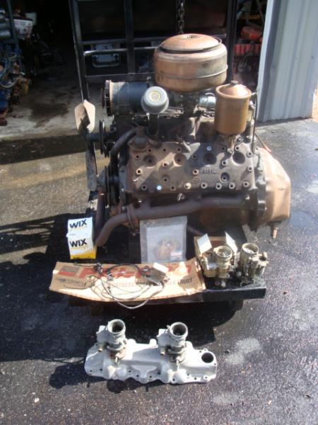

    Found this 49 ford motor also on the Ford Barn it came a Weiand manifold and two Stromberg 97 carbs. DSC00247.jpg

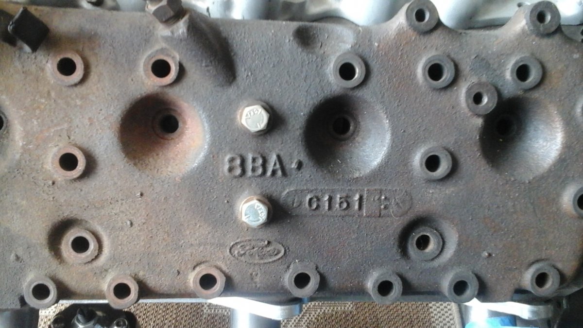

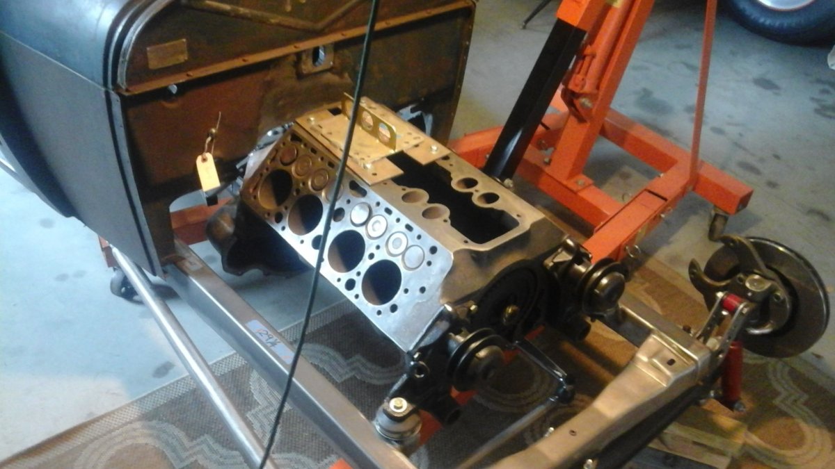

    Been cleaning up the motor and it looks real good so far. Motor is now at Flatjack in Oshkosh,Wi for total rebuild. A 72 ford mustang 3 speed bolts right up to the stock bellhousing . 20170206_125923.jpg

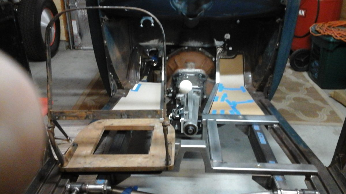

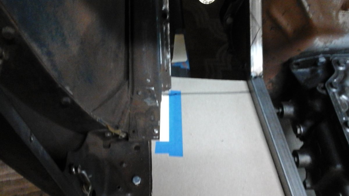

    I inch sq. Tube floor frame is in and starting to figure out the floor panels. Lots of cardboard and tape. 20160328_153557.jpg 20160324_113537.jpg 20160324_115243.jpg

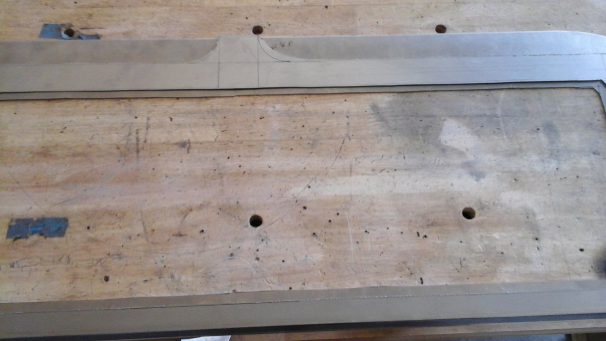

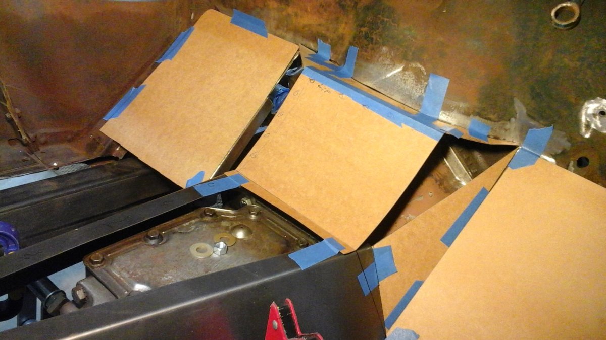

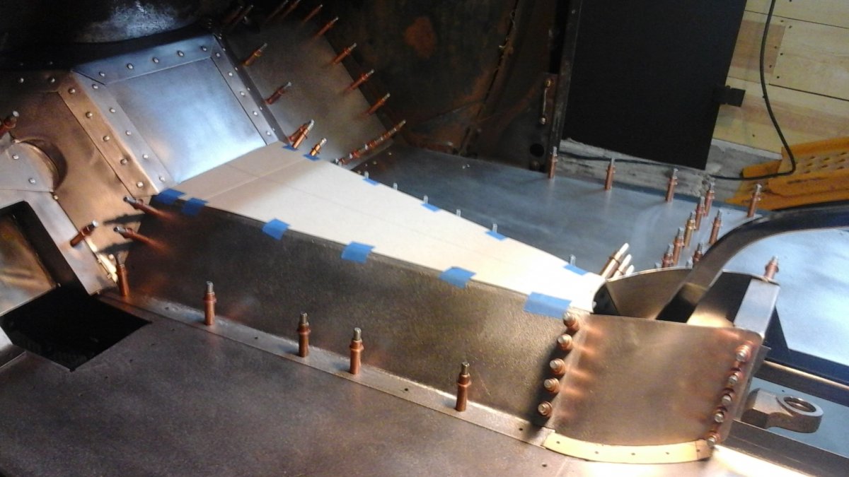

    20161012_121238.jpg More paper paper patterns for the firewall portion of the floor.

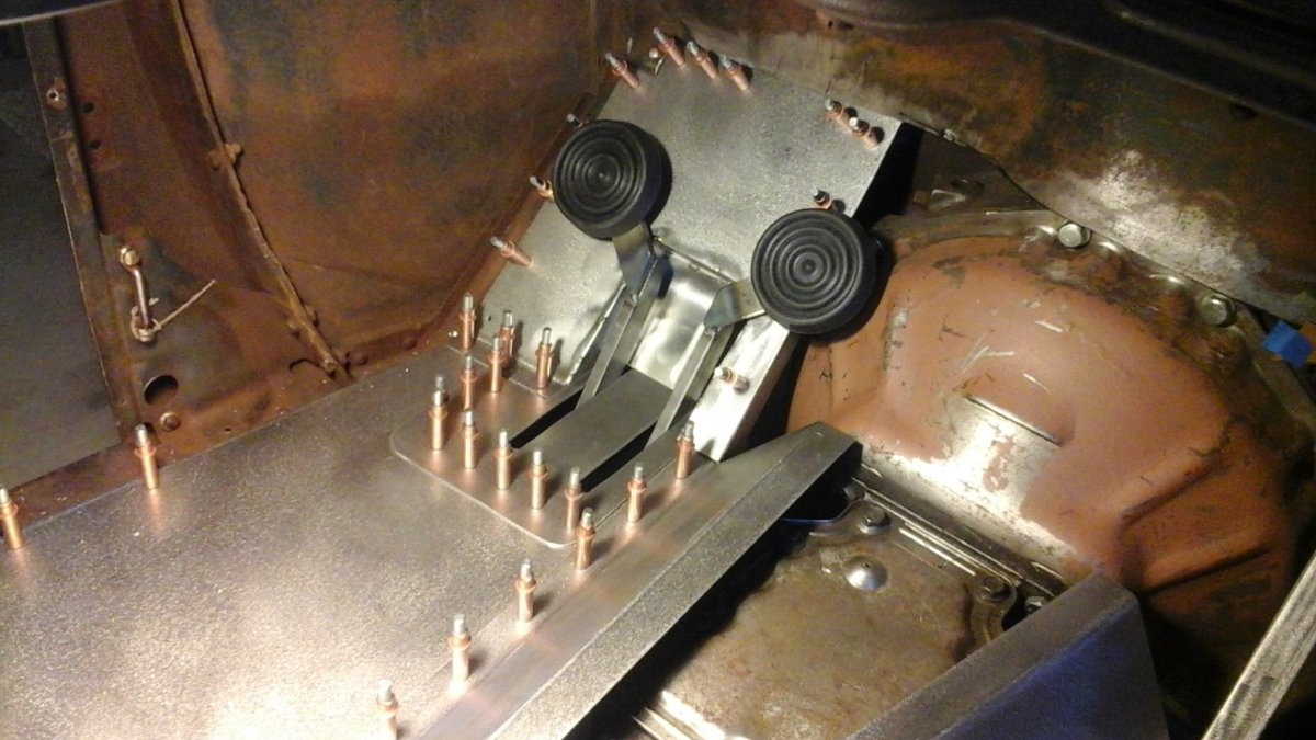

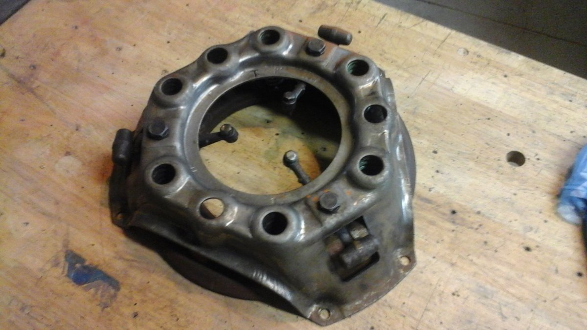

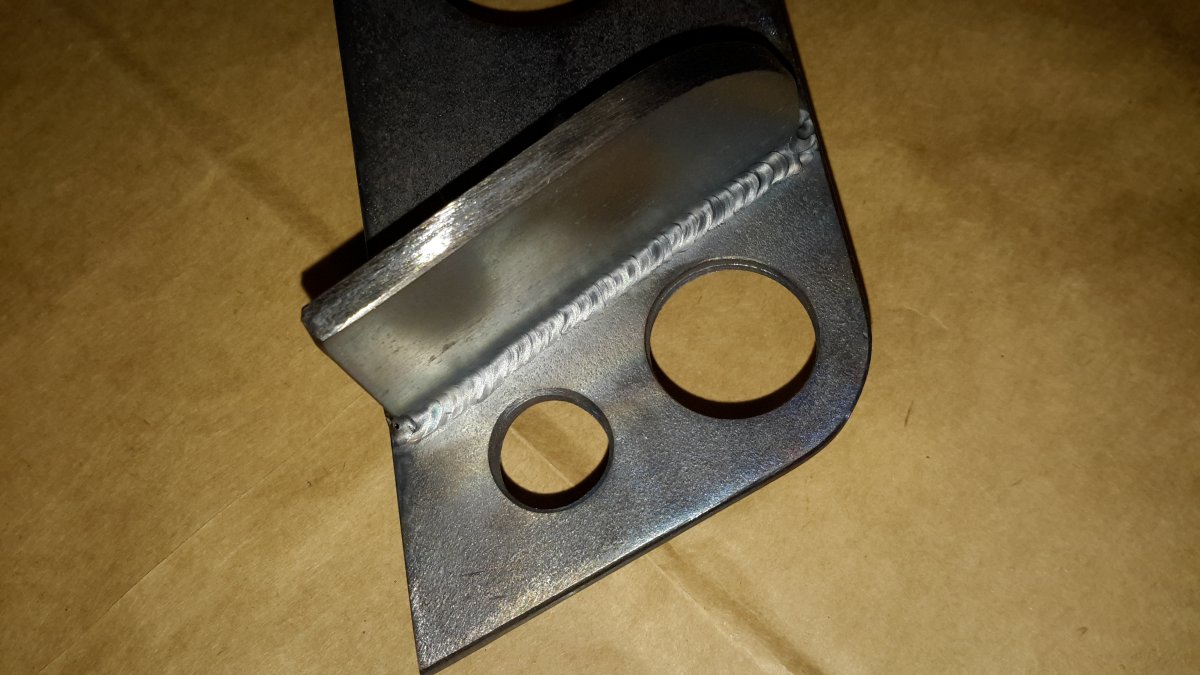

    Finished the brake and clutch set up with lots of help from my brother. 20170825_161706.jpg 20170825_134327.jpg 20170811_121610(1).jpg master cylinder brkt. 20170811_121650.jpg

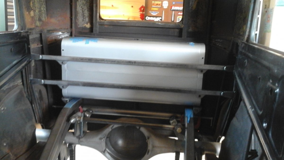

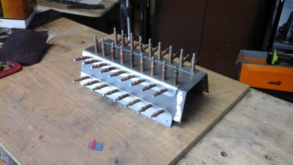

    Made some support tubes out of 1x1 x 1/16 Tube and mounted the gas tank. 20160616_130353.jpg 20160618_114509.jpg

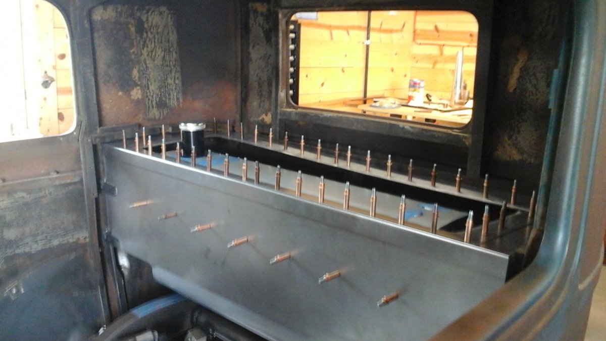

  22. chop job
    Joined: Feb 16, 2013
    Posts: 596
    chop job
    from Wisconsin
    1. WISCONSON HAMBERS

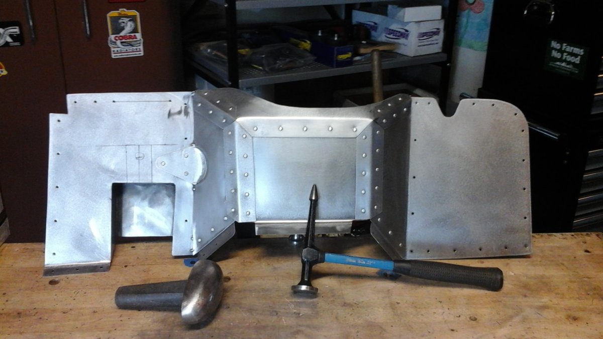

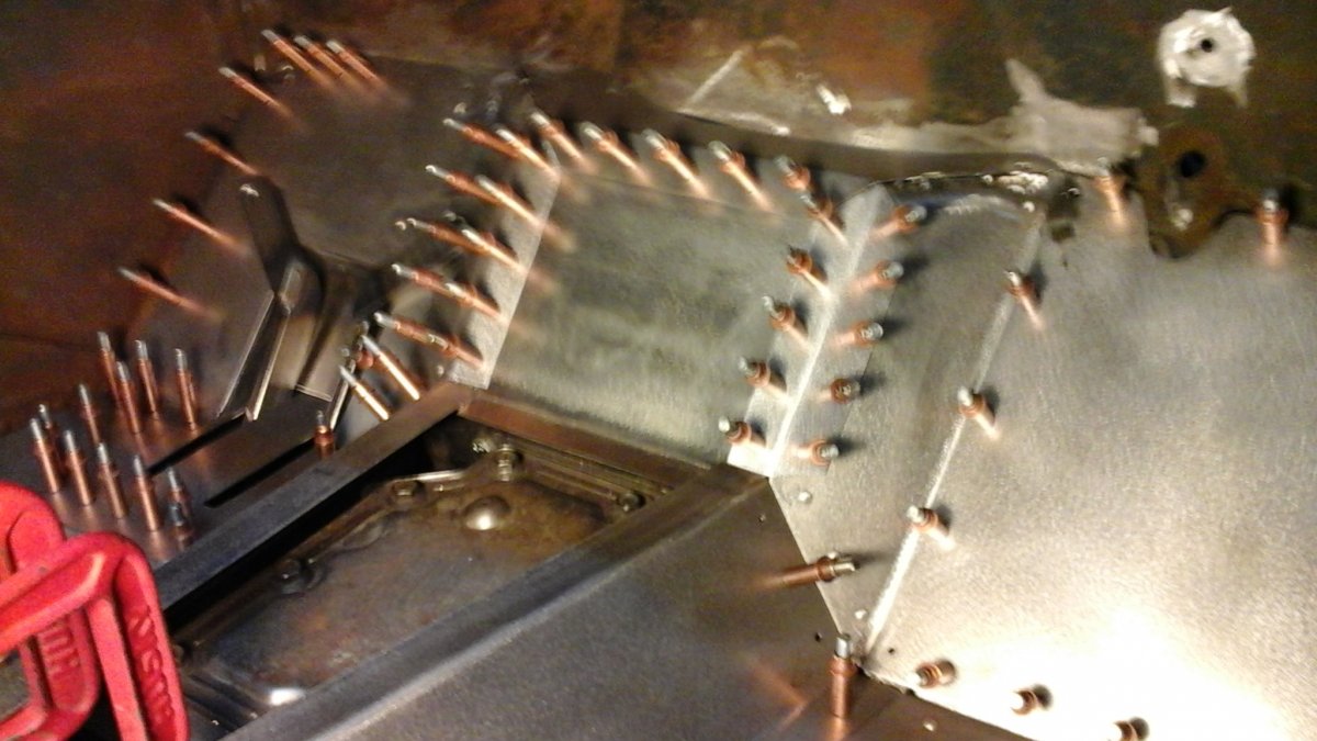

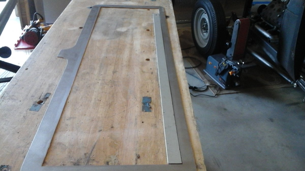

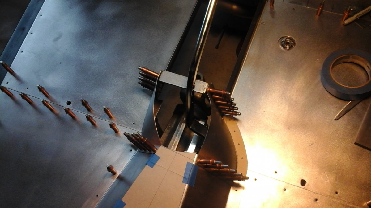

    Started to cover up everything with sheet metal. Want all sheets to be removable so will be drill8ng lots of holes and adding stainless button heads. 20160824_150537.jpg 20160821_104803.jpg 20160824_150729.jpg 20160823_145002.jpg 20160825_122254.jpg

    Its always interested and refreshing observing the build take shape with ones trade or profession wrapped into it all. That has an aviation look happening...great info and visual on your build...thanks @chop job

  25. barrnone50
    Joined: Oct 24, 2010
    Posts: 571
    barrnone50
    from texas
    Very Quality Work you are doing.. Those fasteners are they rivets? Thanks For posting.
    chryslerfan55, chop job and Stogy like this.

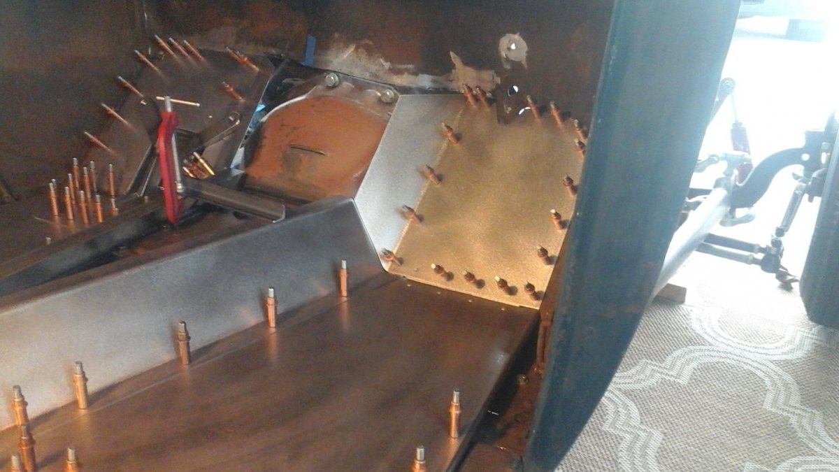

  26. chop job
    Posts: 596
    chop job
    from Wisconsin
    Those in the picture are Cleco fasteners which will be replaced with button head bolts.

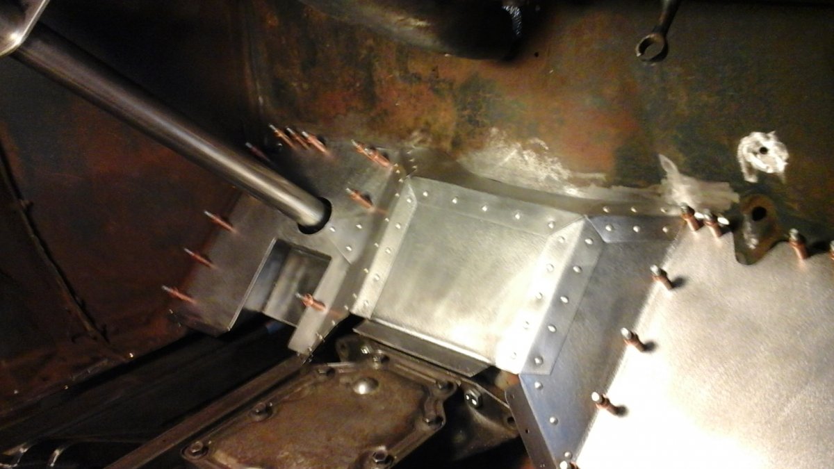

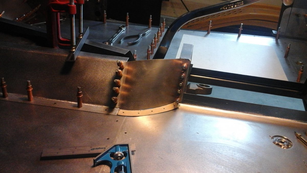

  28. chop job
    Posts: 596
    chop job
    from Wisconsin

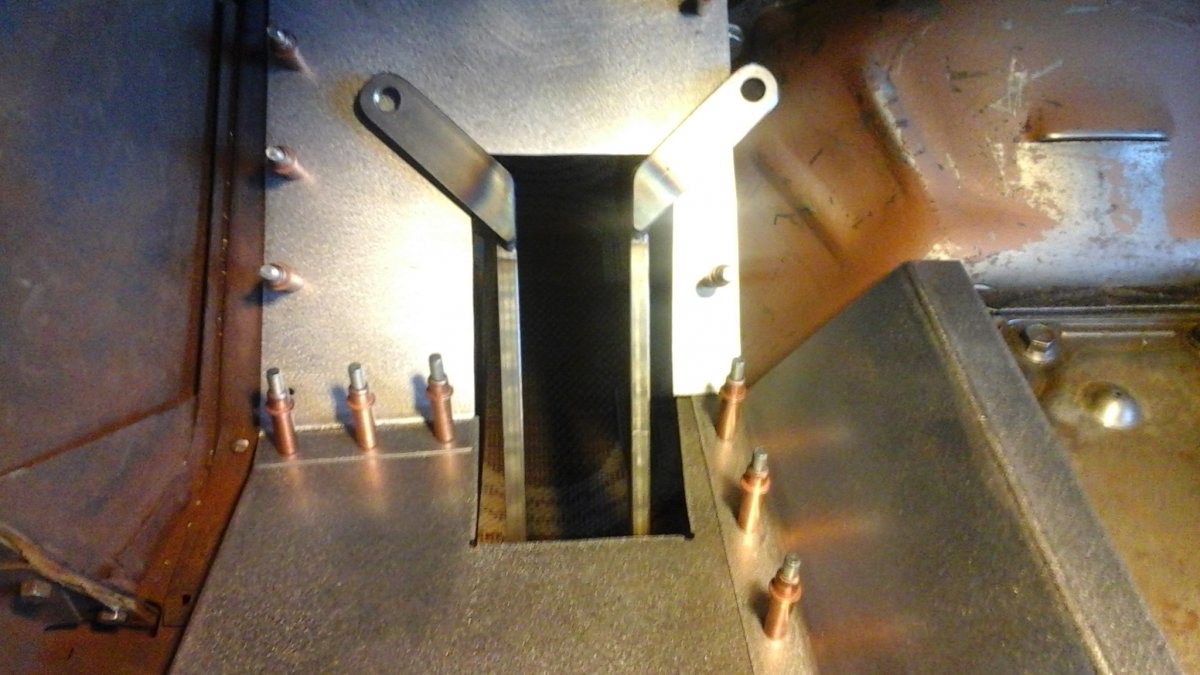

    Been working on more of the floor. Lots of rivets. 20161205_140923.jpg 20161205_123552.jpg 20161205_141034.jpg 20161212_110539.jpg More to come.
