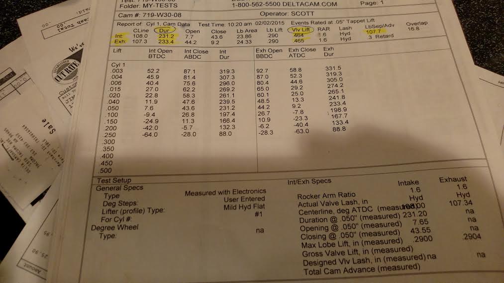

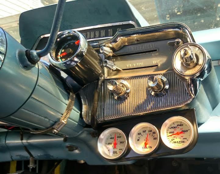

    it has mechanical gauge & stock dummy light , hydraulic roller , Royal Purple 30 WT. oil , Fram PH8A filter , break in oil was ran into a new drain pan and I inspected it ,cut filter apart and looked & each fold and no noticeable chunks of metal just tiny specks

    Find who sells Wix Filters in your area, and get a Wix 51515 filter and put on it. We have found so many engines with Fram and cheap, store branded filters having pressure issues. The poor quality construction is one thing, and the 'flow rates' are low.
    I would also try a 10-40W or 20-50W oil, we only use Brad Penn 30W break in oil on the initial break in of all new engines, Then, depending on the engines bearing clearances, they get Brad Penn 10-40 or 20-50 (unless they are the new GM LS or Ford and Dodge late model engines).
