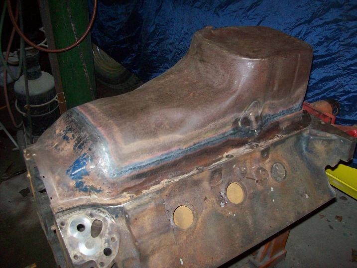

    Here is a pic of the 368ci Eldo/Seville pan on my engine.
    I forgot to mention that with the 368ci pan you might have to "adjust" the front of the pan a little for connecting rod clearance. On mine I had to gently "massage" the pan a bit with some light tapping with a body hammer to ensure clearance.....no big deal.

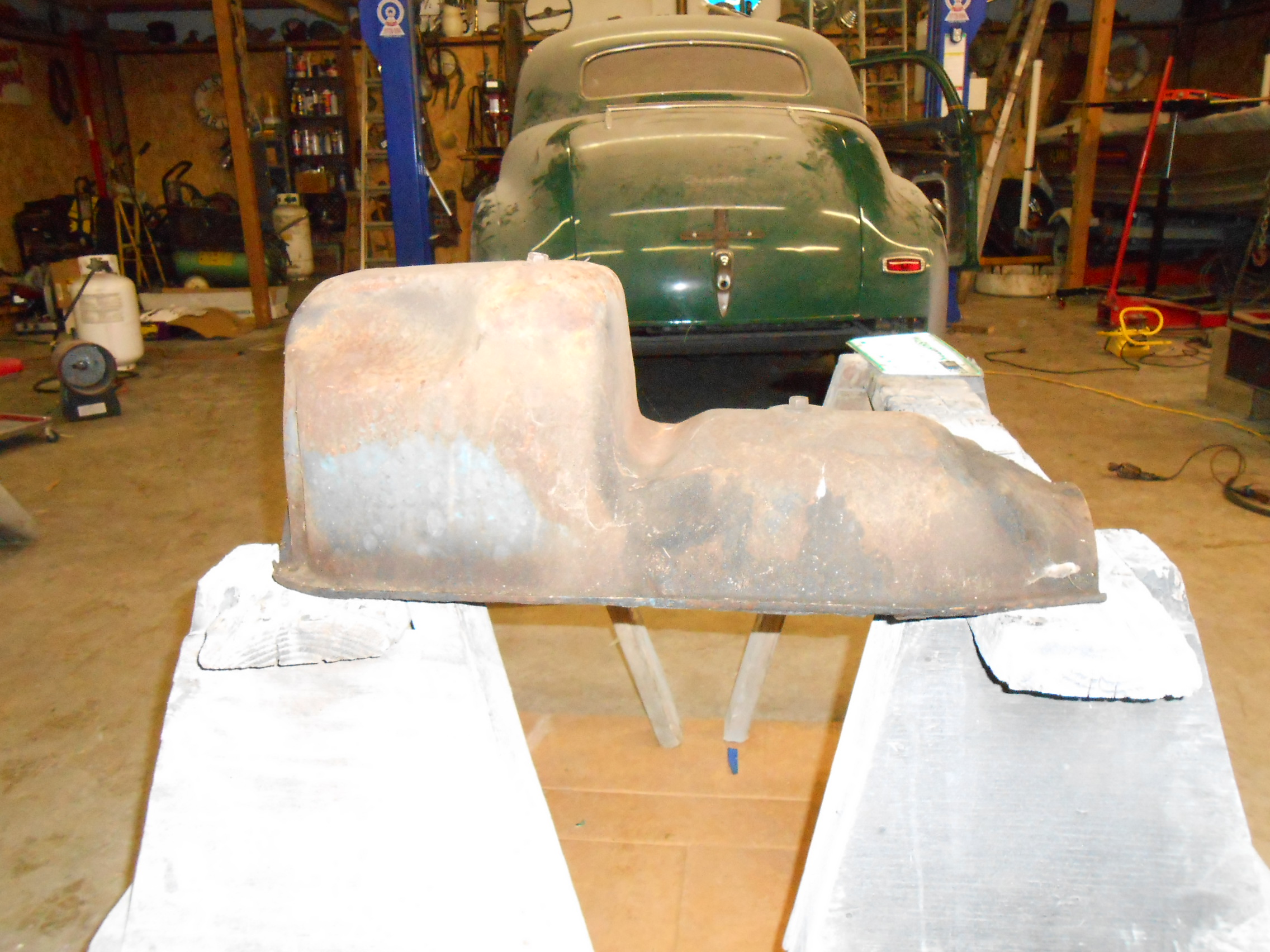

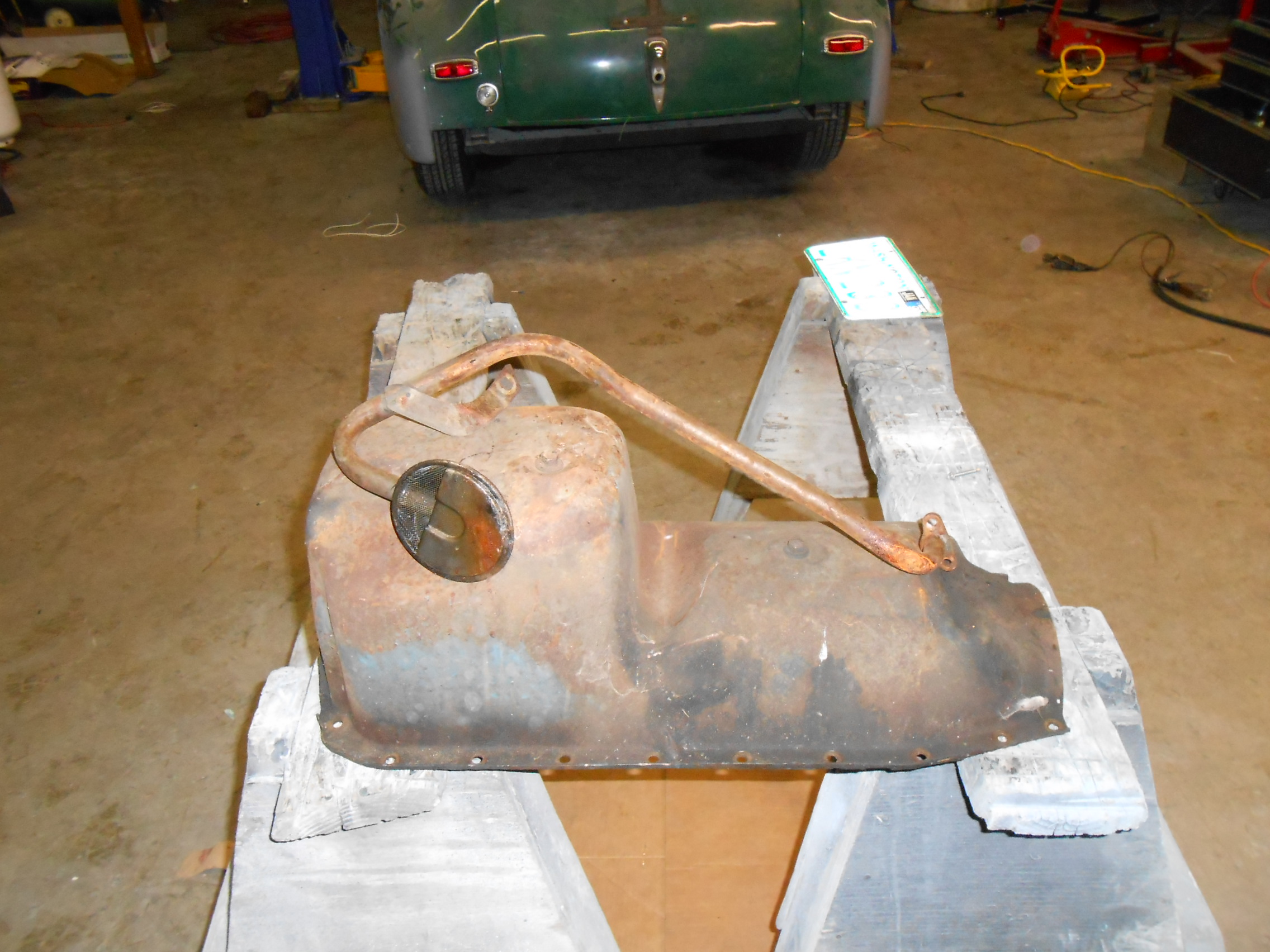

    I might have what you need, Eldo rear sump pan and pickup tube. If interested $100 plus freight. I will bead blast and paint. DSCN0024.JPG DSCN0024.JPG DSCN0022.JPG DSCN0021.JPG

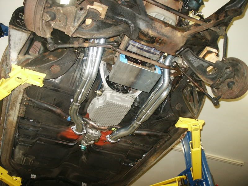

    My 65 Impala wagon came to me with a notched eldo pan. I have since built some headers and made my own sump with some help from MTS on a pickup tube. http://www.500cid.com/
