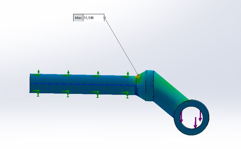

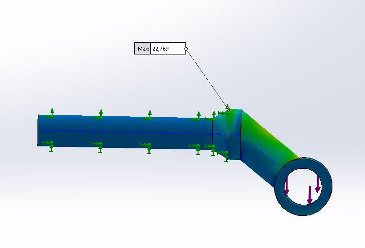

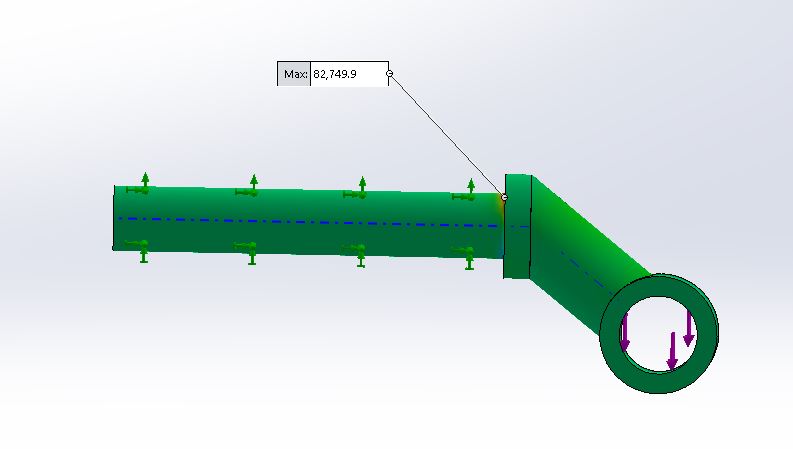

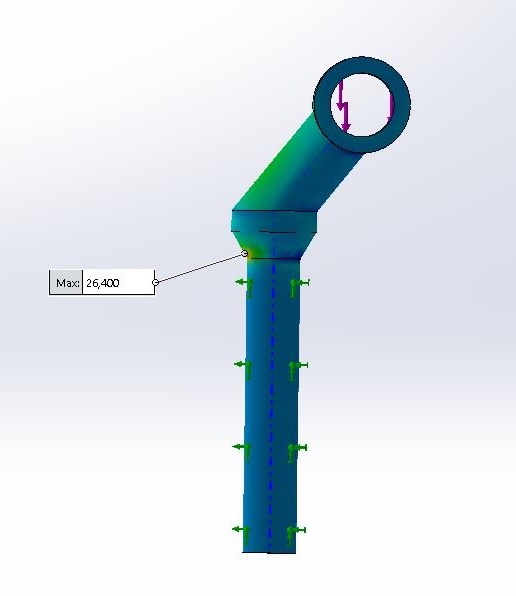

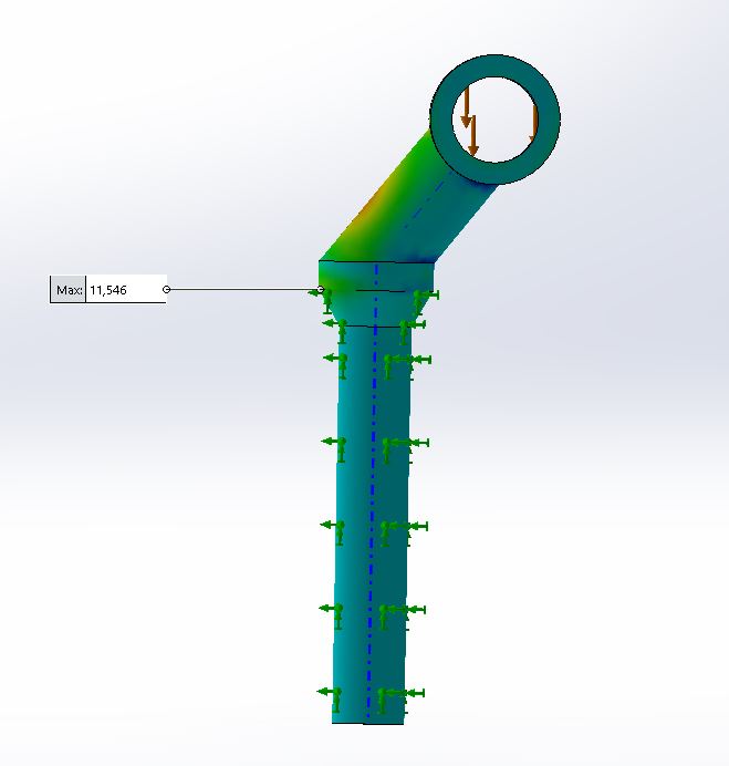

    There has been some discussion of the orientation of the spring perch and the chamfer vs. small corner radius on the stress of the perch. I thought it would be interesting to do a quick analysis to see the difference. This is a quick sketch of a perch, so the dimensions may not be totally accurate and the actual stress values may be off. However, it shows a good side by side comparison of the 1st principle stress on the part in the different configurations.
    1st photo: Stock orientation with stock chamfer: 700 lbs static load
    2nd: Sideways, stock chamfer, 700 lbs static load
    3rd: Sideways, .032" corner radius, 700 lbs static load
    Tman, Tim_with_a_T, Dog_Patch and 6 others like this.
  12. Ok, so what are the numbers representing?
    1- stock 26,400
    2 - sideways - nearly 2x
    3 -SW radius removed nearly 3x
  13. Ken Smith
    Joined: Dec 6, 2005
    Posts: 419
    Ken Smith
    Alliance Vendor
    Max stress in pounds per square inch. (tension)
  14. brsturges
    Joined: Oct 22, 2008
    Posts: 937
    brsturges
    from Miami, FL
    So it gets stronger placing it sideways and removing the radius? I must be missing something.
  15. Ken Smith
    Joined: Dec 6, 2005
    Posts: 419
    Ken Smith
    Alliance Vendor
    You’re missing something.
    0 psi would be no stress on a part. The higher the number, the higher the stress. Stress is the pressure on a part.
    clem and Stogy like this.

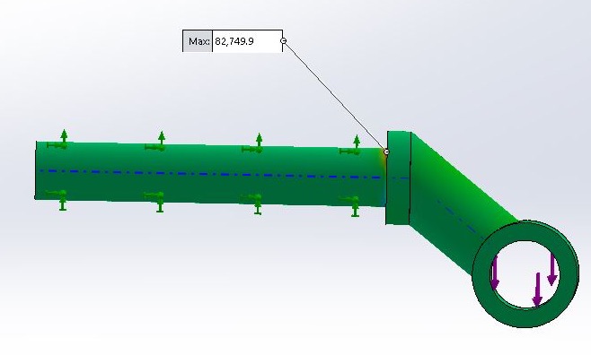

  16. Ken Smith
    Joined: Dec 6, 2005
    Posts: 419
    Ken Smith
    Alliance Vendor
    I added support to the taper as it would be supported in a wishbone or in a tapered bung as shown in post # 220. It makes a bigger difference between the stock tapered perch and a corner with a small radius.

    So basically, the forces applied to that point in the bottom arrangement are close to 4 times the load of the middle image, and ~ 7x the load on the top standard perch arrangement. Right?
  20. Ken Smith
    Joined: Dec 6, 2005
    Posts: 419
    Ken Smith
    Alliance Vendor
    In this model, which is a simplified example of the real world application, you are correct. The stress on the perch, at that point, is 7x the stress on the upright perch. The actual load on the part, 700 lbs static, is the same in all 3 examples. The only difference is the orientation of the part and the shape of the transition from the shaft to the upper perch part. One design minimizes the stress on the part, and the other design increases the stress on the part. You can take the results of an FEA such as this and compare it to the yield strength of the proposed material.
