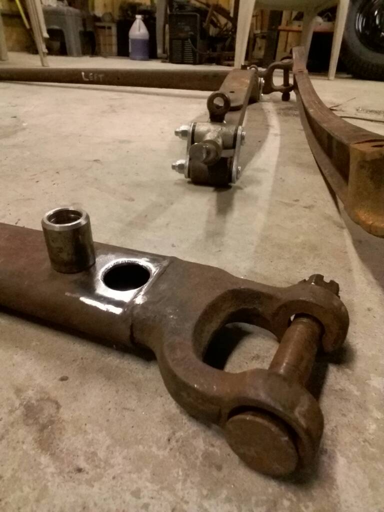

    Nothing but sympathy for Ben, he built a bad ass car, set a goal to drive it to Bonneville and did just that. To be honest, he has probably put more miles on this car in the last 6 months than many other hot rods see in a lifetime. It's a tragedy for sure, but I have no doubt he'll bounce back.
    They were forged speedway perches, and the taper had indeed been machined off. My question is for Pete Eastwood, how would you handle the perch to bone mounting? This look isn't going away, so being the chassis legend you are I am curious as to how you would handle it?
    The Rolling Bones guys simulate the ride height and weld the perches in place. I don't think they have ever had a failure, and everyone knows those cars are driven hard. The Roadster that Chip Foose built several years back had a sleeve in the bone to match the taper of the pin and was bolted in place. Obviously the thought behind both Chip's and Ben's setup is that the perch can rotate if necessary to keep the spring parallel with the perch. Thoughts?

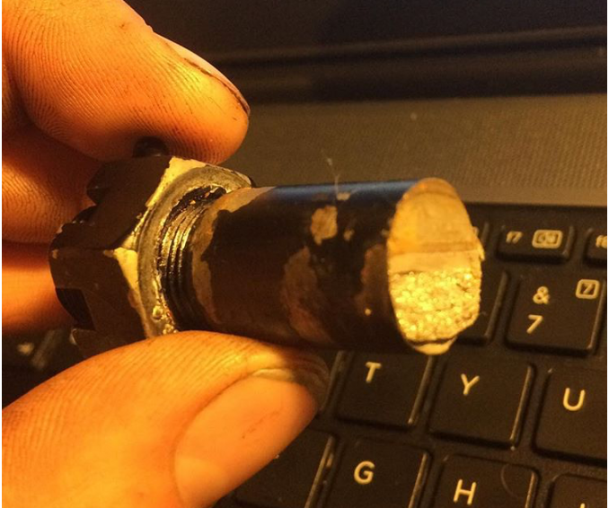

    new perch bolt.PNG broken perch bolt.PNG Trying to follow along to find the root cause here. Sorry that Ben's car got wrecked, but very glad Ben is OK. I will attach some pictures from this thread, the first is the new perch bolt. Looks pretty long. I would tend to agree that the taper machined off to a possible sharp corner would not be good. But the second picture of the broken piece looks like it didn't break at the machined edge. Looks much closer to the threads. So that makes me think it was cracked or had a flaw in the part itself that caused the crack.
    Here at work we don't check parts 100% unless they are critical safety parts. Maybe a suspension part should be considered a critical, don't think we normally do that on our cars.

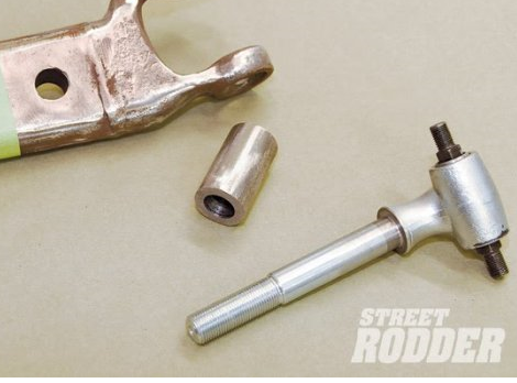

  8. That top picture /the one that says street Rodder. is not ben's
    These are ben's pictures
    Looks like threads were cut and conformation above the taper was removed

  9. If I were going to do that, (I wouldn't do that I'd copy doane) taper the bung to match the bolt makes better sense. Getting the bung thru the bone at the right taper so the perch is square to the spring in the angled bones.

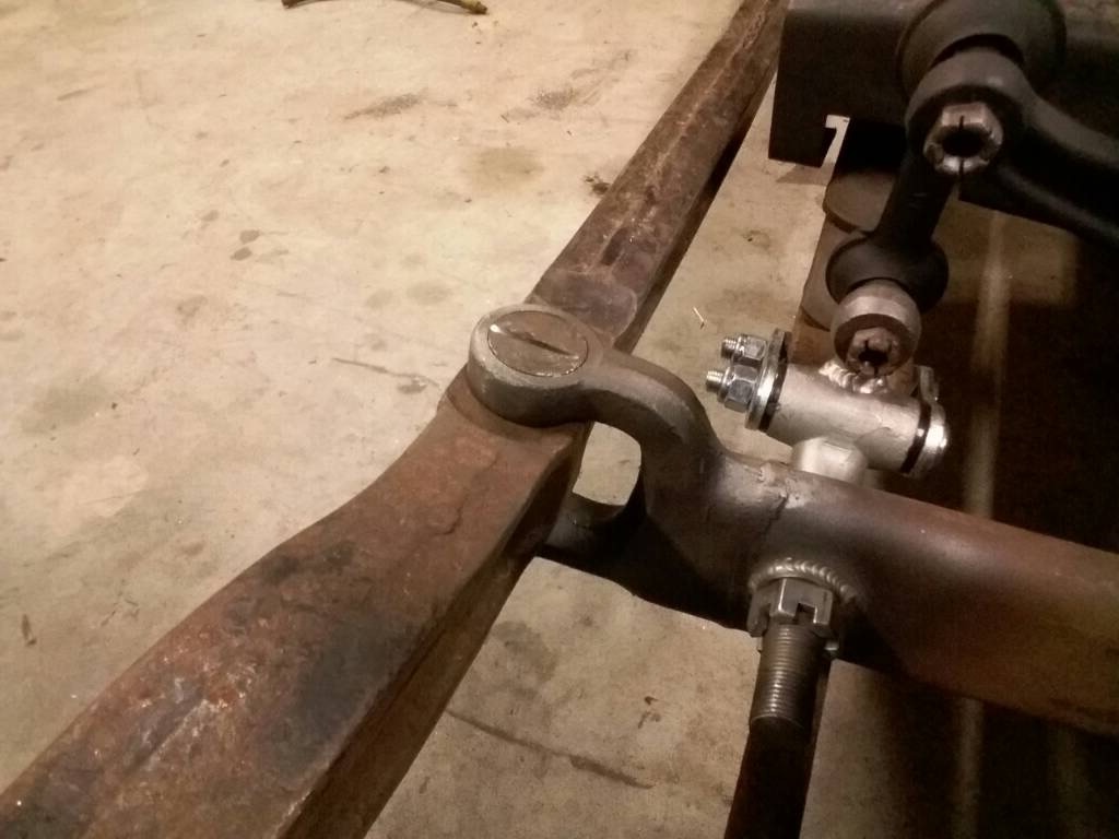

    1. Sam, If this is a Speedway forged perch, it's probably made off shore. Maybe not the best for this application. I doubt any aftermarket perch will match the quality of the material used in an original Ford perch.
    2. In Ben's other pictures it shows the perch still shackled to the spring, & looks like it is broken right at the machined area.
    3. Turning the perch on it's side changes the way the loads are put into it. In the stock position, it is being lightly loaded sideways & is supported by the taper. Sideways it's in tension & has side loads, (it's being pulled down) & with no taper it will want to flex at the machined point. It's been weakened by machining & has more loads on it. You might get away with this with a Henry Ford perch, (maybe).
    4. Probably a fabricated, welded on perch would be best. There is no need for the perch to rotate, build it so at ride height it is the same angle as the center of the crossmember where the spring mounts & you're good.

    Looks to be paint on the broken perch pin, doesn't look to have been fully supported on the bushing in the wishbone.

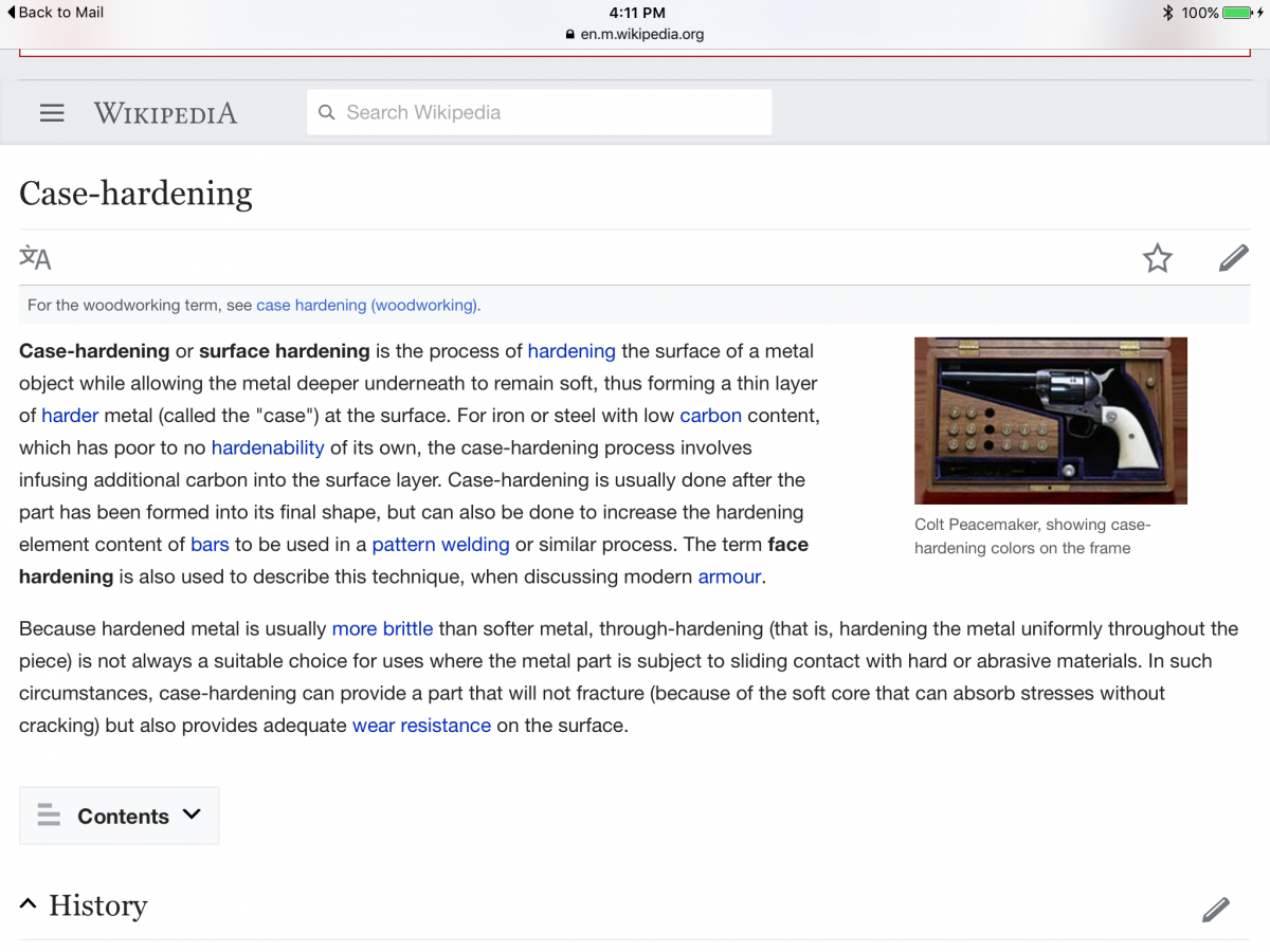

    continentaljohn
    I took a spring hanger of a unknown manufacturer and went to see if it was hardened . This was hardened and soft enough to still machine and cut threads. If this was the case and the part was case hardened for the reason of wear and stretch like a grade 5 bolt . Thus cutting the shoulder or taper to make it flat would expose the soft inside. If this was welded to the wishbone it wouldn't matter because the soft inside is now a solid mass with the bone.
