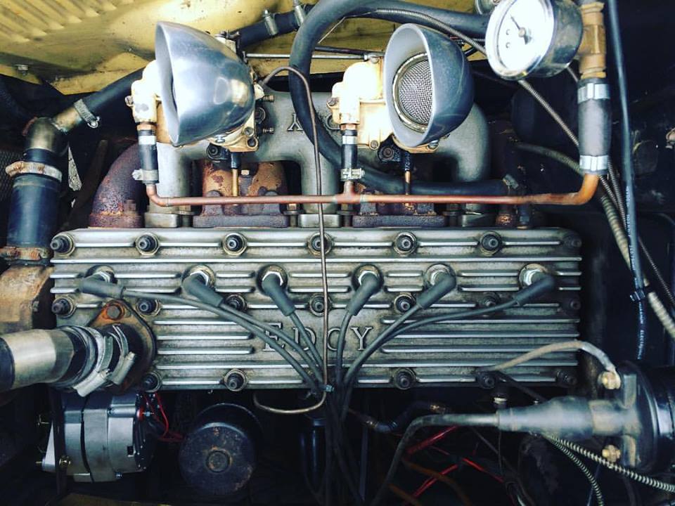

  9. Been running this setup for the last 4 years now on a daily basis, still makes me smile every time I fire it up. 218, Edgy head and intake, 2x Holley 94's, Fenton headers going into 2" dual stainless system. Pertronix ignition.

    Lookin good Tommy, and the head has a vintage/antiqued look to it, and it is not that old being an "Edgy"...

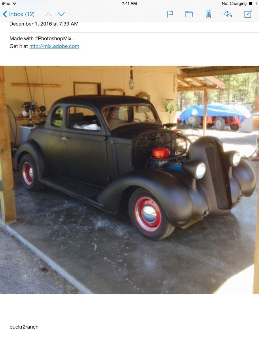

    Great thread. Always like to see other flat 6's. Mine is a 36 Plymouth with a 41 engine. Converted to 12 volt with alternator. It's in the shop for the winter and will get headers and duel carbs for spring. Plan to convert tranny to a A833 when I can find a good one at a reasonable price.

    Love it, let me know if you are in need of a high quality Asche made adapter plate for the A833 conversion...

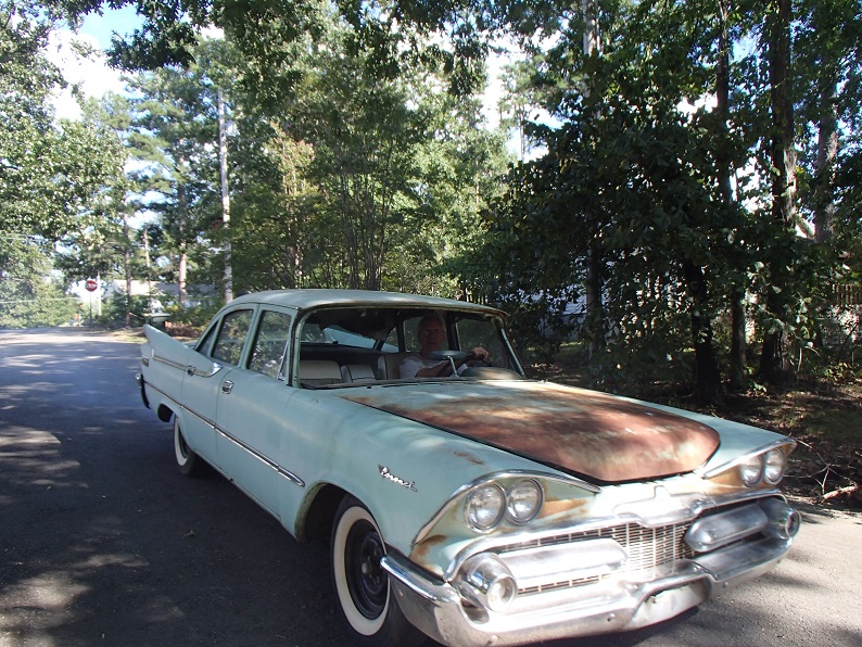

    Thanks for all the flathead info. I finally got a windshield for my '59. This car only has 42k original miles. I'm hoping I might find a neat head.
