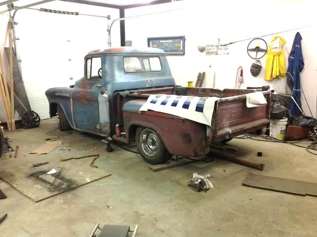

  19. dubie
    Joined: Aug 17, 2004
    Posts: 698
    dubie
    This is the only picture I have of it laying over the side of the bed. It's vinyl and blanket stitched together
      41.6 KB
      228
  20. 1959apache
    Joined: Nov 22, 2009
    Posts: 2,635
    1959apache
    Okay if it is vinyl you really need to have it foam backed (really thin stuff like 1/8" thick), also known as headliner foam or cloth back it. The reason is because glues don't react well to the vinyl/steel and make it bubble/wrinkle before it dries... its a mess.. That would be a good start. I am going to be calling my bud at the upholstery shop and find out what brand is good for headliner.
