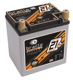

  16. Blue One
    Joined: Feb 6, 2010
    Posts: 11,462
    Blue One
    from Alberta
    I had read good things about them and some other reports where they were not strong enough.
    I decided to go instead with a battery like the Braille 3121.
    Still a small battery, but with much more cranking and reserve capacity.
    I found a Deka AGM battery identical to the Braille in size and everything else for much less money than the Braille.
    http://www.braillebattery.com/index.php/braille/product_batteries/b3121
    http://www.federalbatteries.com.au/ETX30LA/
    I believe the Deka is made in the same factory as the Braille (East Penn) , but they will not tell you that.
    (The Deka can be fitted with the same bolt on automotive style posts as the Braille)
    54reno likes this.
