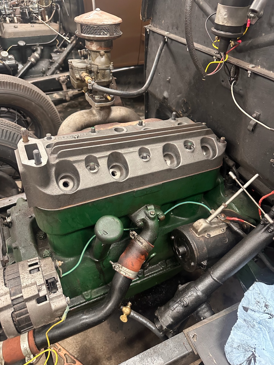

    The water manifold was made for overhead cams, with this you are pumping water into all the original block ports. Takes a bit of drilling, grinding and sealing. IMG_0522.jpeg IMG_0523.jpeg
    Okie Pete, Outback, 40 Olds and 2 others like this.

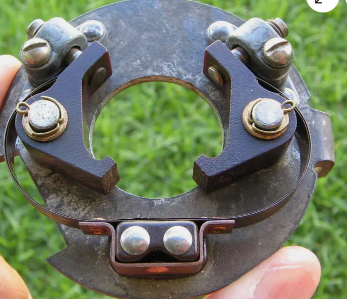

  12. Can we talk about distributor's ? I saw this photo posted on the interweb's and have never seen this before , was a early V8 distributor on a 4 banger a thing ? If so what is the story ?
    Okie Pete and Outback like this.
  13. Jason Roth, a younger cat up near Sacramento did this. He used an A transmission input shaft housing, and a Model A distributor, and made it into a temporary adapter for a helmet distributor. He reoriented the points to fire on 4 rather then 8. 94190266_222057969071466_8373294732952171510_n.jpg 94099644_3183111538399869_2163218726436964721_n.jpg
    Okie Pete, Lil'Alb, Outback and 7 others like this.
  14. Hmm
    So I wonder
    If that could be modified to fire two simultaneous and used on a dual plug head
    just another project I guess
    J
    Outback likes this.
  15. Fabber McGee
    Joined: Nov 22, 2013
    Posts: 1,331
    Fabber McGee
    At first glance, using the V-8 distributor to fire a dual plug head looks like an easy alteration to me. You might get by with just moving the rotors to 180 degrees apart. Probably a custom points cam. Cheap to get parts to hold in your hands and study off ebay.
    Looks like it already has dual points. You should be able to fire one plug slightly before or after the other.
    The cool factor would be huge.

    Perhaps a custom points plate instead of a custom rotor with one set movable to change timing. Screenshot 2024-10-08 000416.png

    Been awhile since I looked at a V-8 rotor, but it would need to be modified to fire the 2nd set of plugs as well. Modifying a conventional rotor is pretty straight forward, but the Ford v-8 rotor mod might be bit of a challenge.
  20. Kevin Pharis
    Joined: Aug 22, 2020
    Posts: 576

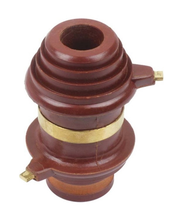

    Kevin Pharis
    I completely agree that modifying this V8 dizzy to fire a banger would be a relatively easy project… it’s the dual plug discussion that makes things more complicated. Just because there are 2 sets of points does not make this a dual ignition dizzy, this is actually 2 separate 4 cylinder distributors that fire from the same coil. The 2 point sets should fire at equal and oscillating intervals, never together.
    To fire twin plugs in a banger it would need to trigger the 2 point sets simultaneously (or only a few degrees apart) in order to deliver 2 separate sparks, typically from 2 separate coils.
    Guess it may be possible to rig up a modern waste spark ignition coil to fire the pairs of plugs in series, from one side of the dizzy to the other. This is getting fun!:p
    Outback likes this.

    Here’s a pic of the early V8 rotor. The coil has a carbon brush that contacts directly to the center of the spool shaped rotor. Essentially making 2 separate 4 cylinder distributors firing from the same coil.
    Would be a neat project to build a rotor with 2 slip rings to separate the dizzy into 2 separate ignition circuits. Then would only need to wire the points (or maybe convert to pickups) to complete. The biggest challenge may be finding the dual plug head…:eek:

    If you want to run 2 coils, while you have the rotor apart to put the terminals 180 apart disconnect the close terminal from the center conductor. Then you can run one coil through the center of the rotor to the far end and slip ring the close end and tie it to the terminal on the outside of the rotor.
    Probably have to cut up 2 rotors to make it work.

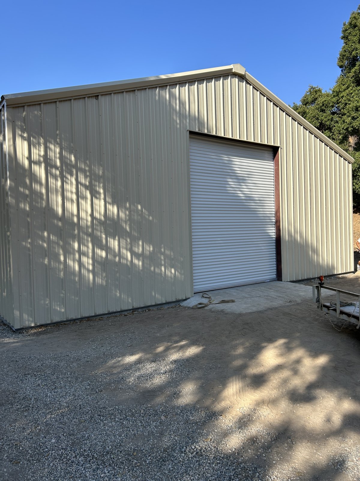

    Amazing how quickly a shop that looks huge empty shrinks when you start putting your tools in it.
    Outback likes this.
  27. It started shrinking when the roof went on
    Outback likes this.
  28. Thanks for the picture of rotor
    That will take some work to separate the two circuits and insulate properly

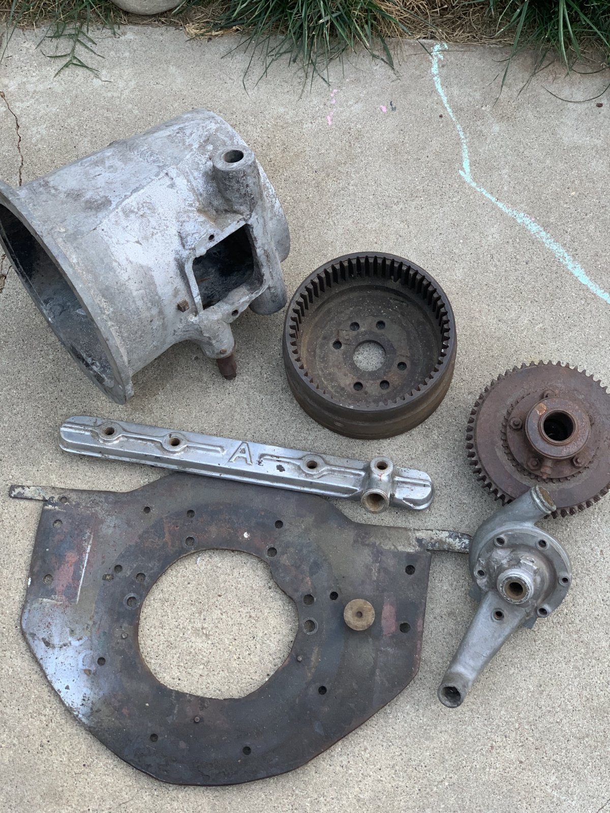

    image.jpg So the PO of my pickup gave me this stuff with it. It's model A stuff from the 70's. Argentina. Wiring harness etc..Just like the chinese stuff none of it fits worth a damn heheh.
