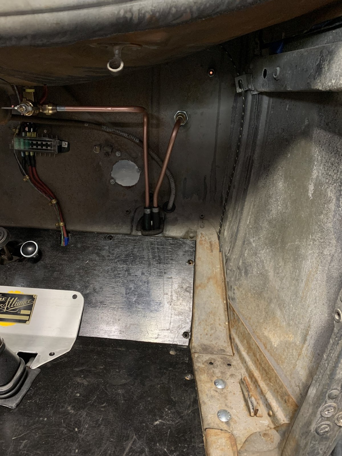

    Current tagged Buckeye halotron extinguisher located to driver’s left, plus a heavy-duty battery cutoff switch located right in front of the seat riser.

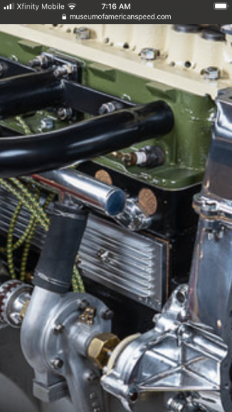

    Just figured out that I was posting on the wrong thread…:oops:

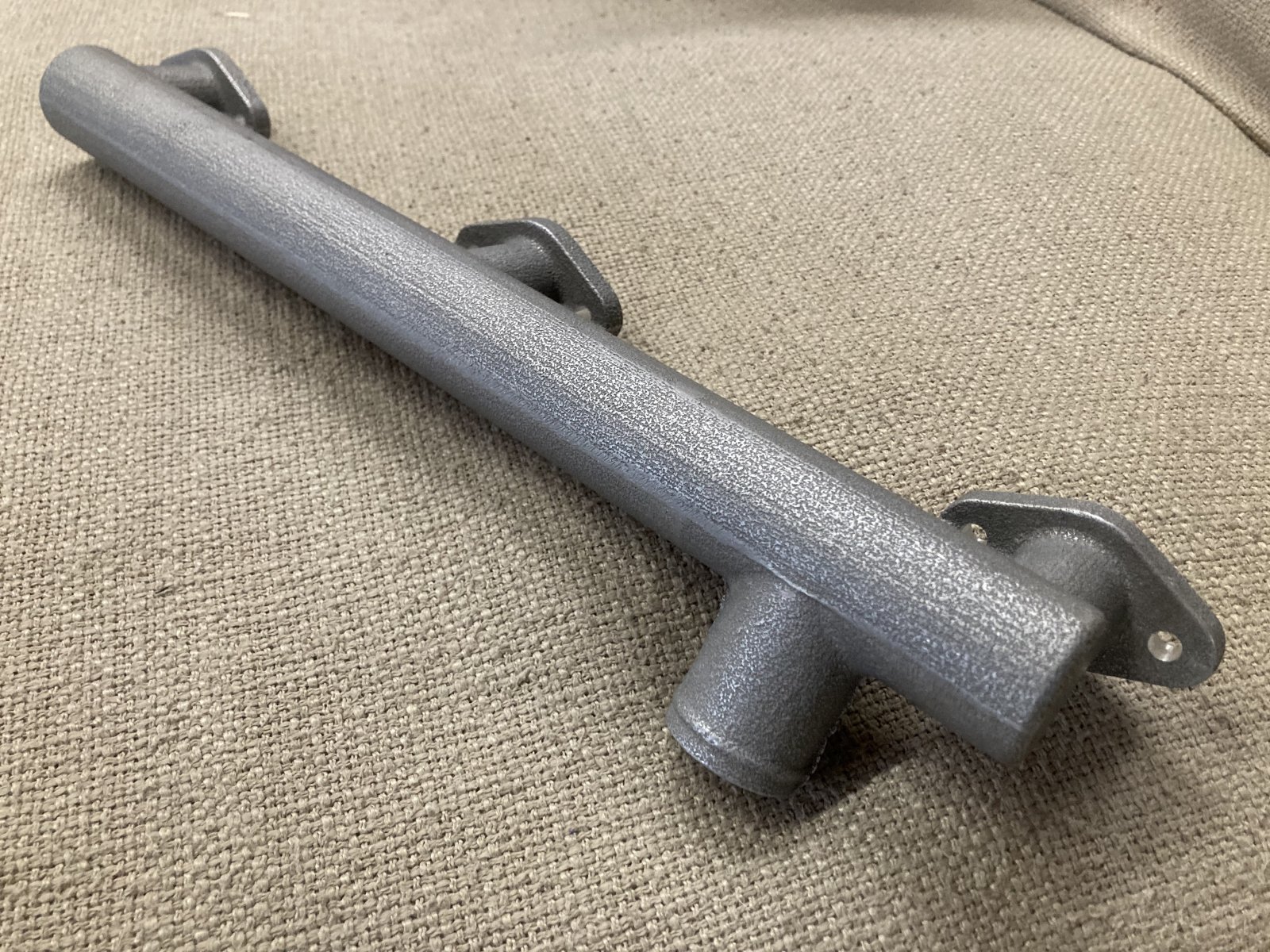

    Another step toward gettin the Akron-Hed running!:D

    How many hours of printing did that take? Will you use it as a pattern for casting? Looks perfect!!

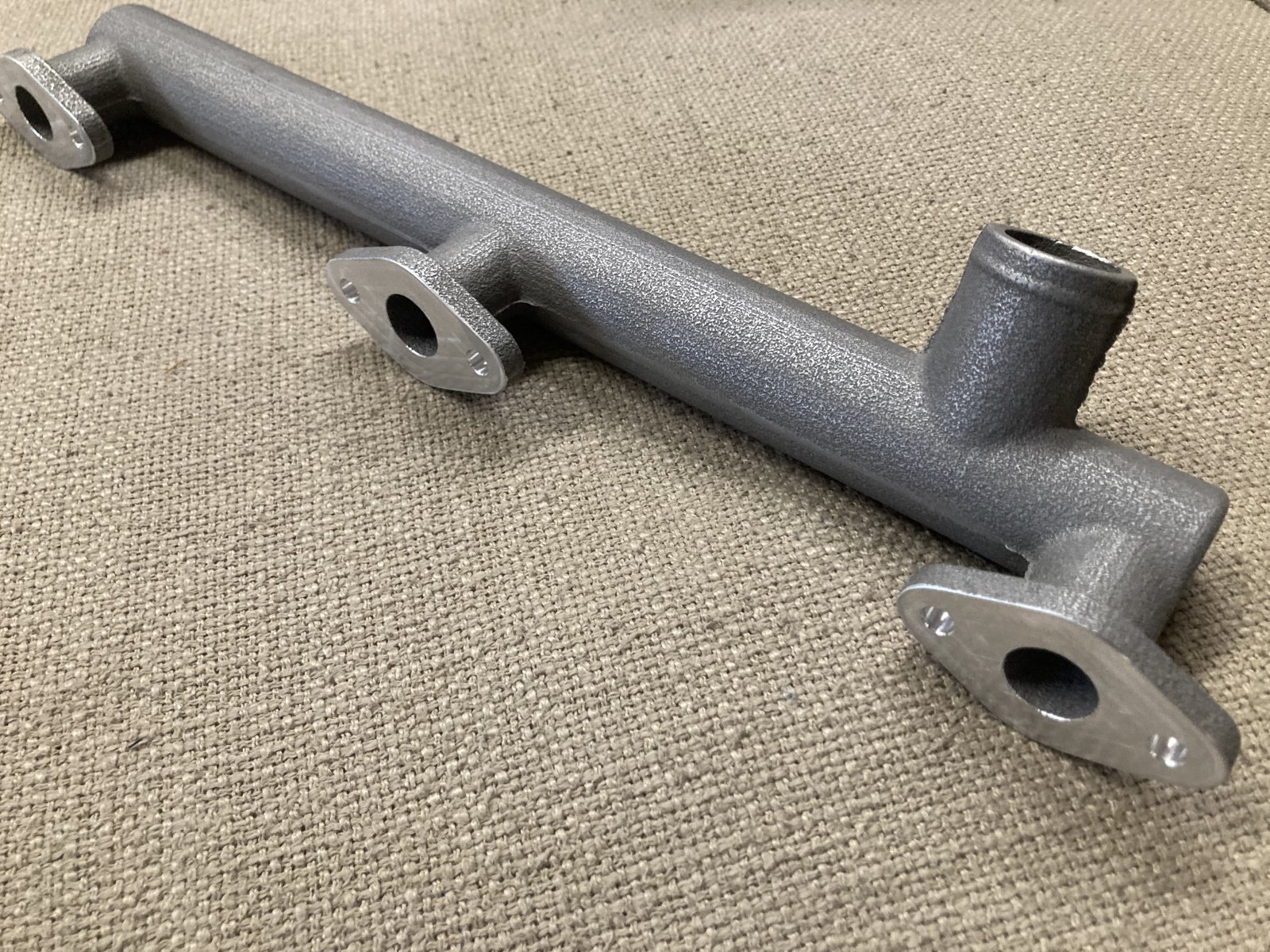

    This part is A356 T6 cast aluminum. It was the sand that was 3D printed. No pattern necessary. All you need is a 3D design of the part you want… and a credit card!:eek:

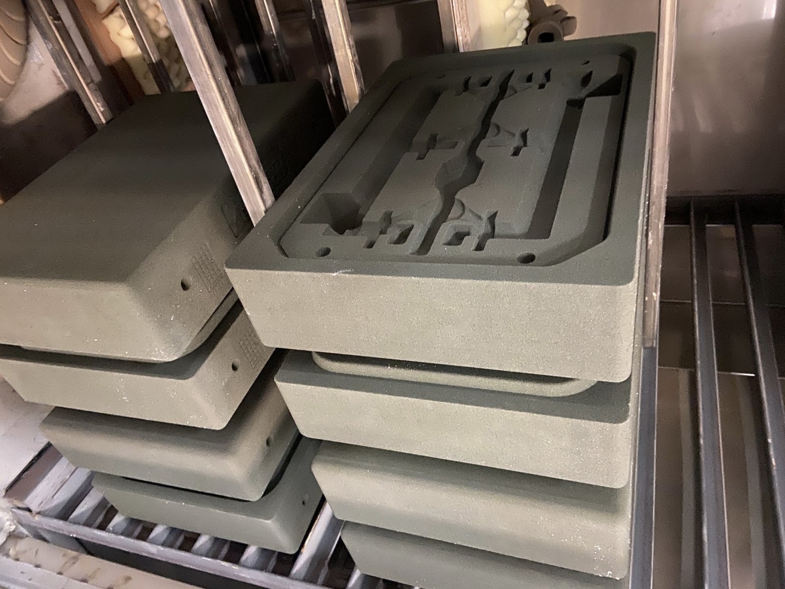

    Here is a pic of the 3D printed mold

    Cool. I have heard of printing the mold. I saw an engine block, 6 cylinder I think, that was done this way. Had to be spendy.

    @Kevin Pharis - do you mind elaborating on what you shared? If those are sand casting molds, they certainly don't look single use.

    The part is a water manifold for a Fronty water pump, oil pump, magneto side drive for a T. Admittedly, I don’t have a Fronty side drive, but intend to route some water from the stock water pipe to inject some water at the front and especially the back of the block. I currently have rear cylinder heating issues and expect the Akron-Hed will be no different.
    The sand is 3D printed and definitely single use. Not exactly affordable to go this way… but if you really want a few parts, it’s about the same cost as a pattern. It’s quick too… parts delivered in bout 4-6 weeks! My experience with old fashioned patterns has be 6-18 months!!!:eek:

    Kevin, what do you think a ball park estimate for a mold would be for a full engine block? The block standing on the bell housing was about 4 feet tall. Was for a tractor that is the only one known to exist.

    Since all aspects of the mold are printed… you wind up paying for the sum of the cubic volume that all mold components individually occupy. Similar to shipping a series of parts in boxes, you pay for all the space that all the boxes occupy. There are also engineering and setup charges that fluctuate with part completely. If I had only poured 1 of these water manifolds, it would have been about $2000. An entire engine block…?! You better start saving yur lunch money!:eek:
