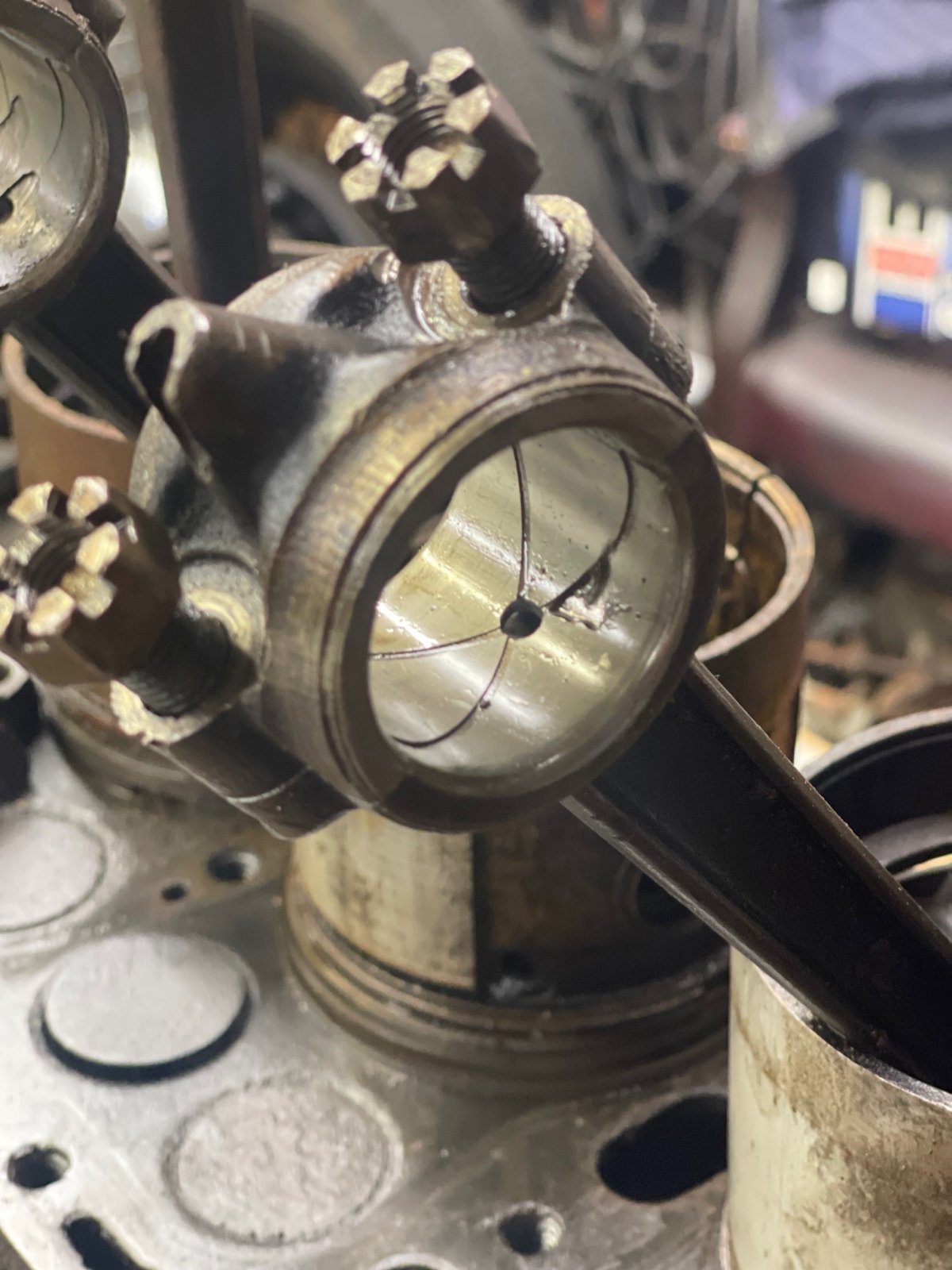

    Well update on the forgotten banger... Rods and wrist pins are frozen, hence why it wouldnt turn, Pistons moved in the bores but couldn't break these free, thankfully they were at TDC and were able to be driven out once the caps were removed... Shame she is in such bad shape... But looks like the block is ok so there is that. This motor is just a tinker with motor, frozen and forgotten for many years. Plans are unknown right now, Id rather spend the money on the orig A motor from my 30 and have the inserted bearings cut in.
    Crazy part is, I dont know why it was pulled, but everything shows no mechanical failure reason behind it but it was 100 over and there were no shims on the rods nor mains, so maybe she was knocking... Few Babbitt pics for you
    Here they are out, the two laying over wrist pins are free and nice... banger3.jpg
    The two worst cyl, 1 and 4, both were at TDC...
    Im guessing she was full of water at some point for this kind of rust up there.
    And the bearings... This one looks like a cold pour...
    Plus look at how thin they were poured...Insane...
    Who knows what Ill do with it, may sell for a buildable core or keep it in stock to build later for myself...

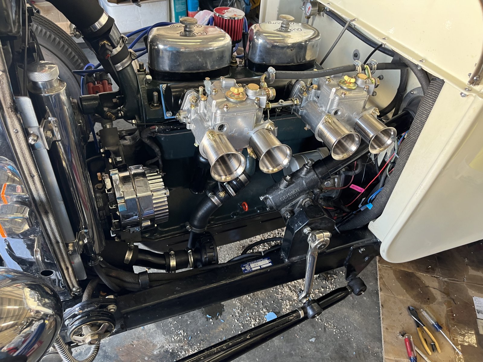

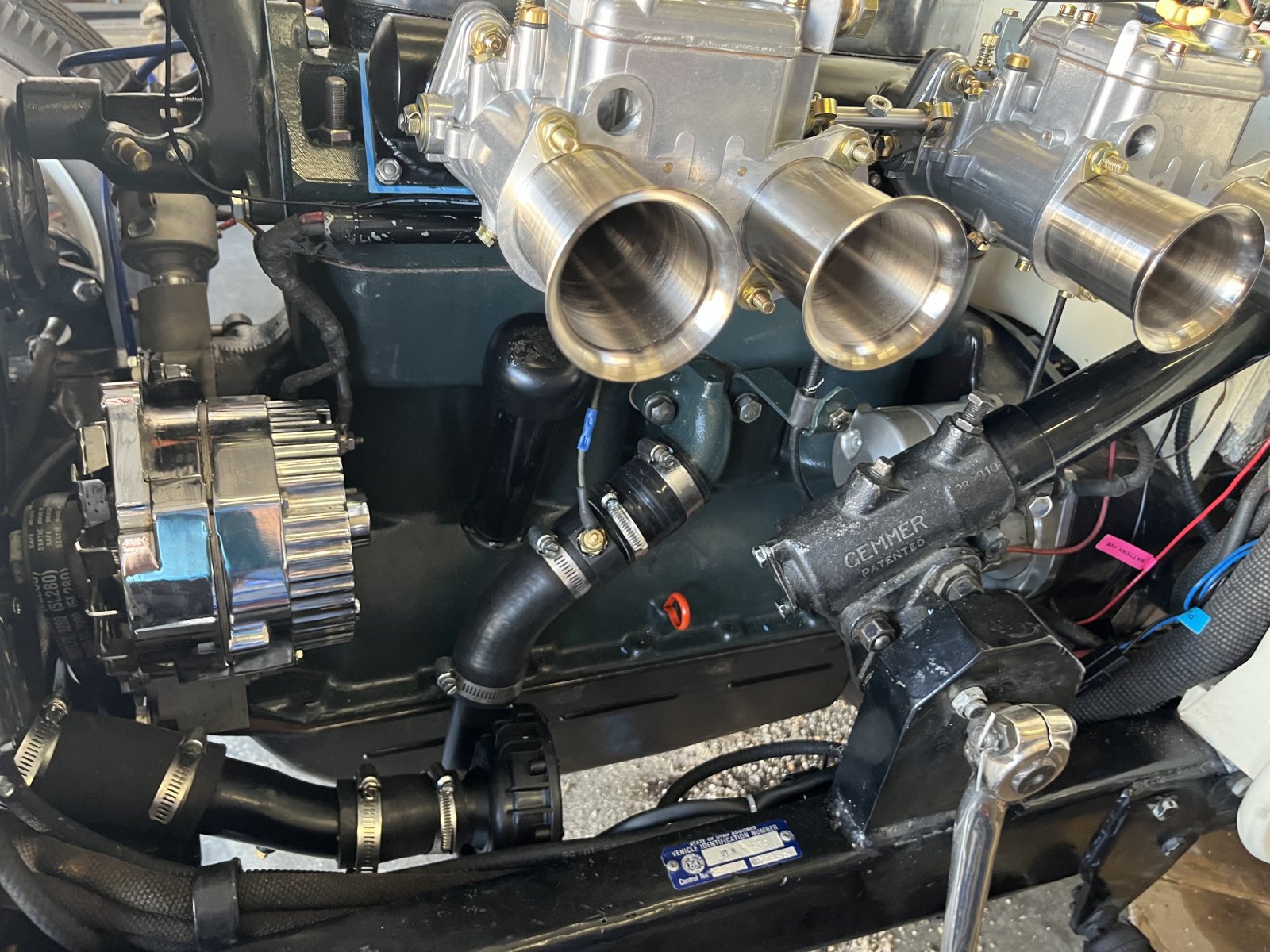

    When I installed a vintage Riley 4-Port Head on our B Engine in our Speedster, I had a problem finding a suitable Water Pump. The Riley Pump needed to be rebuilt, so I looked for other options. I found an Electric Water Pump, that has a Electronic Controller that controls the Water Pump Flow Rate (& Electric Fan) based on Engine Water Temperature, not engine RPM.
    I wrote an article which was published In the current Secrets of Speed Magazine. The article is attached for anyone interested.

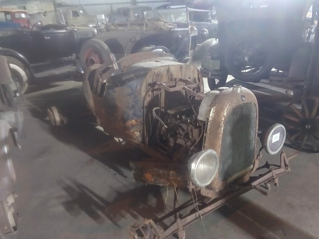

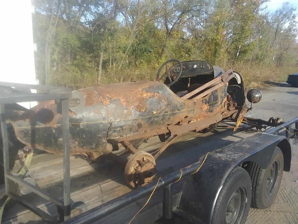

    Happy monthly banger, the last year for me has been involved in a belly button and liver transplant into a '72 Jeep wagoneer (ls1/4L60e) so I can have a fun road trip/trail rig/ tow rig). With that 99% done, and no money to spend...I found a thing. My friend on the East coast hauled it back, and I won't see it till spring. So, we can all commiserate over the low quality imagery and postulate on how deep I dug my hole.

    fur biscuit : Someone had to say it : "That'll buff out"... LOL!!

  19. Damn, thats a great find!!
    Don't buff it out too much

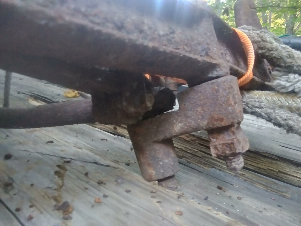

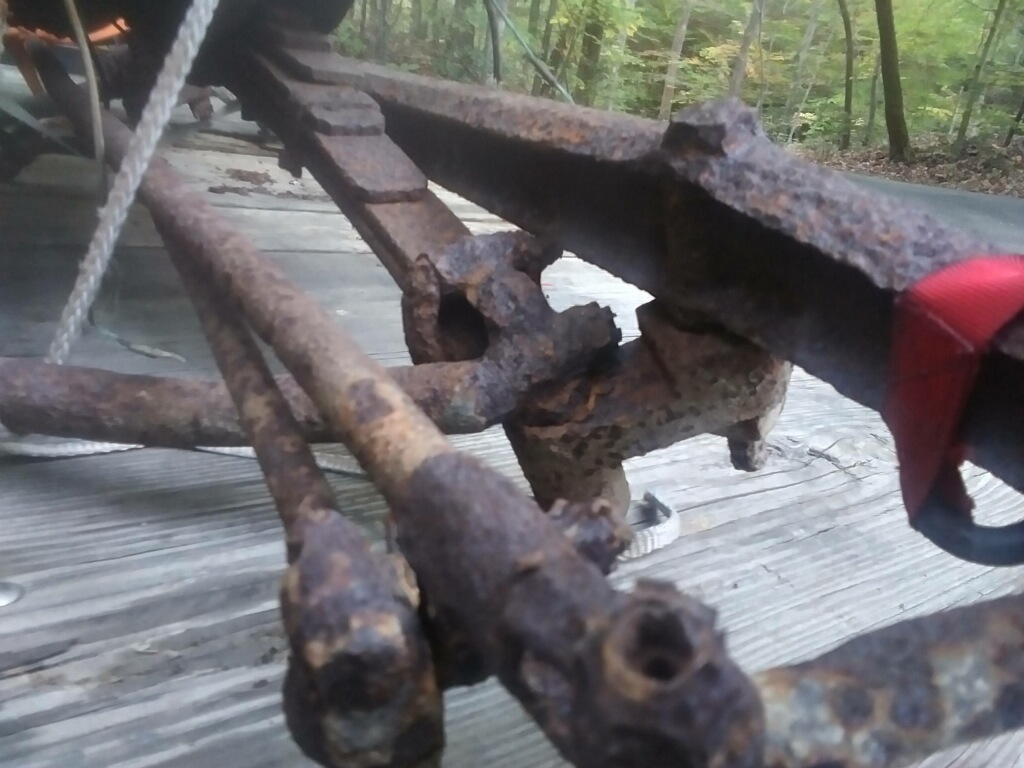

    Looks like a Faultless racing body to me! The Whippet radiator looks to be in good shape, and has Laurel front lowering brackets too. Nice find!!!

    Like Kevin said, it looks like a Faultless body....I'm thinking with the flair on the cowl it's a Morton & Brett.

    Kevin, don't think they are?
    Do you know if anyone is still repopping the Laurel style?

    My first inclination was Faultless, due to the flat spot behind the passenger compartment. But the cowl flare is much more Speedway or Morton & Brett.

    Good catch fellas! My eyes were focused on the tail, and I completely missed the cowl flare
    The close up pic of the lowering brackets reveals they are not Laurel, but perform the same task of pushing the axle out front and relocating the spring perch behind the axle
