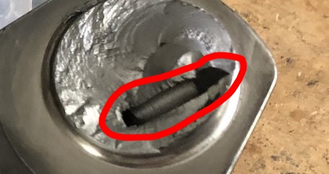

    I have run the M-21 in a B engine bored .100" over with a Rutherford head and @ 9:1 comp. ratio, Three Stromberg carbs (97 as primary and two 81's as secondaries) 20# alum flywheel and T-5 trans. Ran very strong ans with the 5 speed was very streetable. It liked to rev. and break crankshafts. The last one was a Scat crank.

  25. It left a mark ……

  27. Yeah no,
    I feel it was an issue with the crank
    I have used bigger cams without issues

    b crank.jpeg John
    Is the area circled showing an oil feed hole or is it just part of the broken journal?

  29. Drilled oil feed hole, approx 8% of the journal area. Typical Mod "A" journal size.

    Do you feel it was a material deficiency, or more of a high power living on 3 main journals issue?
