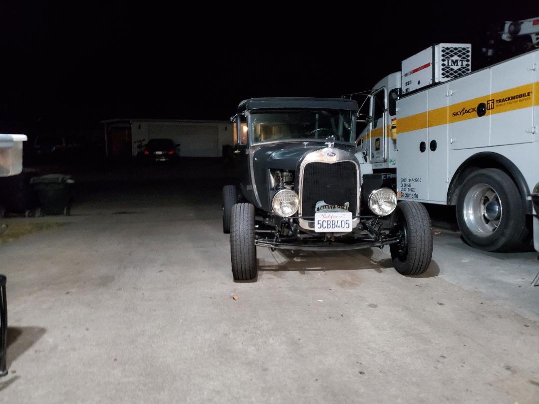

    Best time of the year for night work...a lap around the rail yard,eyeball the outside diners in Roseville then Rio Linda for some two lane country running..cool moist evening air, the hounds want to run..

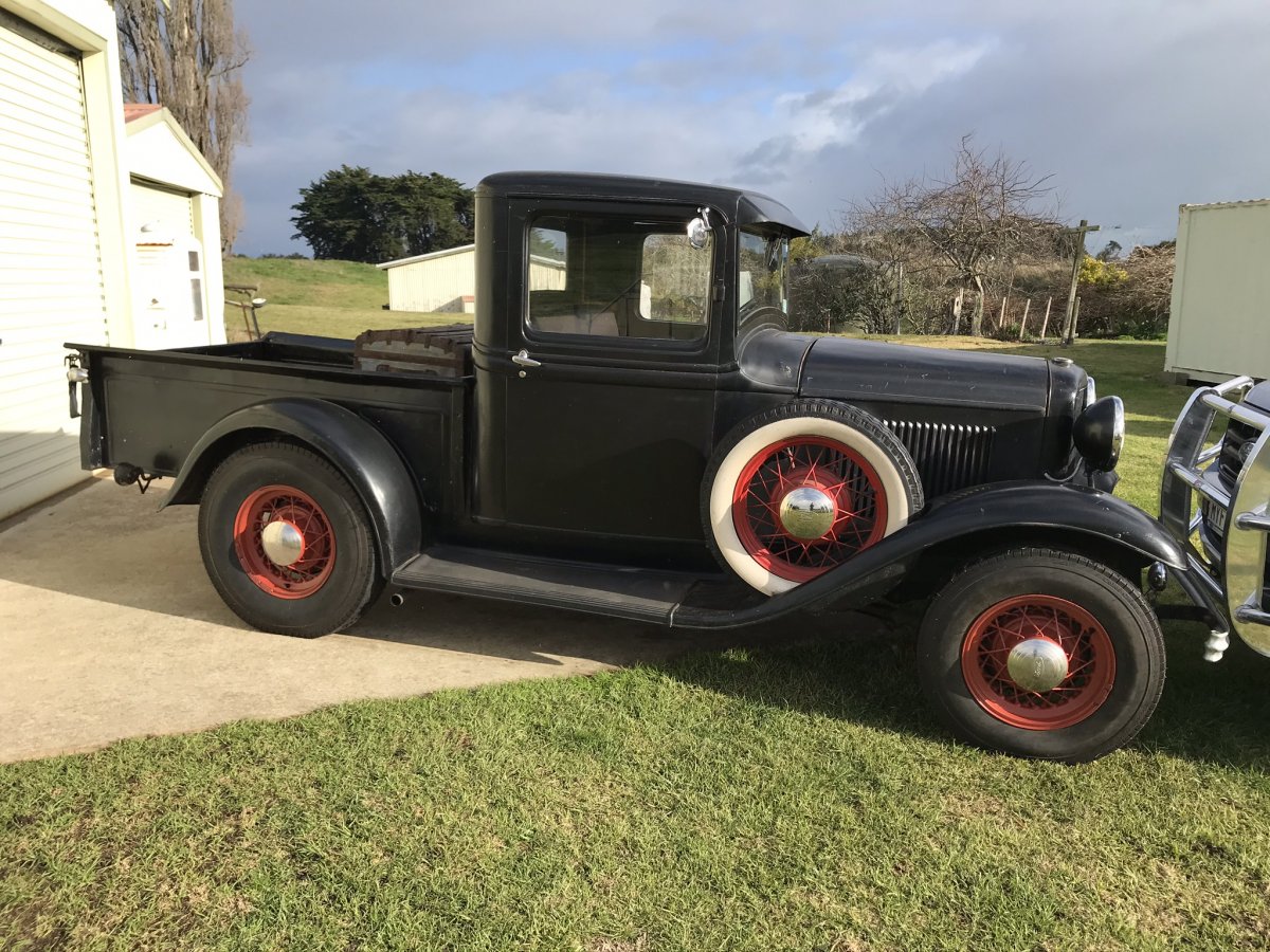

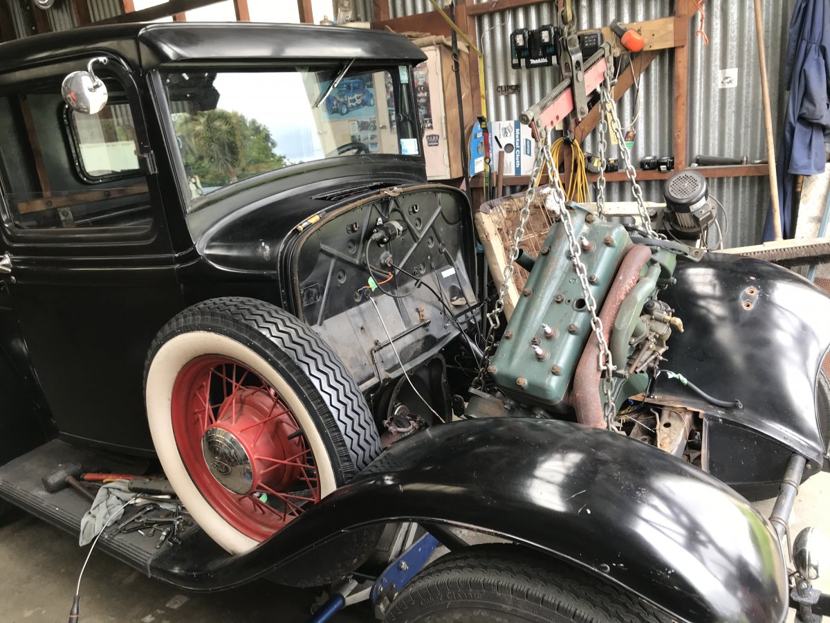

    In anticipation of the rebuilt B4 with Miller OHV conversion. Yep its in for a new quadruple by pass . But i am not holding my breath . I guess good things take time. A very Very long time...... DDC490D3-F1FF-4503-9ED7-1D1030360A0E.jpeg

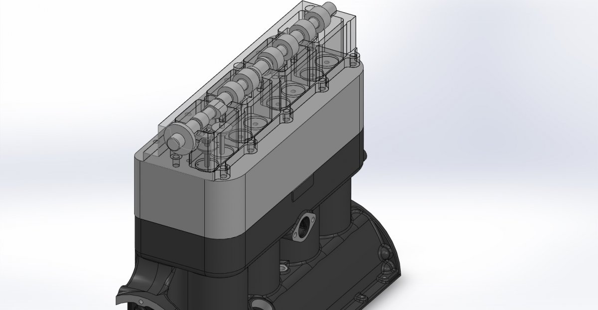

    Engineering at Glacial speed.......that is what it feels like sometimes.
    This is the easy part, making it actually work is another story

    Hey Kiwi,
    Is that a ‘32 four cyl Ford Coupe ?
    Lets see a profile of body, eh.
    I’ve got a 5 window ‘32 with V 8... model 18.
    Thinking of putting a 4cyl into it. Wondering what all is different to do that, if you know !

    Hey John,
    Wow....BIG BRAIN !
    Looks great, but where are the ports...in the blk?
    Why not make a double OHCAMS, while your at it ?? Chain driven ?

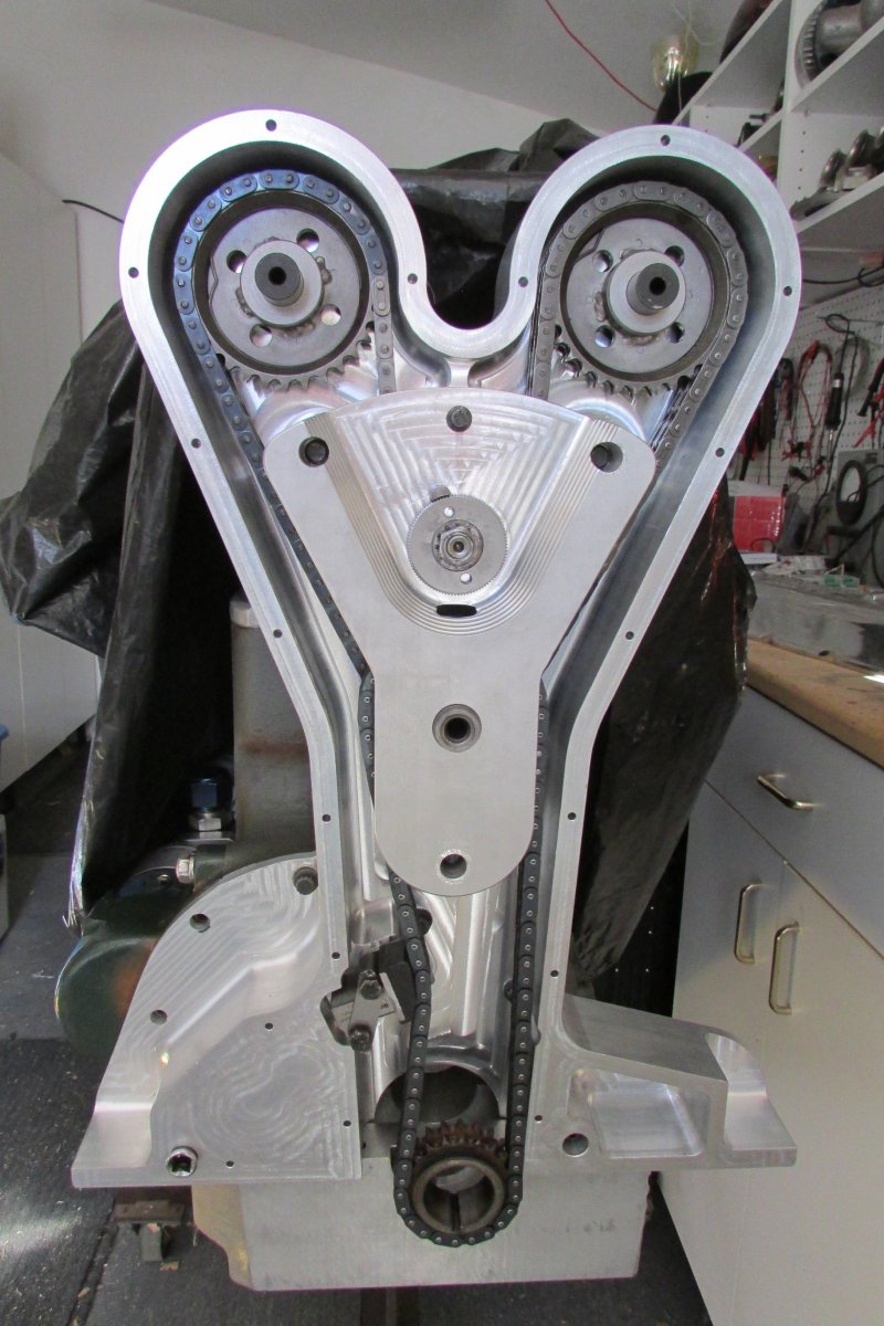

    Why spend time drawing the ports when they exist in the head?
    This is to go on a Gemsa 4 port.

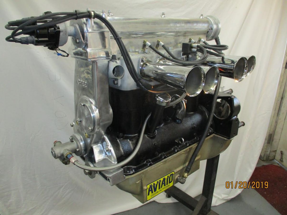

    And or, do you mean something like this? DOHC

    Yeah, but that has no throttle plates, kinda hard to drive in traffic.

    @hardtimesainit . It looks like you know your way around 4 bangers . Some one with real seat time comparisons needs to chime in . It’s an early production 32 pickup . Was all matching numbers till we built a new B4. I think we have more $ into the B4 than any flathead V8 we have ever built. I had a strong 50 merc motor but was told by the boss, nope it’s staying 4 banger. 97EEAED0-8007-4335-A8E6-68A0696109D5.jpeg

    Yup that’s what alright !!
    Impressive work. Is that going on your Bville engine ?

    I agree with the ‘boss’. Beautiful truck !
    Yeah, know what you mean about excessive banger cost -vs- flathead costs. Been there. more than once...What do you suppose is ‘wrong’ with us...lol
    Example: the original 21 stud is rebuilt (with what...60 hp ?).
    Well, what the banger will have 250 hp on low side, and high side will depend on $ spent. Ive been advised that for pump gas/streetable...250hp. See what I’m saying. Sickness, but boss is still right !

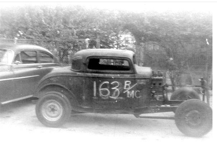

  19. A FoMoCo 21 stud V8? OUCH! They were the bain of this Ol' Boy's teenage existence! I got run out of Blair's Speed Shop (Don Blair's Home for Wayward Boys) by the older boys. I had asked about speed equipment for "21 Studs"! I tried to build Ford flathead V8's up to a Merc 59A block! All I managed to do was make the greatest handgrenades in the San Gabriel Valley! We DID put a "21 Stud" in our '33 Tudor "Jalopy" Race Car, only because we had to by rules. It (the engine) lasted because my shitty welds broke first and I hit the wall & went on my head!
    Jalopy.jpg Not our car; but a similar result!
    I doubt if you can get much more than about 180 hp out of a normally aspirated A or B, with a flathead or OHV conversion. You have a limit of a little less than 5000 r.p.m. after which you get diminishing returns due to increased friction. More than that you'll measure your engine's reliability in minutes, rather than hours!
