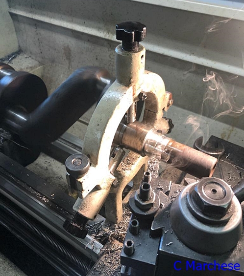

    I tiny bit of progress from my builder. Turn the snout of the A cranks to fit the T timing gear.

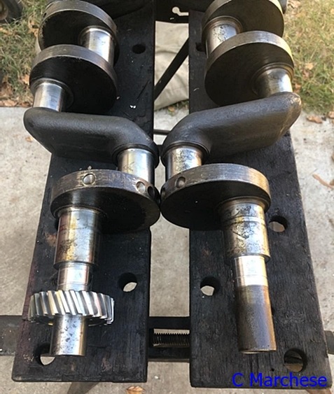

    Hey Guys,
    I'm looking for a counter-weighted Model A crank. The spare I have is already .020/.030 and needs a grind. Not a great candidate for counter-weights. So, I'd like to buy one already done. Can anyone recommend a place to purchase one? So far, I have only found Piranios. Is there anyone else? My ideal situation would be to find a B crank and block, but have had no luck.
    Thanks,

    Hey Phil, maybe I can help. The
    How about a C crank....standard !
    Drilled for full pressure: mains and rods.
    NOT cheap, but the best and ready !
    I got this years ago from an old...great... Bville banger racer. Not going to use it.
    PM me.
    If I remember , it has extra flange bolt holes.

    Build the dream brother,good luck..Scat builds a nice crankshaft,forged in China but machined here.

    I would offer this thought about the SCAT crank, it has the rod throws of a Model "A", not the "B" on the "B" crank.
    The rods are pretty good but still in the smaller size. I caution this because of the small journal and when drilled for oil it weakens. I had someone bring the pieces by a few years ago and the break followed up the drilled hole.
    IMHO, an original "C" crank properly welded and prepared is the best option before going to the 5 main option.
