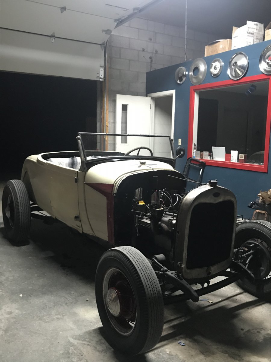

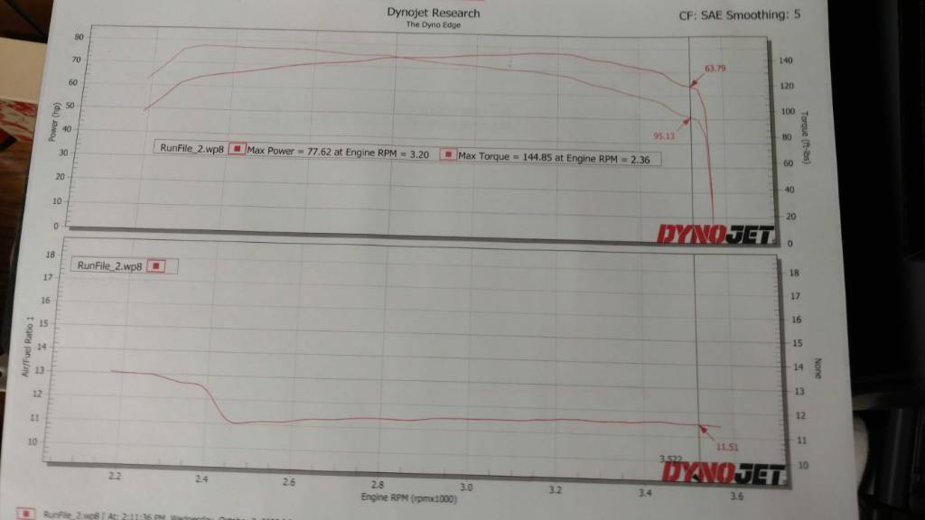

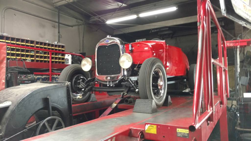

    Today was Dyno day. I set this up awhile ago and I've been totally consumed with taking care of my elderly folks. A brother made it here from out of town and I was able to do this. 4 bangers on a chassis Dyno today. Did a little tuning but I've concluded some things.
    First one; 29 Roadster with a B block.

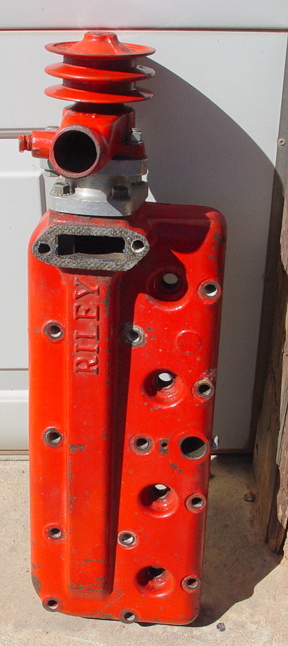

    I did a lot of intake port work and it has 1.650" intake and stock exhaust. B grind cam. Riley cast iron head. It's a flathead. 5.5:1 compression .020" over and flat top piston, flush with the deck. A Holly 94 and an unmarked aluminum intake. Stock exhaust.
    Mallory single point and 28 degrees total advance I believe at 2600 rpm
    Real respectable in my book
    I attached a photo of the head. No heart shaped combustion chamber.

    I see the photo of the head didn't attach...

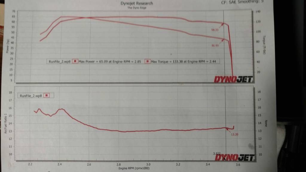

    The second run was the Vicky. IMG_20201007_100536535_TOP.jpeg IMG_20201007_102120914.jpeg 1602115382086.jpeg
    I was disappointed with this but I wanted to find out.
    This is a Cragar/Miller OHV and I can't tune it. It was real obvious that it has some problems and I've concluded it is the cam. It has 2:1 rockers and a .478 lift...but the overlap is killing it and no duration. It is a flathead cam. I have a Cragar grind for an OHV on the way but I did some tuning and the biggest improvement was the elimination of the power valves. It had 70's in it and I didn't have two smaller ones. It has the new Stromberg 81's on it
    The best pull was actually 67HP and that was with the air cleaners off after this one but I didn't get that print out. It will get a re-do after the new cam.

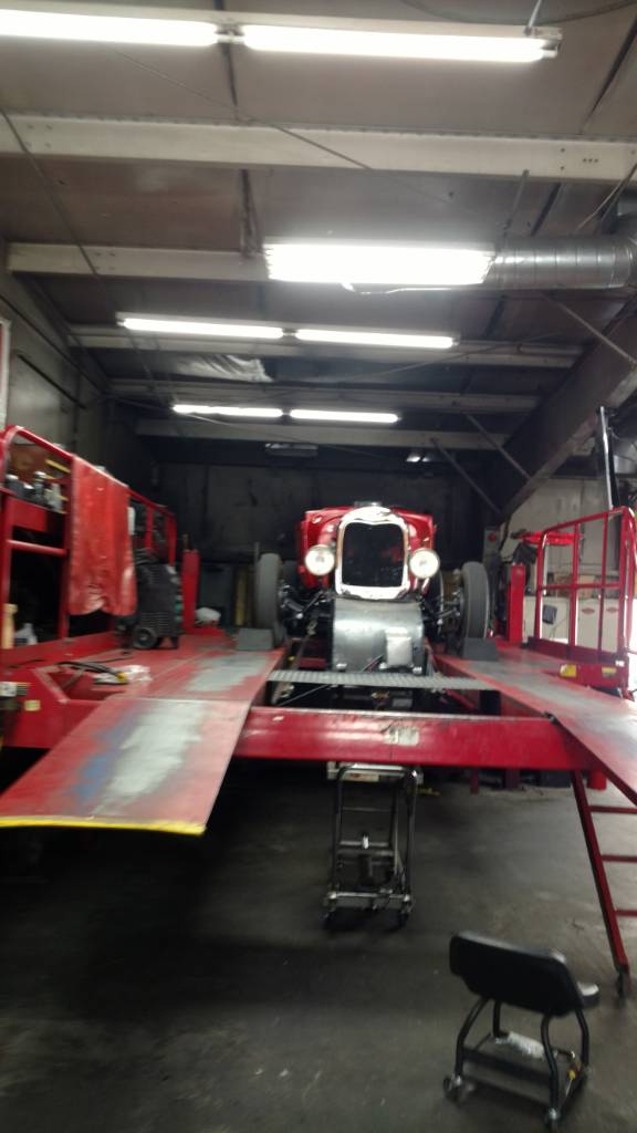

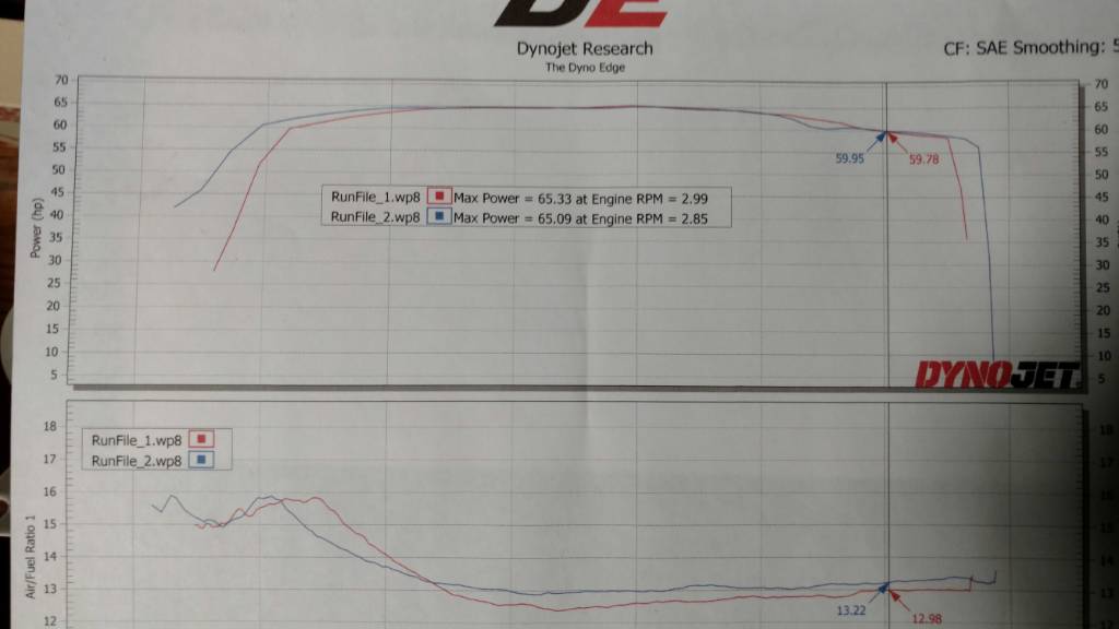

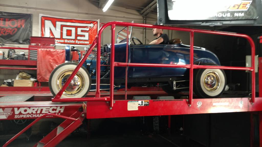

    The third run was the '29 with the Schofield/Miller OHV I am happy with this but not tickled like the Riley headed engine. There is room for improvement and I know where to go now. I bet that we would have picked up some if I dropped the exhaust for instance. It is a little fat and if it was leaned out some...but I'm getting ready to go to a lower elevation so not now. The AFR was real, real consistent with original 81's and I have an EE1 base on one of them. Now I know

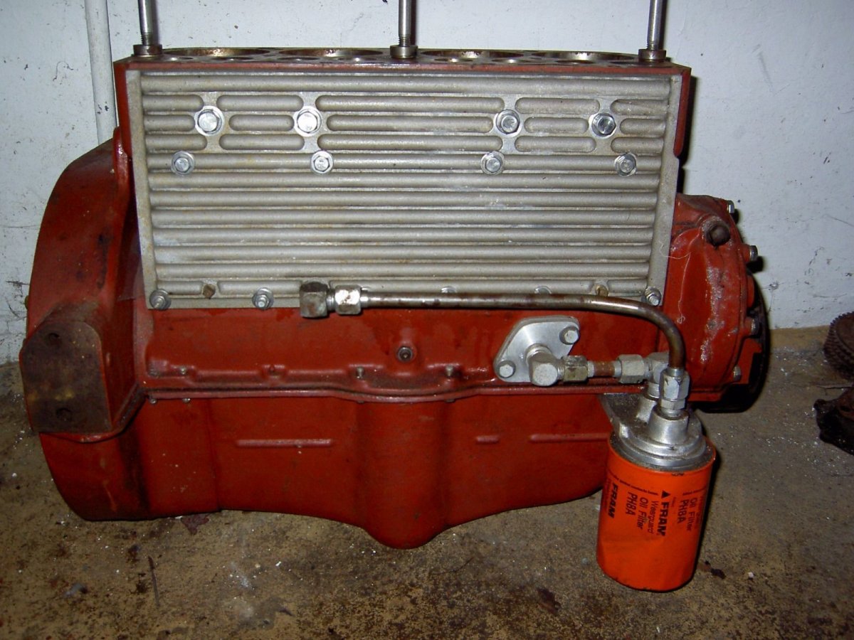

    This is the outside of my Dan Price built B block.
  12. Thank you for posting this! I was posting earlier about the dan price oil pump and this answered my question where the fuel block port outputs to. After it goes through the filter, where does it go to?

    The horizontal oil passage behind the cover. Note the two brass plugs each end. One will be used to oil the OHV head and the other a pressure gauge.

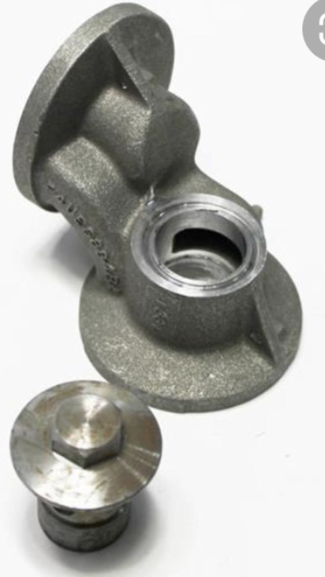

    06BD7ED8-E4BC-4B77-BCB6-98E76F31BED9.png Wanted M-6880-A50 90* Oil Filter Adapter. I’ve tried to order from Summit, Jegs, MACS/Ecklers, Snyder’s and several other Pony/ Ford parts websites. Hoping someone might have a extra or un-used one kicking around? Please let me know would be a great help!

    That filter adapter is scarce. Dyno? nice but why? Windup knew his Vicky had an issue from feel,the dyno just proved it..My point isn't to criticize, and dyno's have their place,properly calibrated and maintained they are valuable to racers and Bonneville guys..but for street applications I don't see the need personally,just drive it and tweak till it feels good. When horsepower numbers come up in a discussion I take it with a grain of salt,most are guesstimates from the part advertisement.

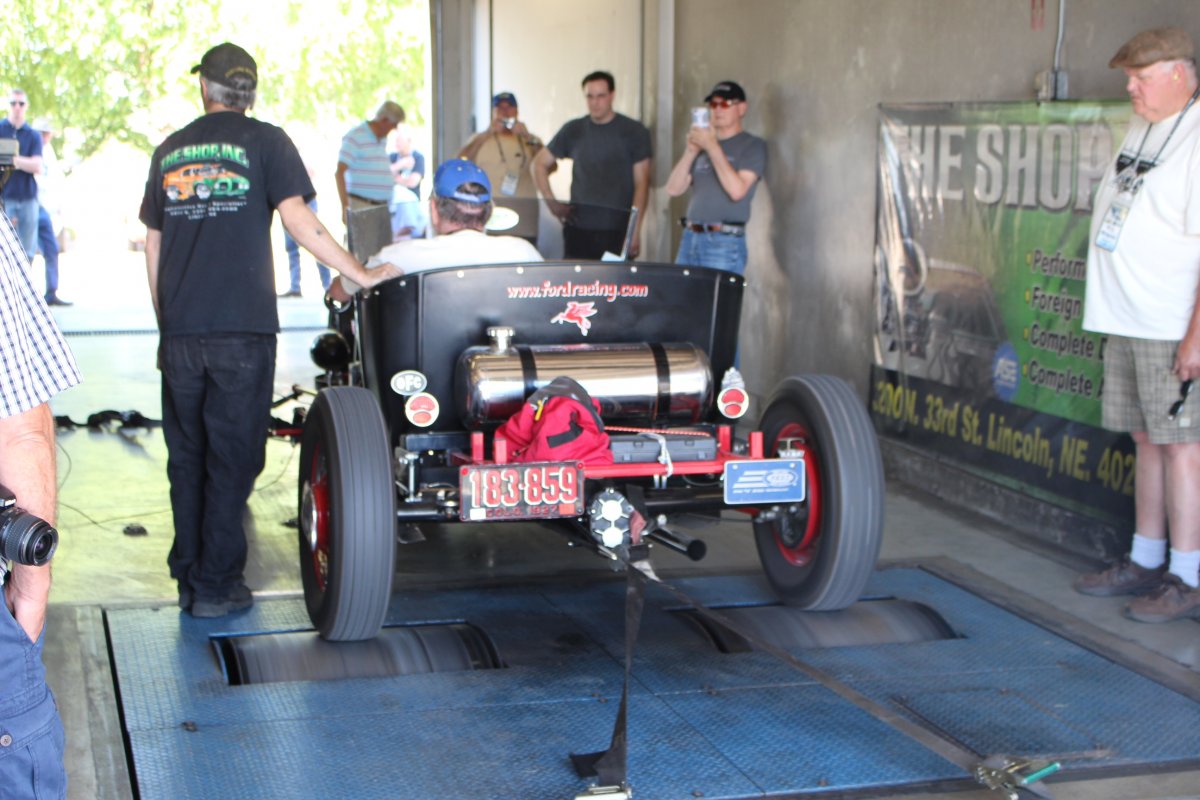

    I've done the Speedster Reunion chassis dyno runs in Lincoln three different times with two different cars. Got 59 HP at 3200 RPM on the CCPU with a B engine, CRAGAR head and all of usual speed equipment. The Zipper is a '31 with a Brumfield Super head and turned 60HP at 3500 RPM. Those numbers are feel good and justify all the money you spent to take a 40 HP engine at the flywheel and add 50% at the rear wheels!
    winduptoy....what's the deal on the double pully?[

    Looks a lot like what Jeep uses on it's 4.0 L inline 6.
    Try pick-a-part for it
