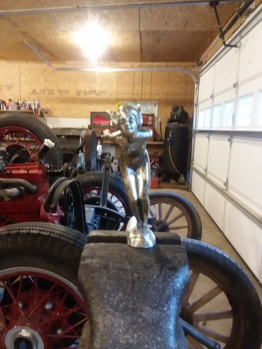

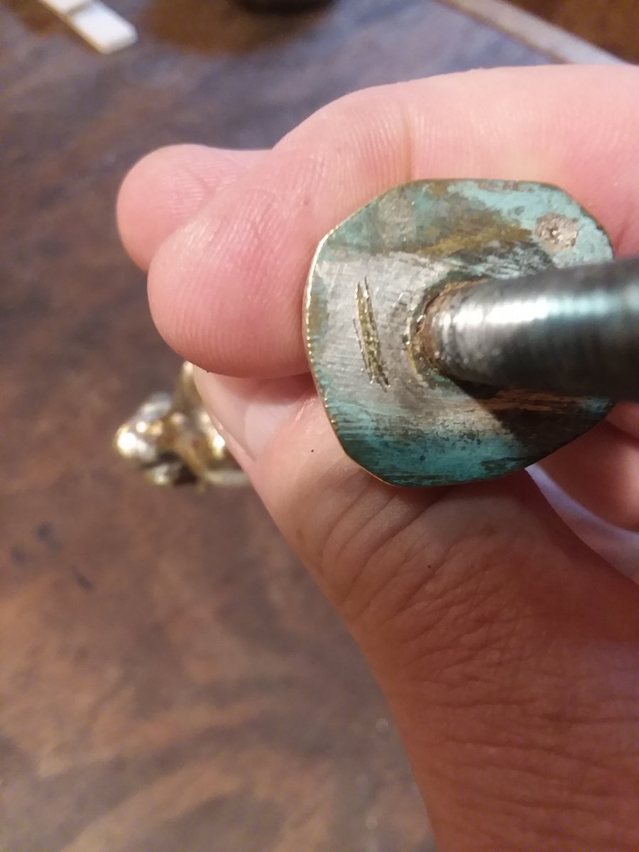

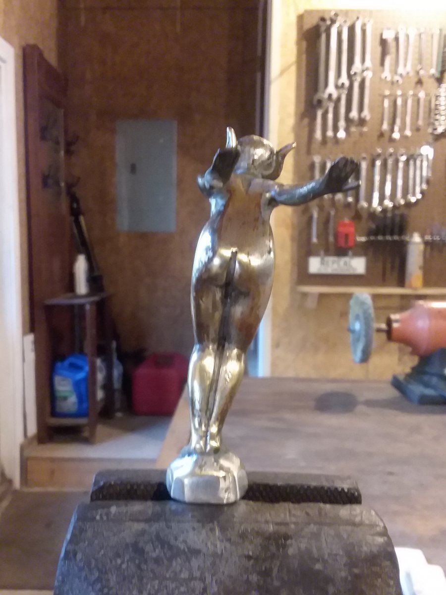

    20181004_181307.jpg 20181004_180718.jpg 20181004_180911.jpg 20181004_181307.jpg 20181004_180718.jpg 20181004_180911.jpg 20181004_181307.jpg 20181004_180718.jpg 20181004_180911.jpg 20181004_181307.jpg 20181004_180718.jpg 20181004_180911.jpg The speed nymph.
    I think the car she was on went on its side.
    It's non-magnetic, pretty sure it's brass.
    Would you heat it at the ankles or bend it straight cold?
    If heat, how much?
  4. Me too- but I’m a Danish square, don’t know, if that matters any?
    I’d heat, if brass or alu, with a heating gun, in a desperate attempt to keep the chrome... but I don’t know, if it ruins it.
    Keep ‘em kruzin!

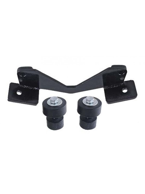

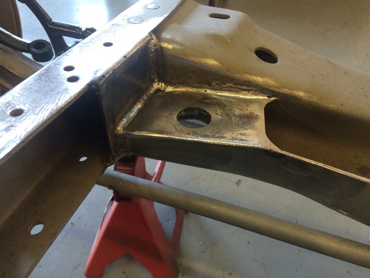

    I'm getting the frame for my '31 sandblasted tomorrow and have a question about the engine mount/front crossmsmber. I'll be using the Model A engine, but warmed up a bit to hopefully the 50-55 HP range. The stock front crossmember engine mount hole is rather wallowed out and rather than doing a repair to use the stock front mount I have considered a B or what I'll call a "cradle" style mount instead of the single spring-cushioned A mount. I found this mount on the Berts website, but I would likely build something similar since I enjoy the fabrication work.
    Then I found this photo in an older HAMB post by "badshifter". It shows the nice modification of the front crossmember to use a mount similar to the one from Berts.
    I plan to use the stock Model A mounts at the bellhousing with the rubber pads between the mount, frame and outer plate. For the transmission I'll be using a RTS-170 3-speed + overdrive with open driveshaft. I have no transmission crossmember/mount planned at this point.
    Does what I've described seem like a viable setup, or is some part of it riddled with flawed thinking and planning?
    If I stay with the stock A mount, is there any issue with just welding in a large "washer" patch on the top of the crossmember to bring the hole back to the stock size? The hole is now an oval-shaped 3/4"+ size, and I would make a patch from 10 Ga. steel to go over it. What should the size of the hole in the crossmember for the center bolt of a Model A motor-mount be if it isn't worn and enlarged?
    I'll say thanks in advance for input.
    Lynn

  15. Binger
    Joined: Apr 28, 2008
    Posts: 1,699
    Binger
    from wyoming
    I built a cradle style mount using a model a mount and some plate. I got the rubber cushions from Bert’s. I am running a float a motor mount style rear mount. I am running a T-5 with a closed drive shaft conversion. I chose to run a bolt out cross member under the transmission. My frame is not a stock A either but here are a couple of pictures from when I assembled or two years ago. There are lots more pics in my build thread. There is a link in my signature. Hope that helps. [​IMG][​IMG][​IMG]

  18. lake_harley
    Joined: Jun 4, 2017
    Posts: 1,181
    lake_harley
    Binger....Your engine/transmission mounts look great, and thanks for the reply and photos. In considering how to set up my A with the RTS-170 I searched a lot about the stock, almost solid A bellhousing mounts. Some on Fordbarn, and probably some here on the H.A.M.B. too, felt the stock A bellhousing mounts were structurally important on a stock A frame to provide somewhat a 4th crossmsmber. With your non-A and boxed frame that's probably not a consideration and with the float-a-motor rear mounts you have a fair amount of flexibility (good thing) even with front, mid, and transmission mounts.
    I'm concerned that if I did a cradle with rubber bushings on front, stock A mid-mounts and then added a transmission crossmember too I could get things too stiff and start cracking the bellhousing, transmission, etc. if/when the frame flexes. At the same time, I'm concerned that without support on the transmission tailshaft housing that I might have so much weight hanging off of the bellhousing that something could get over-stressed too. Kind of a damned if I do and damned if I don't dilemma! It's common, and it seems logical, that a 3-point engine/transmission mount is the most desirable, but I'm just not sure if 3-point or 4-point is the way to go in my situation. Going to the float-a-motor mid-mounts might be the best option for me too.
    Comments....suggestions?

  20. Binger
    Posts: 1,699
    Binger
    from wyoming
    I was concerned about the weight of the transmission too and that is why I decided to build that trans cross member. Plus there is no other cross members on the frame. I figured it needed one any way. I am not sure if it is necessary but I didn't want to run into trouble. I made it so it would unbolt and come out so its easy to work on. This cross member is solid and has no rubber mount on it. I imagine it is pretty stiff through that section. I haven't had any issues with cracking either on my mounts or on the flywheel housing. I built my rear mounts out of 3/16" plate like the front mount. I have heard many people like the Float a motor mounts as they smooth the car out by isolating the engine vibrations. It was easier for me to build them to work on the frame I built then use stock mounts.
