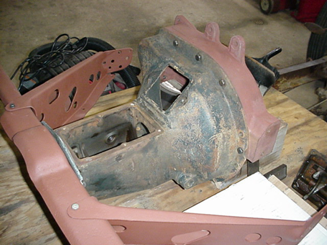

  14. I am not sure of a part number but you should be able to recognize a B case in that the starter is on the left side of the case. I put 40 gears in a B case and used the 39 top shifter. You will also need a B flywheel housing and some sort of lower flywheel cover since the B flywheel housing has none. I used a B rear part off a B oil pan. This will all bolt up to an A motor.
    Now if you do this you still need to find a way to mount your wishbone and pedals.

    Tiny, if you use a B case and bell housing you will have trouble mounting it in your A frame. The B mounts from the rear of the tranny to the K cross member, not from the flywheel housing. You will still need to get an adaptor for your pedals and wishbone. It may be best to use your tranny with the adaptor housing. See pictures in post 45.

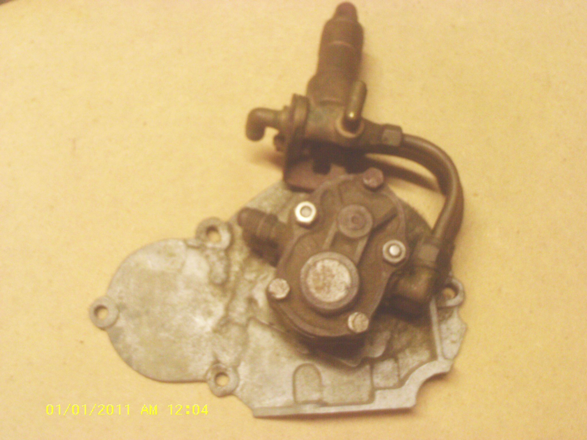

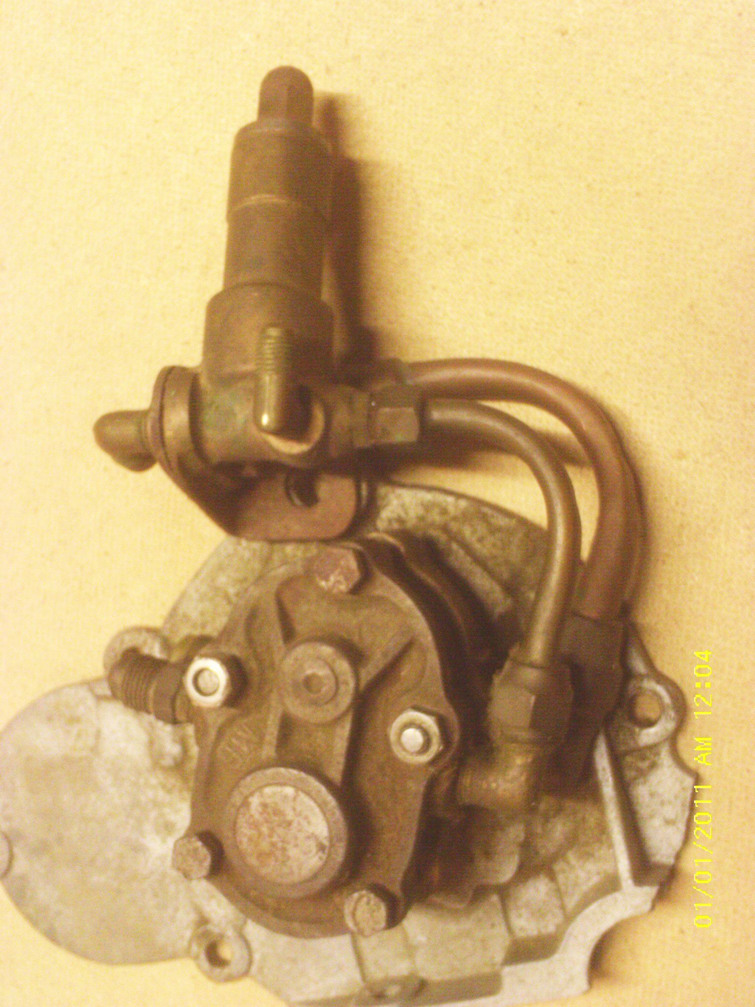

    My Hershey find for 2013, wonder what this T engine looked like. No name on the aluminum cover, any idea who made it? It's a pattern for a new casting some day. Bob
  20. Is that a cam driven oil pump?

  22. Too cool!!:)!! All the neat stuff you can find for T's makes me want to build a speedster of some sort.

    You can find them for A's too
  24. I've never seen one before. There seems to be serious tonage when it comes to cool "hop up" stuff for T's. Maybe its because they made so many of them or maybe its because so many fewer play with T's any more. Do you have an extra for an A Bluto?
