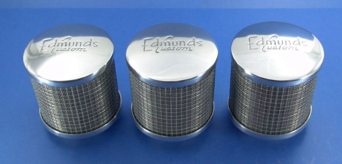

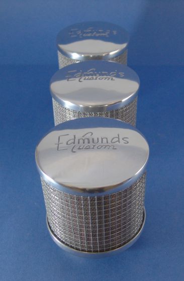

    I received my Obrien Truckers Edmunds air cleaners and they are nice looking but in my typical fashion I don't like the way they are put together and the screen the filters are wrapped with.
    They're wrapped with 2 layers of different screen and they are awkward to take apart and put back together which will happed when you want to clean the washable filters.
    So, I picked up some materials and will create something that will work much better. Details to follow :cool:
