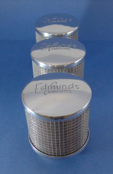

    What about the Edmunds repo’s. They’re cylindrical which I think have a more vintage look

    Without actually measuring them, it looks like the Edmunds filters have more square inches of filter surface, due to the taller profile. With some measurements it would be easy to figure. The Edmunds certainly look much better IMO.
    wackdaddy, Dino 64 and loudbang like this.

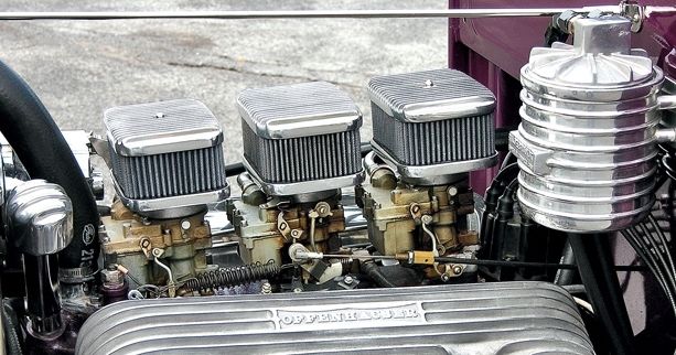

    For what it's worth, these match the style of the finned Offy valve covers:

    I thought they would match up with the finned design of my Edelbrock valve covers and the other finned cast aluminum features on my engine.
    So they’re not quite up to period perfect style but I need function.
    I think they would look good.

  17. I measured the square inches of exposed element surface three different cotton gauze elements that are used in my air cleaners (they all made in the USA by the way.)
    Here are the results:
    4" round 18.75 square inches
    4 1/2" round (Edmunds Custom) 34.875 square inches (with some restriction due to screen/wire)
    4 1/2" x 7" 35 square inches
  18. Norris McCarty
