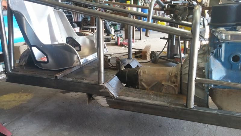

    Am I the only one who noticed how w i d e that seat is? Or the only one crude enough to mntion it?
    RoadRunner5 likes this.
  21. Old28
    Joined: Jan 11, 2009
    Posts: 1,390
    Old28
    Looks about the same as my funny car seat in my SDRA dragster, we big boys love them.:cool:
    Those seats are made for a driver with an SFI-20 suit on and for any one that has not the pleasure of driving in one, it is like having a sleeping bag rapped around you.:eek::rolleyes:;)

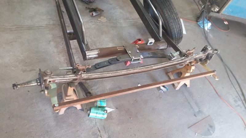

  22. It's a 18" Kirkey, I'm not exactly a small guy LOL.
  23. Here's a few more;

    looks like a real nice cage start. How wide is that shoulder rail inside? Is the chassis more or less the same as Mark & Mike dragsters? NW rules, are you going to run the 7" pie crust slicks? Your going to enjoy this ride!!!!!! :):eek::cool:
  25. Old28, I think the bars are 28-30" wide.I have a wide shoulder width.I went over to Marks to try sitting in his car I got in but my shoulders were rubbing the sides of the cage and they literally had to pull me out LOL. Yes mine will be similar to their chassis.Gotta start out on radials till I can afford to get some pie crusts.Headed over in the morning and will try to get some more pics.

    300racr -- Ya I have 24" in mine and it would be way better if it was 28-30" wide. You may want to look at installing a drop floor (foot well) about 5-6" below the normal floor area, it makes it a lot easier to get out. I am going to change mine this winter. Another thing that helps is having the front loop at a little less angle. Use big guys need a little more chassis design than normal. Give a shout to Mark & Mike from me.
  28. Went out to visit the guys this morning and took some more pics.
    Old28 with the dropped floor and a lil' longer cockpit than Marks car, it is very comfortable and I sit almost straight legged in the car.The main hoop around my shoulders is 28".
