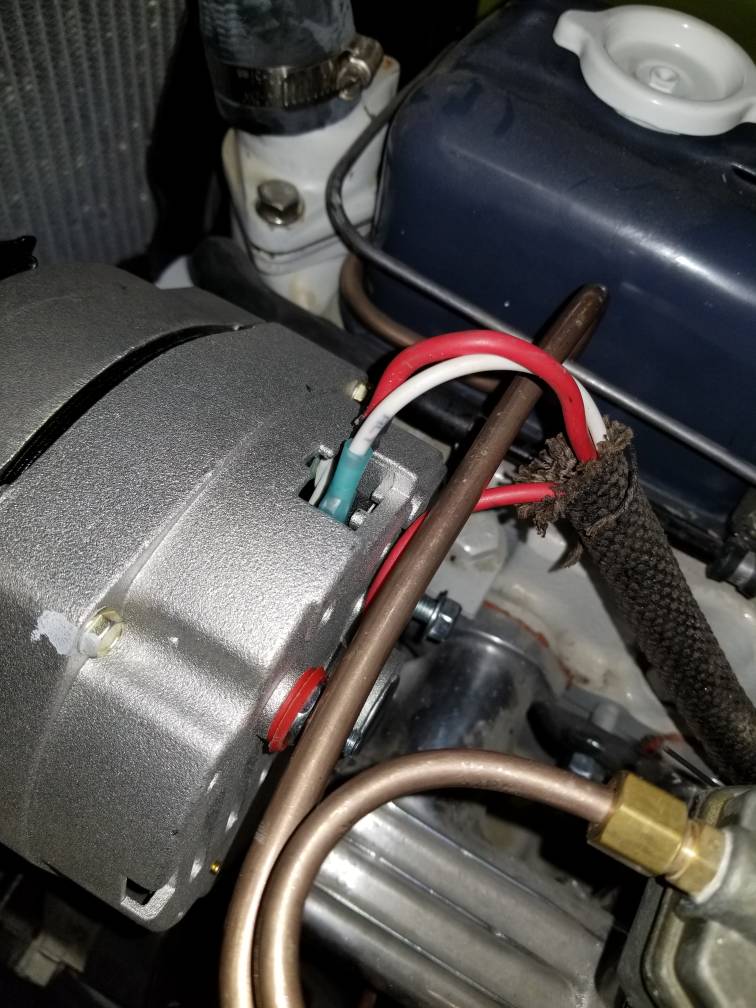

  18. Not much I can easily get picture of. I have the labelled main fuse panel power wire, + terminal battery wire, starter wire and main alternator wire hooked together via a bus bar because the terminal on the starter is too short. I have the exciter wire, main power and jumper on the alternator. The jumper wire is just a short wire from spade terminal to the main power feed. Exciter wire goes straight to fuse panel on the designated exciter wire. I have one wire coming off the BAT terminal on the ignition switch that is the dedicated IGN power wire. That is it. I have ground at the alternator. Main battery ground goes to engine block then chassis and body.
  19. Alternator is hooked up with the main power wire on the back. The exciter wire to the #1 terminal and the jumper from the #2 terminal to the main power wire. The battery is sitting on rubber in the battery tray. The run issue was solved by the original new alternator so I thought it was an internal alternator issue originally.

  23. The exciter wire runs through the fuse box. I have no idea what it does inside the fuse box but it has zero voltage unless the Acc wire is hooked to the switch and the switch is turned to the Acc or on position. It's hard to see but it may run through a 4 amp fuse as there is one on the fuse panel in about the area it looks like the exciter wire goes to(edit: I don't think this fuse has anything to do with the exciter wire.) I originally had the second wire on the top of the alternator running back to the bus bar (10G I believe)but every diagram I have seen online showed it jumped straight to the the main feedline so I made the little jumper. It has never gone to the fuse panel. Perhaps my explanation was not clear.
  24. The white wire is labelled excite and runs to the fuse panel. It has no power unless the switch is turned on. The red wire (on top) runs back to the main bus so unkeyed power. The main wire also runs to that bus. The bus currently has those two wires, main power positive battery and the starter hooked to it. I have a brown wire that runs from the fuse panel to the ACC pole on the ignition switch that is labeled as such. The white exciter wire and the brown acc wire seem to hooked to the same bus in the fuse panel but I cannot tell for sure as it is tough tot see it. Sorry I can't get any in focus pictures under the dash to show what is going on. 20200730_204312.jpeg
    I am pretty sure this is the bus inside the fuse panel with the Brown ACC wire and the white exciter wire. Nothing else seems to be attached to the other ends.

    Just an illusion, but on your photo of the alternator, the copper tube appears to be touching the Battery terminal. Probably just the angle.
