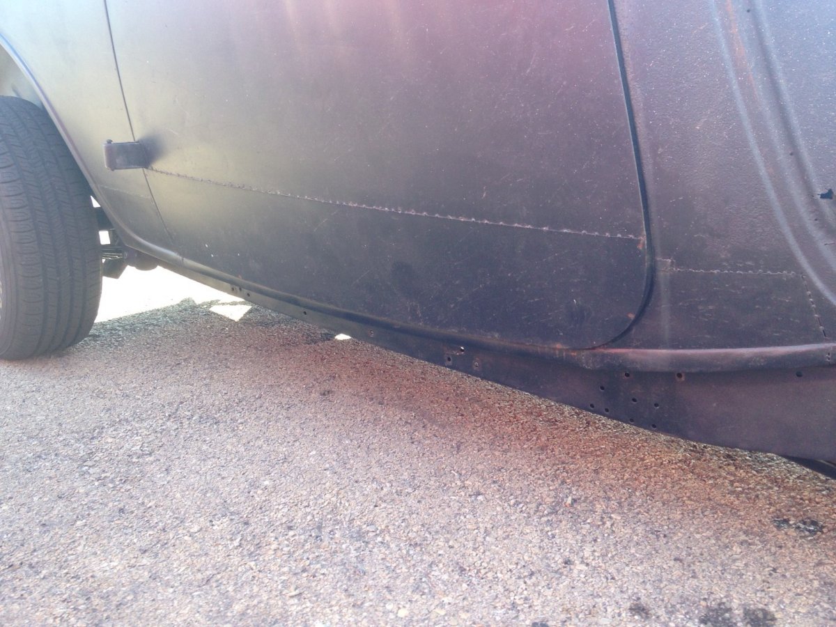

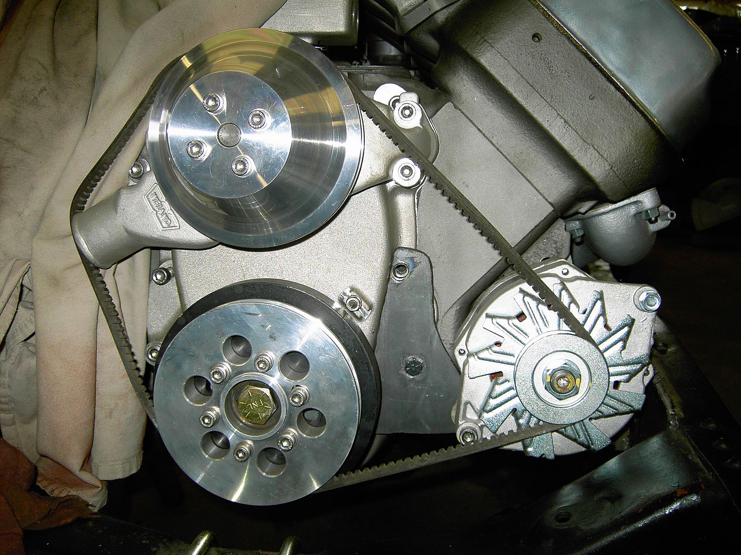

    well, I've been plugging away at her, got the drivers side inner and outer rockers installed,finally got the door alignment to where I'm happy with it, cowl and rear patch panel mocked in. I've got the back of the car lowered and I'm happy with her stance. Today we finally dug out the hood, radiator and grille and mocked them in. We needed to know how much room there was for the alternator. We have to fabricate a bracket to install the alternator.I don't have a crossover thermostat housing on my hemi motor and the hotheads alternator bracket (s) won't work, not enough room on the lower end of the motor.

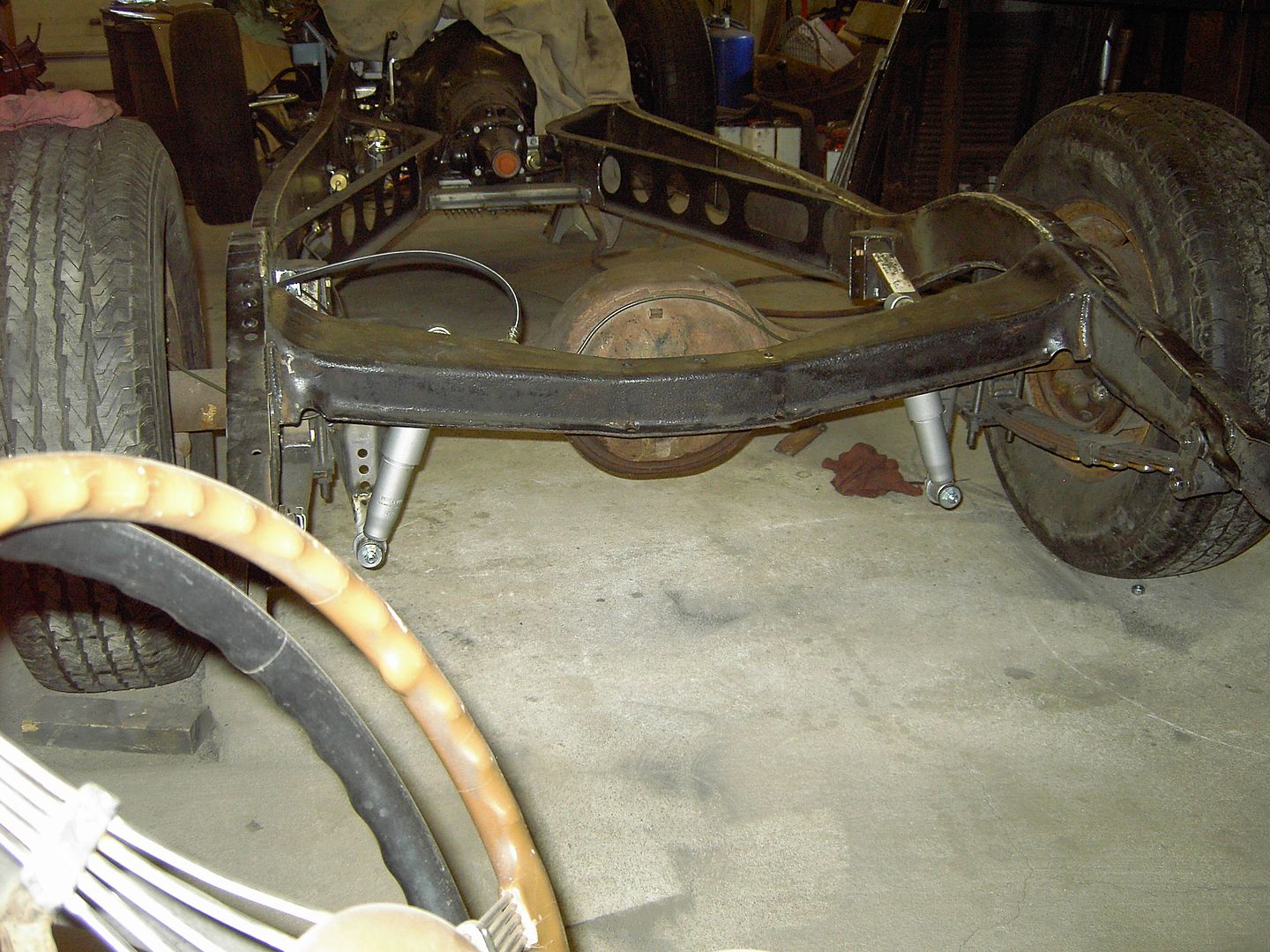

  10. Are the shocks hanging there, or are they mounted towards the center of the rear end?
  11. mounted towards center of rear end. I'll post a better pic.

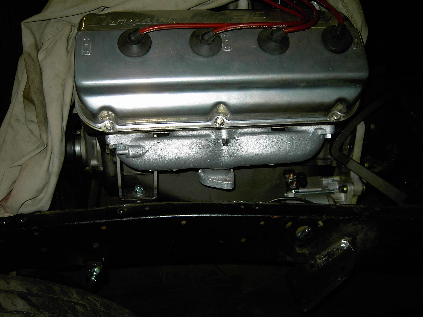

  12. well, I decided to use stock exhaust manifolds. With the drive shaft headers I initially planned on I would of had to cut up or eliminated the inner fenders and cut up the hood sides. In my opinion ,the inner fenders are so cool and the complete hood plus inner fenders make the car.Without both of them , the car looses most of its class \(uniqueness) .

    I would suggest revisiting the rear shocks, mounted like you have they will do nothing to help control body roll. With that cool power plant that little chassis will need all the help it can get. ;) upload_2017-4-1_19-34-7.png
  14. Thanks for the heads up JohnBoy34. I really appreciate it. One of the reasons I post my builds on the HAMB is to get constructive information like this. This will improve my build, its safety and the safety of others on the highway.

    Sedan is coming along great! My input on the brake line routing would be to rerun those lines, mounting them to the frame with rubber lined adel clamps and proper dog leg bends approaching the attachment points. Hard lines need support, unlike rubber/braided flex lines that can be ran straight from point A-B. Suspended out there in the breeze w/o any support, will eventually stress/crack the lines behind the fittings as the up/down suspension and gravity shocks the chassis.

    I have seen guys use a bracket similar to your frame engine mount, stood up on top of the cross member for a shock mount. To accommodate a longer shock. You've got a lot done in a short time, be proud!
  18. Thanks for the input Johnboy34. That's where I was headed with the question on the lower shock mounting, but I haven't been back on, to check the forum.

  20. you were right man, the body was setting on the brackets, so we did some cutting

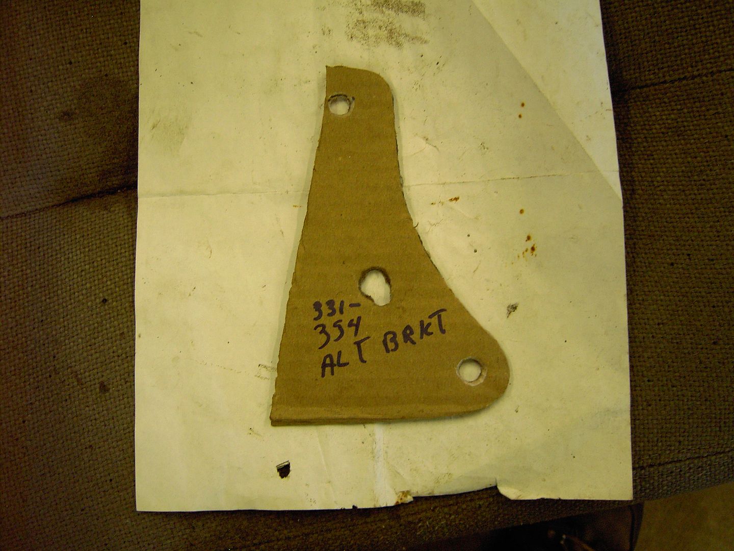

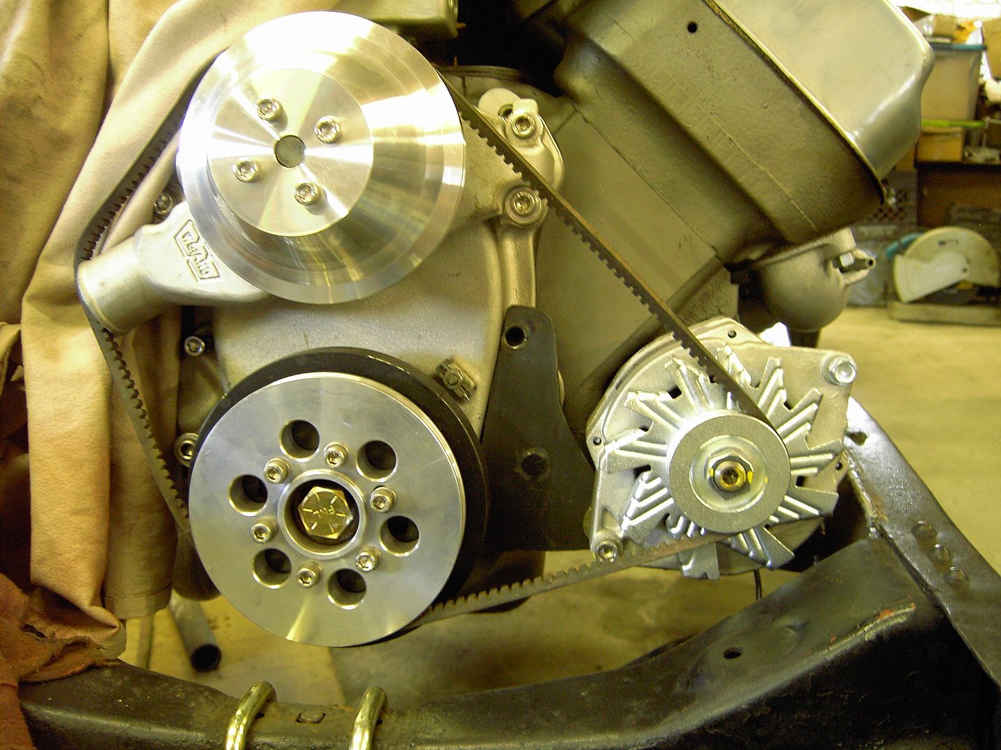

    well, have I told you I have smart friends, friends who can do anything with a marker, cardboard, sharp pair of scissors , plasma cutter and welder.

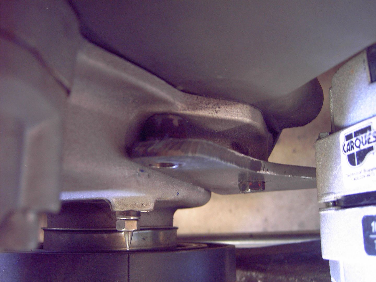

    my alternator bracket.....the top hole ,with no bolt , has a spacer behind it. It was made from a section of hollow steering shaft. The bottom of the alternator has washers so it can be shimmed if needed. The top hole of the alternator will have a 9" adjustment rod . That will be attached to the top water pump bolt. That's on order. The rod will put tension on the belt.
    I changed the rear shocks around, which now will stabilize the rear of the car. My problem is I can't follow directions especially when I'm standing on them.

    Looks good! Don't forget the shocks will move to the rear as the spring flattens out over bumps.

    I think what Johnboy34 is saying is that you might consider using a piece of more substantial tubing to space the top of the shocks a little further from the cross member. That way, when your springs flatten out and the rear end rotates towards the back of the car, it'll help keep the shocks from binding on the cross member.
    I also recommend that you weld a piece of thicker wall tubing for the upper shock mount and/or add a gusset to it. Maybe its the picture, but what you're using looks really small and thin at the top of those shocks. And even though the springs hold the weight of the rear, it looks like your upper shock mount is not substantial enough and could eventually break.

  27. thanks Dirk.... I'll just reinforce the upper shock bolts with some welding material. That will do the trick.

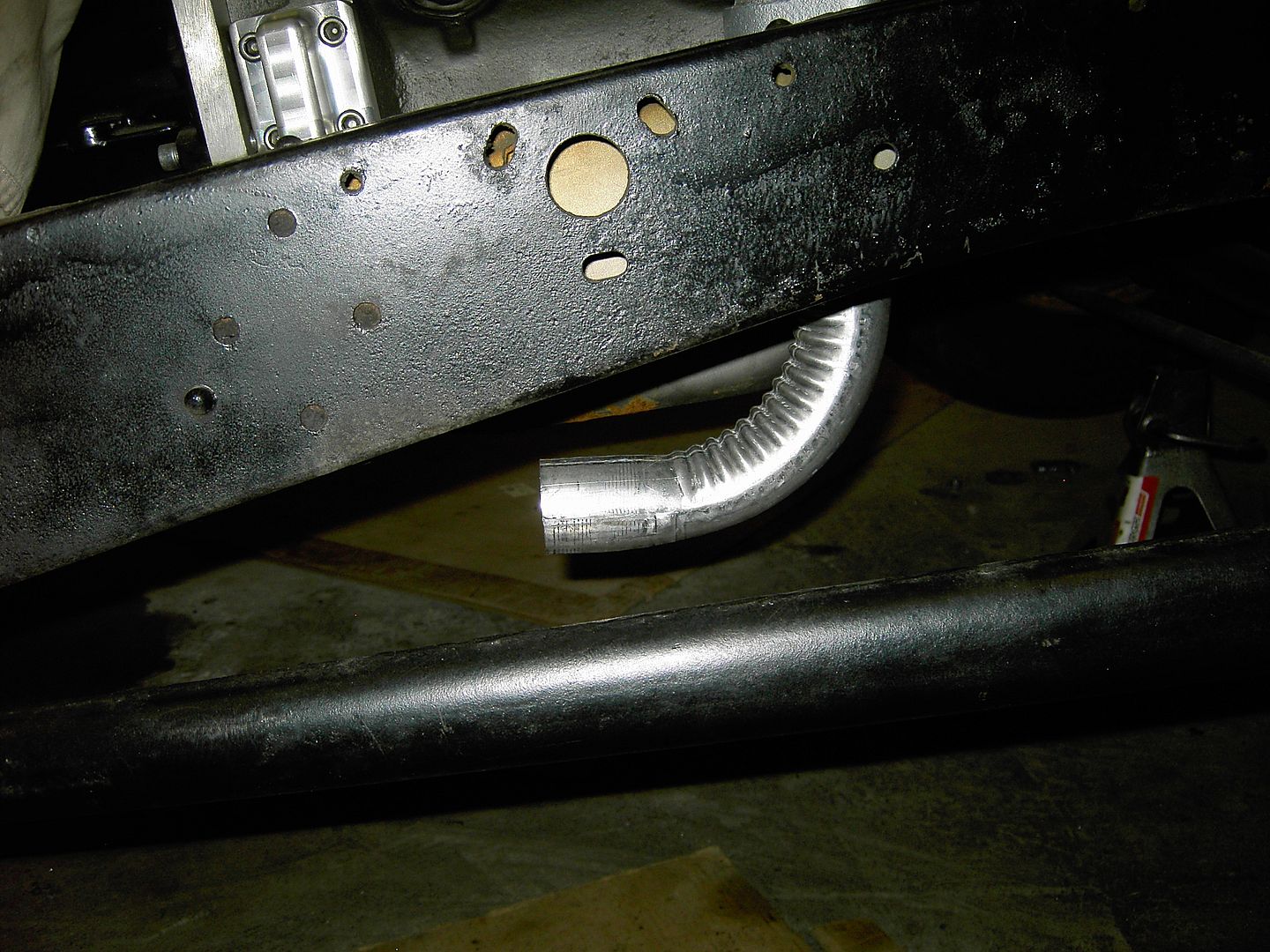

  28. some exhaust work.........
