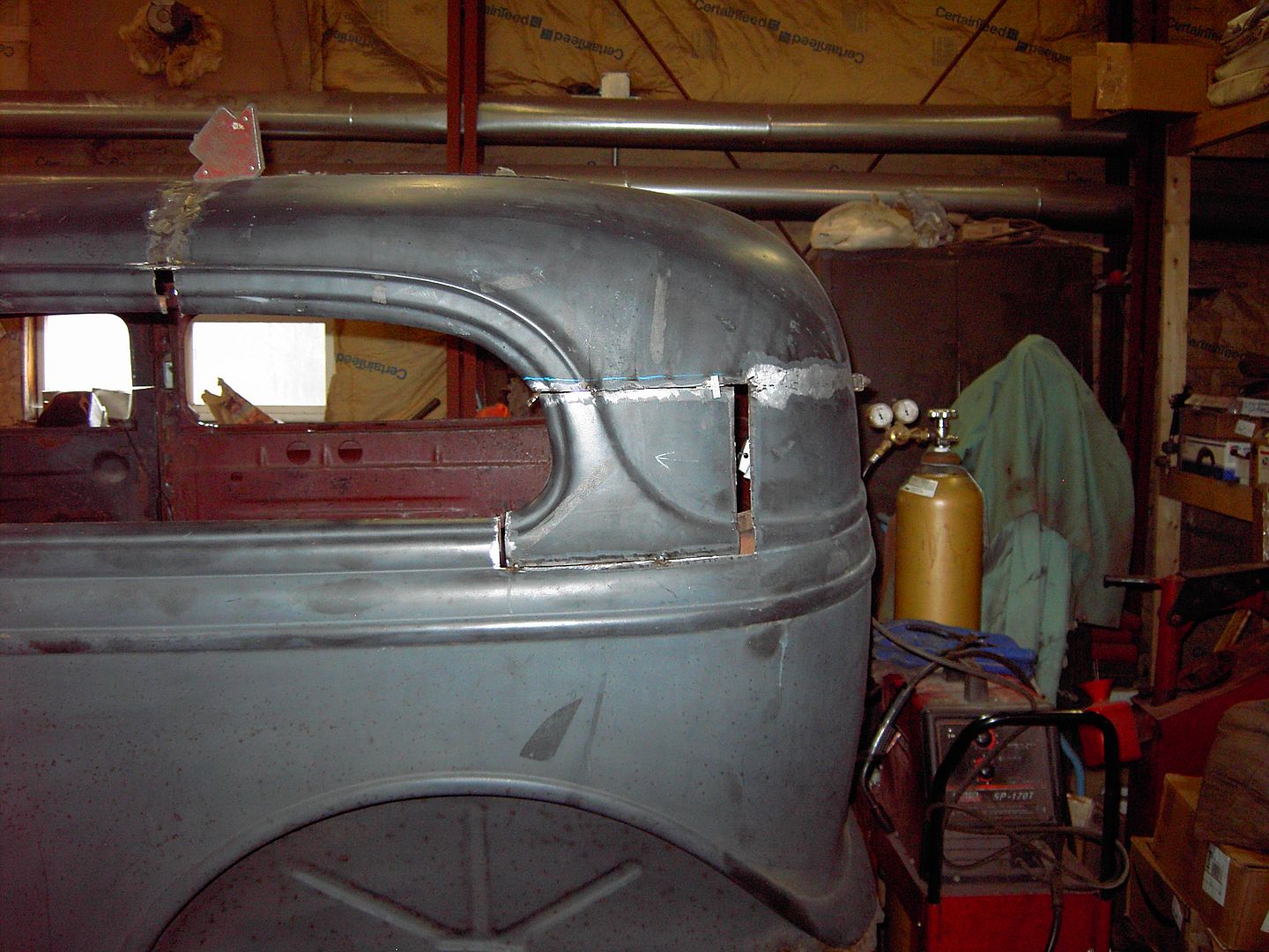

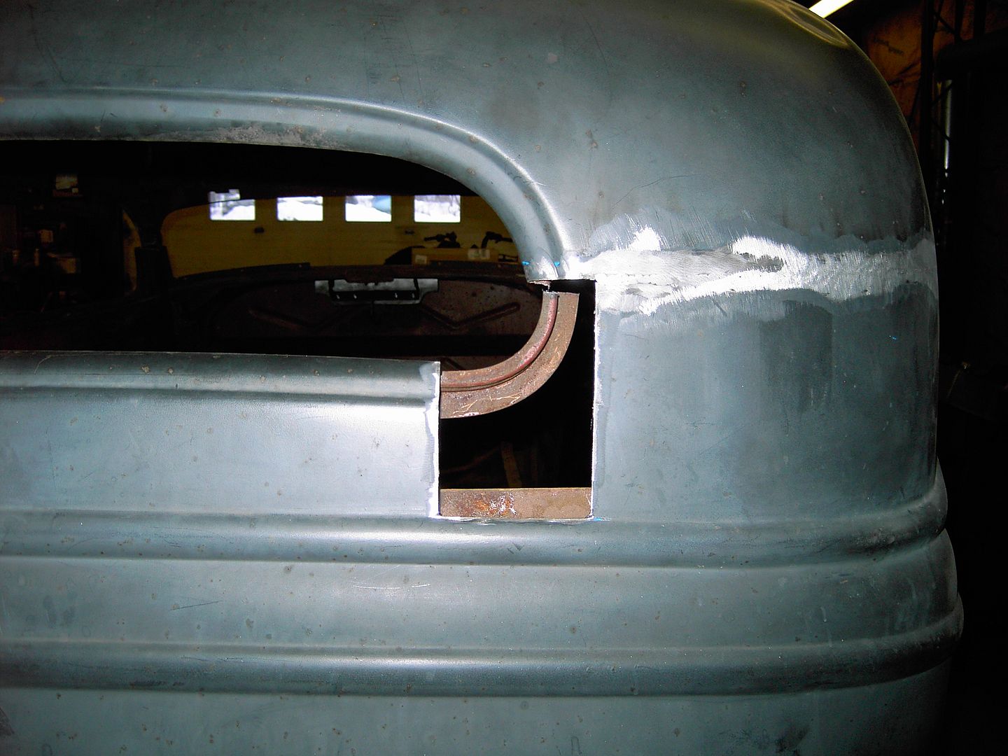

    I like it! I like the fact you are going to move the corners of the windows in to line them up rather than just bend them till they line up. Much cleaner look but more work too.
  2. thanks dumprat......I 'll take pics of the inside of the car behind the panel that I have to move. That will really show the work involved. But like you stated ,it's going to be a cleaner look.

    Really isn't any more work to "move " the corners than to try "bend " them to match . The result is much cleaner and better !! 2345 coupe we are waiting on an update . Bill

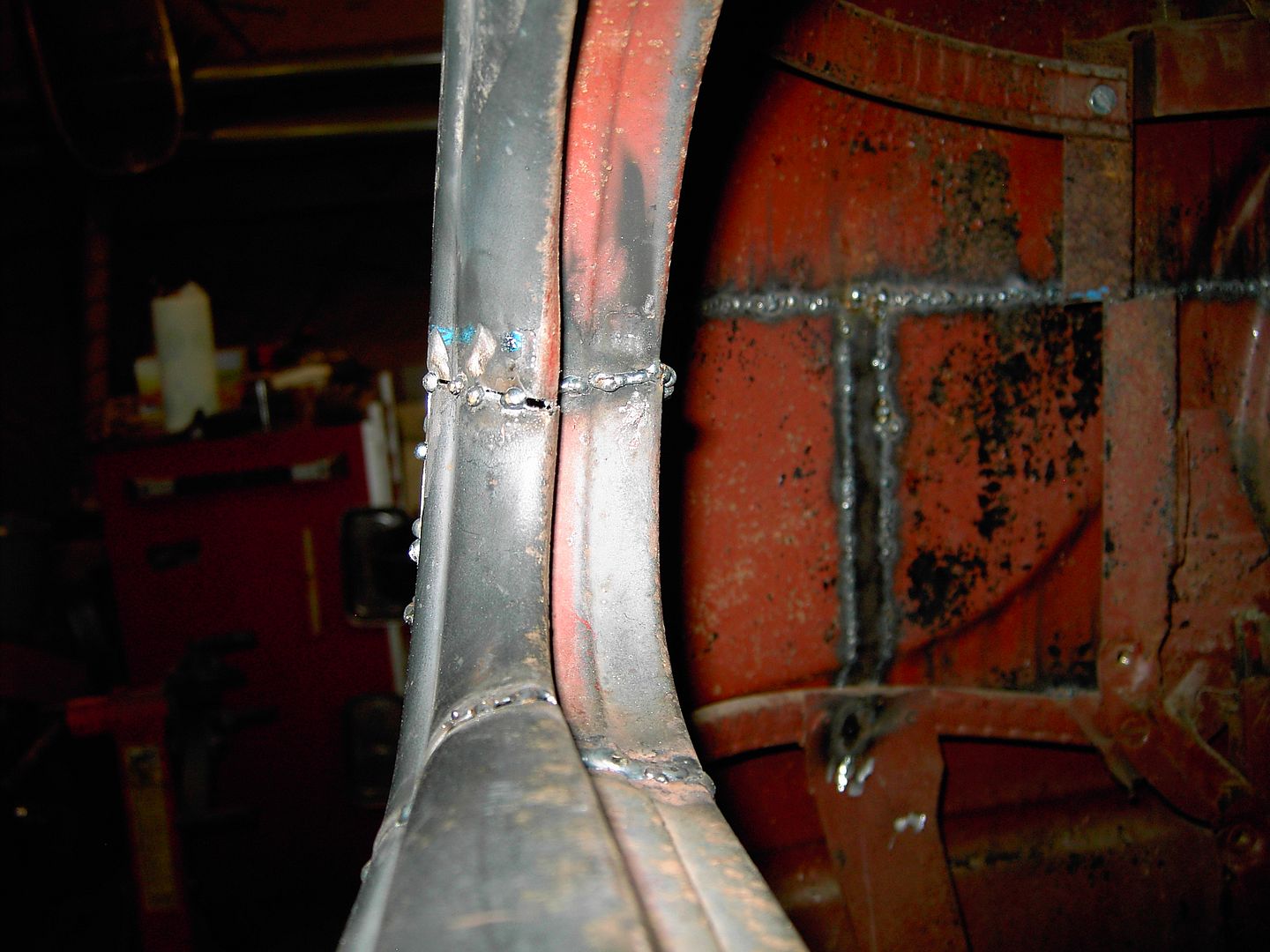

    so I had trouble lining up the two passenger side roof sections down from the A pillar. I had to cut the A pillar in two ,raise the pillar up and the the roof sections lined up. Then I just put a sand bag on top of the A pillar to flatten it down and re-welded it.
    The next challenge is to remove the material behind the rear section panel I have to move to line up the beauty lines.

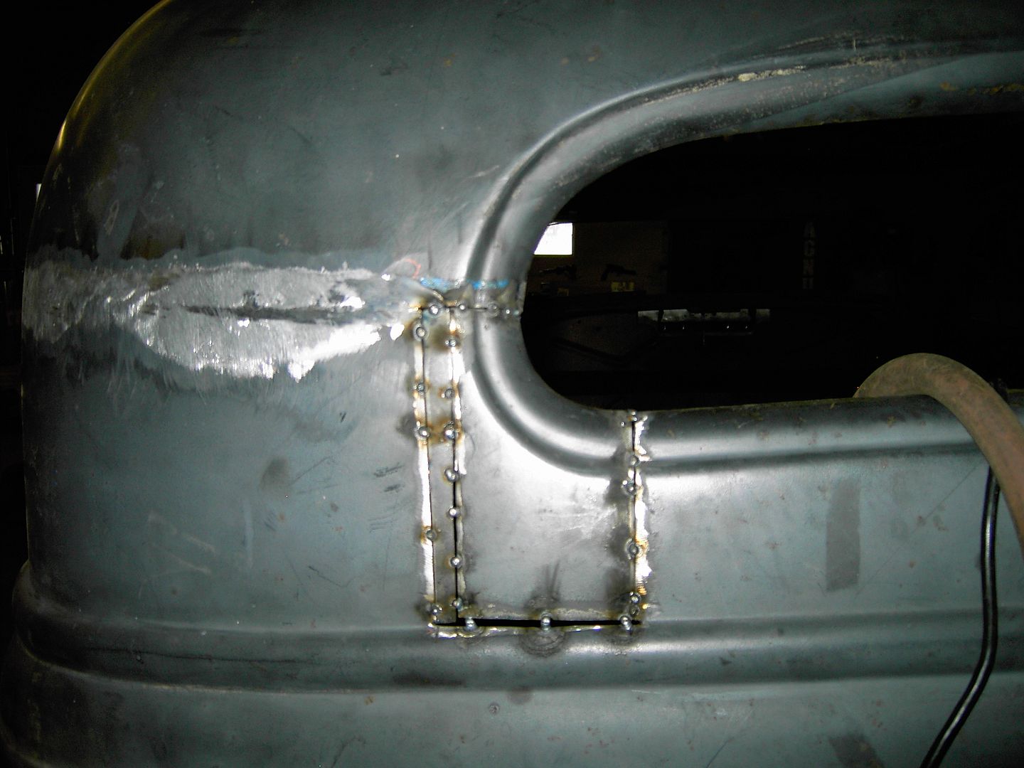

  9. well, I took the inner panel off that held my section I wanted to move. Then I cut the panel out, moved her over to matched up the molding (beauty) lines and tacked her in.
    Also please note I removed the "paint" around the patch to have cleaner welds.
    Oh and yes I'm not the worlds best when it comes to measuring..... but if your working with metal and you can weld, it's not a problem.

    Looking good !! I forgot how much fun and work this is . I would just work on one area at a time and soon you will be ready for the mud work. Bill

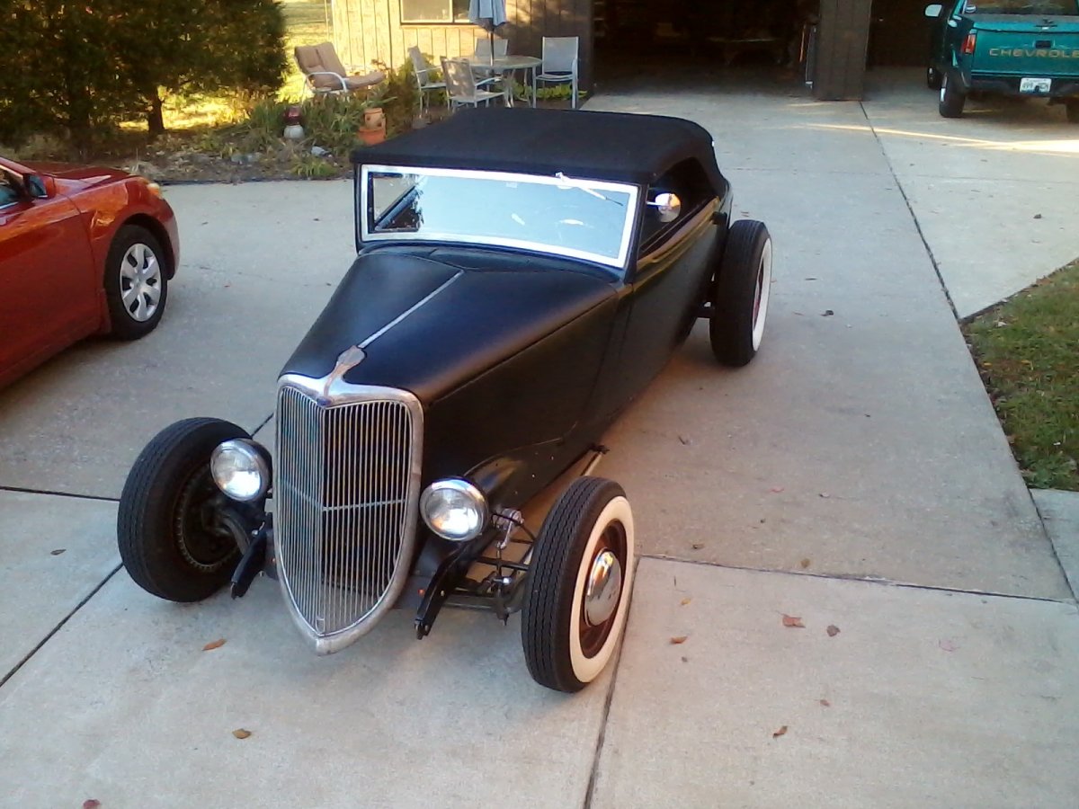

  13. Here's a current pic of my cabrio. Had it out for a while yesterday. By the time the snow melts up there you'll be almost done. 133.jpg
    BradinNC and kidcampbell71 like this.
  14. real nice roadster Tim........
  15. one section ready for lead....
    one section ready to cut.....
    greaser likes this.
  16. Man, that's looking great. Minimum of filler and lead you say. I can hardly wait to see that work happen. Great thread bud.

  18. this side gave me trouble......had to fight with it ......but i finally got it to where I'm satisfied with the results....

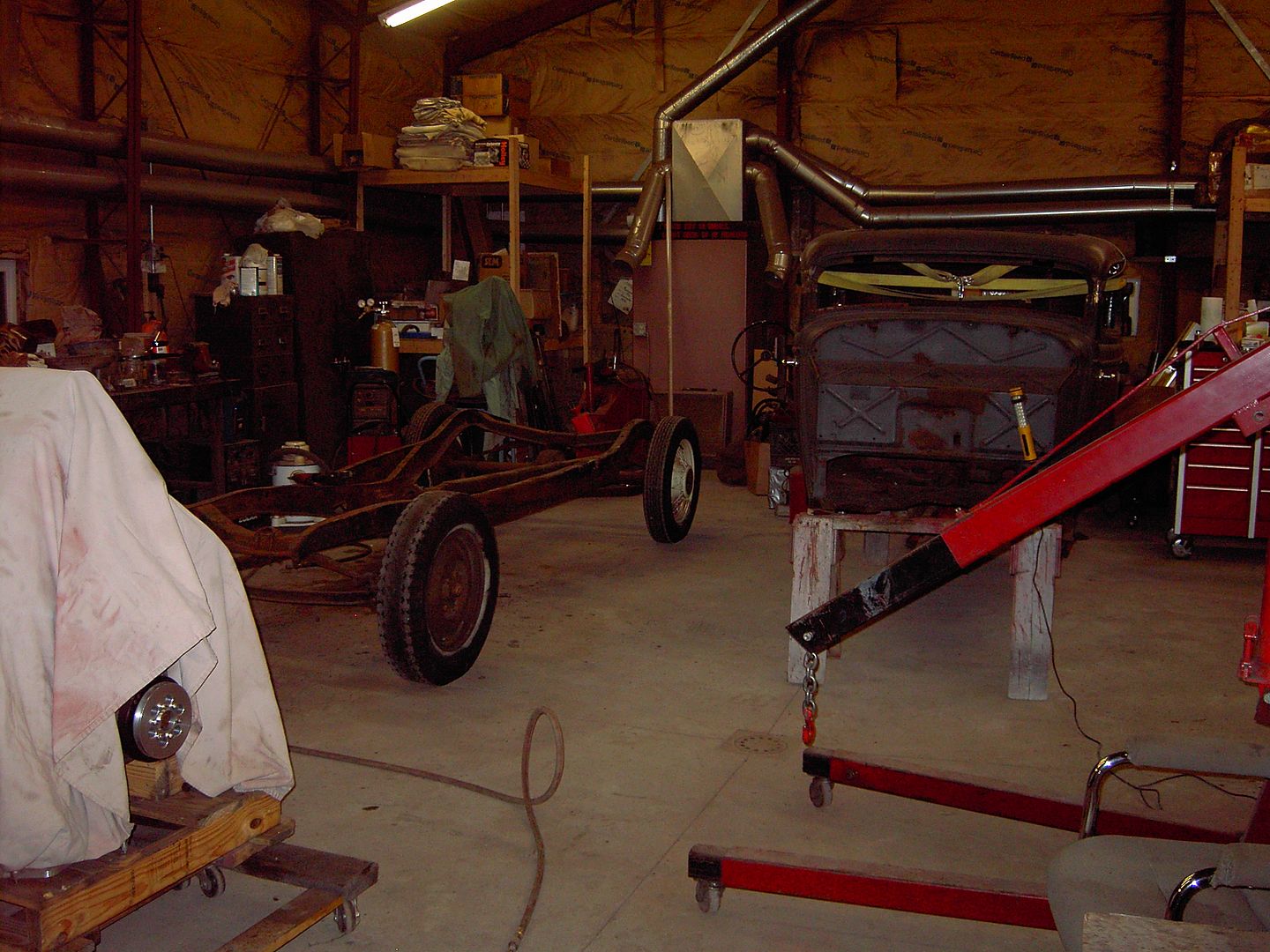

  24. well, I'm tired of working on the sheet metal. I'll get back to it later. Now it's time to get on the chassis.

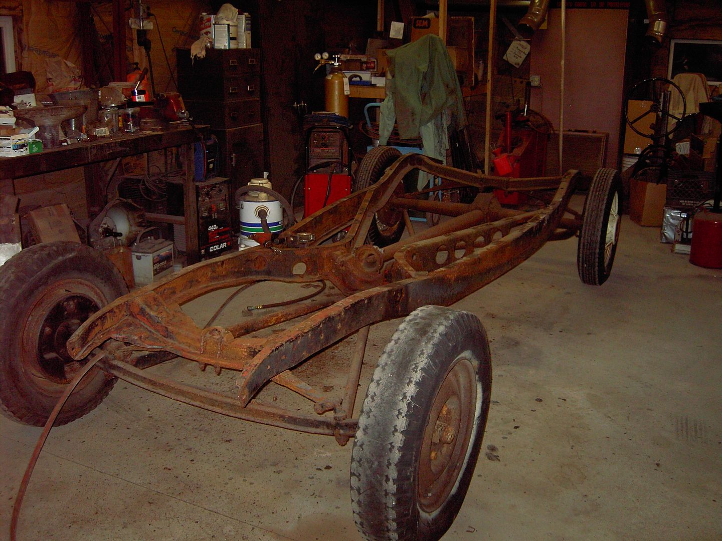

  25. greaser
    Joined: Apr 30, 2006
    Posts: 866
    greaser
    That frame looks to be in tip-top shape! We in New England haven't seen one like that in 30 years.
  26. yeah greaser,we got one now....... it is in great shape. I'm going to box her in, modify the X member ,add some parallel leaf rear leaf springs,ladder bars, pan hard bar ,4'' dropped axle,'42 spindles,f-1 front backing plates and juice brakes. And that's just for starters. Then the motor, trans and bronco rear..........then.........
    47ragtop and greaser like this.
  27. well, I had my fill of ozone depleting aerosols......now when the frame dries it will be ready for the boxing plates.
